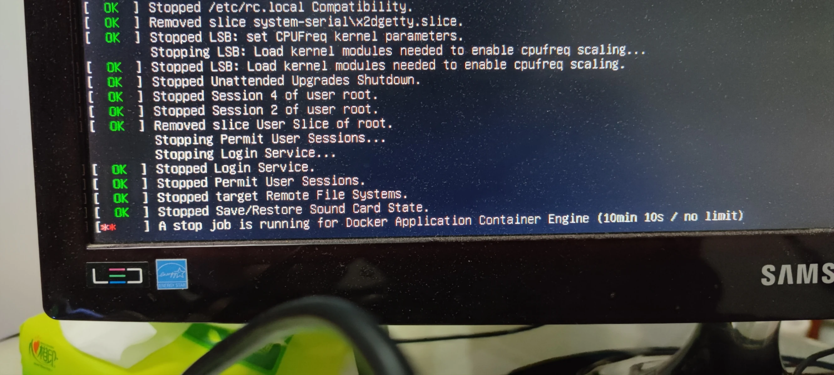

发表于 2021-1-23 16:58:33 | 显示全部楼层
E: Failed to fetch https://mirrors.aliyun.com/docke ... n-stretch_arm64.deb  404  Not Found
E: Unable to fetch some archives, maybe run apt-get update or try with --fix-missing?
这个怎么整
167
167
142
发表于 2021-1-23 17:48:19 | 显示全部楼层
除了这个以后我重启了,现在一直出这个页面,启动不起来
