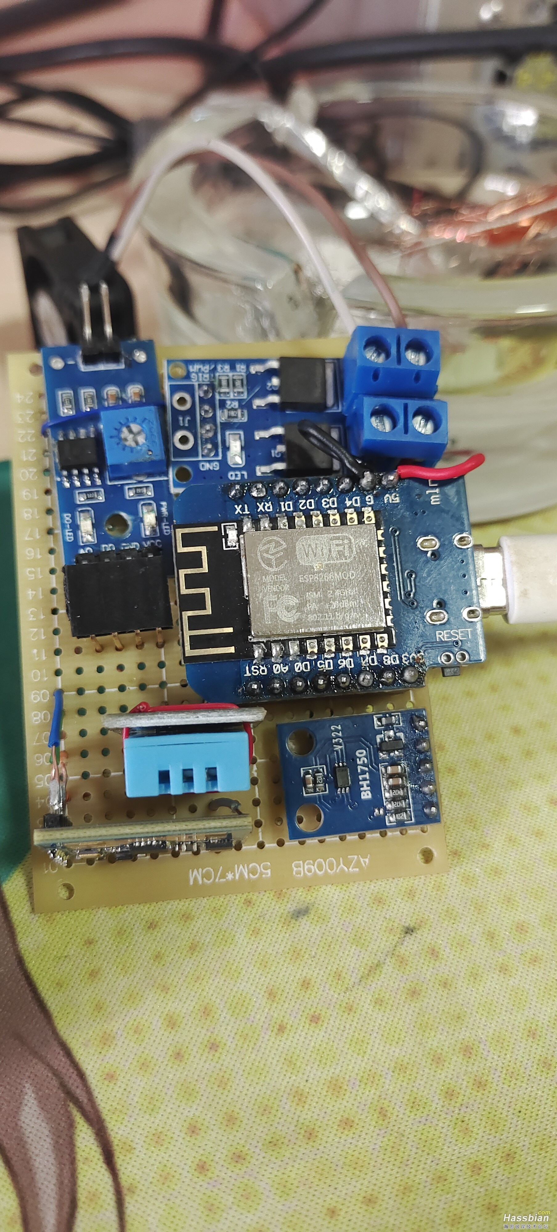

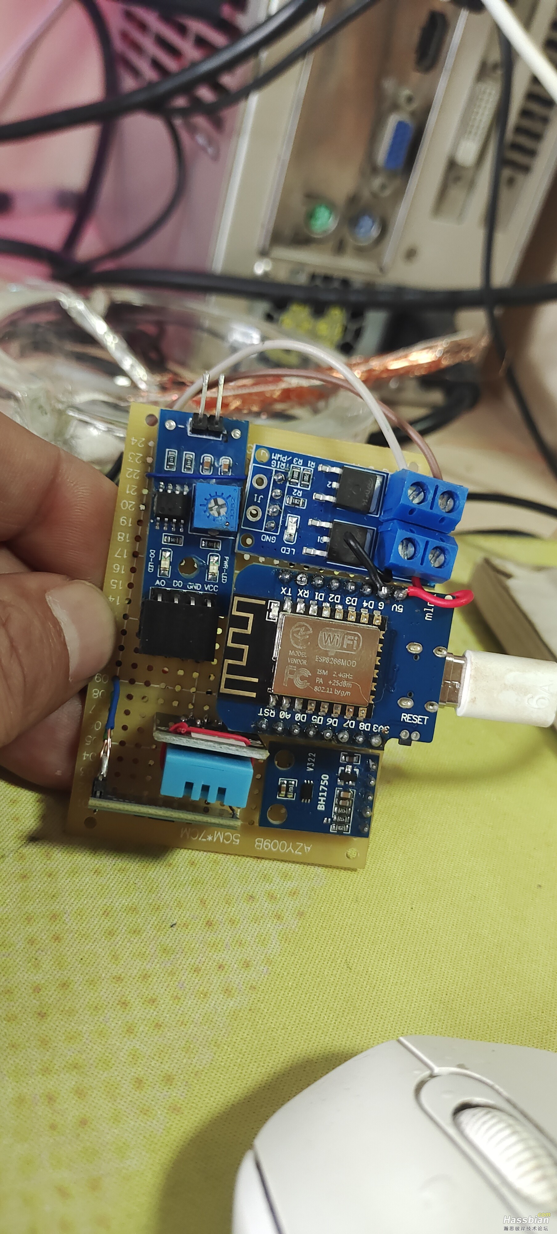

用esp8266 做个光线传感器 温湿度传感器 雨滴传感器在室外已经稳定运行一年有余,夏天重庆室外温度太高,偶尔8266死机重启,其它还好,还有就是雨滴传感器是属于耗材,一直也没管他,最近闲来无事,打算把这个传感小小升级一下。
在一起的基础上加了一个mos开关 可以控制一个5V的风扇 在夏天的时候可以给他散热,加了一个海凌科2401的人体存在传感器,3.99包邮到家,一下,感觉这个成本就下来。
2401传感器 3.99元,d1mini:8.45元 dht11:2.3元,bh1750:4元,mos单路控制器0.95元,雨滴传感器:1.59云,万能版:1.83元(2块)全部成本不到25元。
由于现在esphome 的问题 现在esp-c3 有兼容问题 编译有点问题,暂时还用esp8266的板子,毕竟便宜。

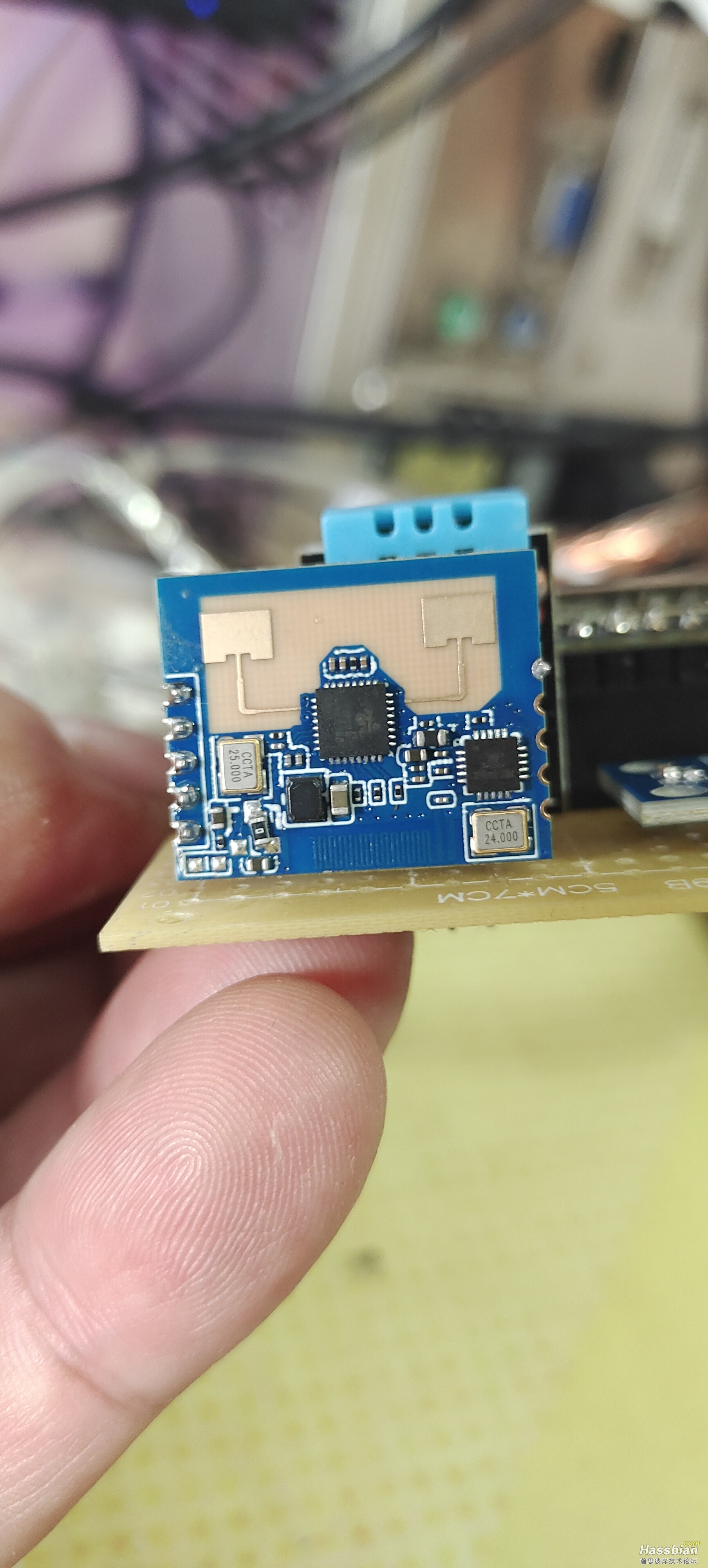

关键是现在海凌科2401的传感器太给力了,代码和2410可以通用,关机是价格一下就打下来了,4块钱包邮到家,差不多是2410的零头

substitutions:
  device_name: d1mini室外传感器
esphome:
  friendly_name: 室外光线,温湿度
  comment: 室外光线,温湿度
esp8266:
  board: d1_mini
# Enable logging
logger:
  baud_rate: 0
# Enable Home Assistant API
api:
  encryption:
    key: "838eYErKD************bDuogwLbErrSMeDc="
ota:
  - platform: esphome
    password: "5eb6***********cbd9db55acab"
wifi:
  ssid: "*****"
  password: "**********"
  ap:
    ssid: "Outside-Monitor"
    password: "88888888"
captive_portal:
web_server:
  port: 80
uart:
  tx_pin: GPIO1
  rx_pin: GPIO3
  baud_rate: 256000
  parity: NONE
  stop_bits: 1
ld2410:
  uart_id: ld2410_uart
output:
  - platform: esp8266_pwm
    pin: GPIO2
    frequency: 2000Hz
    inverted: True
light:
  - platform: monochromatic
    name: "LED On Board"
    output: led_onboard
binary_sensor:
  - platform: gpio
    pin:
      number: GPIO13
      mode: INPUT_PULLUP
  - platform: ld2410
    has_target:
    has_moving_target:
    has_still_target:
    out_pin_presence_status:
      name: out pin presence status
i2c:
  sda: GPIO4
  scl: GPIO5
  scan: true
sensor:
  - platform: bh1750
    i2c_id: bus_a
    name: "BH1750 Illuminance"
    address: 0x23
    update_interval: 30s
  - platform: dht
    pin: D5
    temperature:
      name: ${device_name} temperature
      filters:
        - filter_out: nan
        - heartbeat: 15s
        - sliding_window_moving_average:
            window_size: 2
            send_every: 2
            send_first_at: 1
        - lambda: return x * (9.0/5.0) + 32.0; # report temperature in Fahrenheit
      unit_of_measurement: "°F"
    humidity:
      filters:
        - filter_out: nan
        - heartbeat: 15s
            window_size: 2
            send_every: 2
            send_first_at: 1
      accuracy_decimals: 1 # humidity gets 0 decimals by default
    model: DHT11
  - platform: ld2410
    moving_distance:
    still_distance:
    moving_energy:
    still_energy:
    detection_distance:
    g0:
      move_energy:
        name: g0 move energy
      still_energy:
        name: g0 still energy
    g1:
      move_energy:
        name: g1 move energy
      still_energy:
        name: g1 still energy
    g2:
      move_energy:
        name: g2 move energy
      still_energy:
        name: g2 still energy
    g3:
      move_energy:
        name: g3 move energy
      still_energy:
        name: g3 still energy
    g4:
      move_energy:
        name: g4 move energy
      still_energy:
        name: g4 still energy
    g5:
      move_energy:
        name: g5 move energy
      still_energy:
        name: g5 still energy
    g6:
      move_energy:
        name: g6 move energy
      still_energy:
        name: g6 still energy
    g7:
      move_energy:
        name: g7 move energy
      still_energy:
        name: g7 still energy
    g8:
      move_energy:
        name: g8 move energy
      still_energy:
        name: g8 still energy
switch:
  - platform: restart
  - platform: gpio
    pin: D8
number:
  - platform: ld2410
    timeout:
    max_move_distance_gate:
      name: max move distance gate
    max_still_distance_gate:
      name: max still distance gate
    g0:
      move_threshold:
        name: g0 move threshold
      still_threshold:
        name: g0 still threshold
    g1:
      move_threshold:
        name: g1 move threshold
      still_threshold:
        name: g1 still threshold
    g2:
      move_threshold:
        name: g2 move threshold
      still_threshold:
        name: g2 still threshold
    g3:
      move_threshold:
        name: g3 move threshold
      still_threshold:
        name: g3 still threshold
    g4:
      move_threshold:
        name: g4 move threshold
      still_threshold:
        name: g4 still threshold
    g5:
      move_threshold:
        name: g5 move threshold
      still_threshold:
        name: g5 still threshold
    g6:
      move_threshold:
        name: g6 move threshold
      still_threshold:
        name: g6 still threshold
    g7:
      move_threshold:
        name: g7 move threshold
      still_threshold:
        name: g7 still threshold
    g8:
      move_threshold:
        name: g8 move threshold
      still_threshold:
        name: g8 still threshold
text_sensor:
  - platform: wifi_info
    ssid:
      icon: "mdi:signal-variant"
    ip_address:
      icon: "mdi:ip-network"
    mac_address:
      icon: "mdi:wifi-marker"
button:
  - platform: ld2410
    factory_reset:
    restart:
    query_params:
select:
  - platform: ld2410
    distance_resolution:
      name: "distance resolution"
    baud_rate:
    light_function:
    out_pin_level:
      name: out pin level

重要的事情说三遍!!!重要的事情说三遍!!!重要的事情说三遍!!!
海凌科2401 接3.3V电压!!海凌科2401 接3.3V电压!!海凌科2401 接3.3V电压!!
