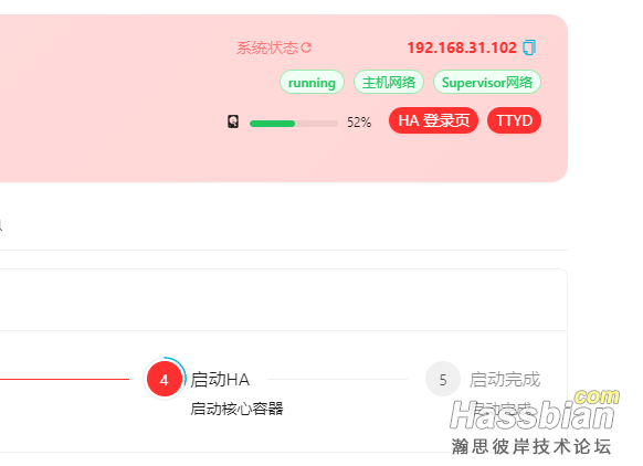

一直正常,昨天突然在HA登录页面转圈,就去伴侣页面重启了一下,就一直卡在启动中了,不知道咋办.

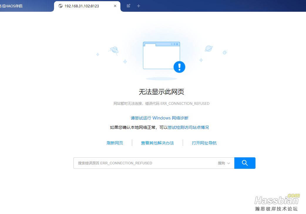

是不是因为有安装的自编译Addons应用,启动的时候需要等待Addons全部自检成功才会正常进入。
打开8124,进入 常规维护,找到 “修复Su故障启动-2”,打开看看是不是有,有的话,可以先移除,进去之后再手动安装回去。

尝试了, 最后还是会卡在启动核心容器.

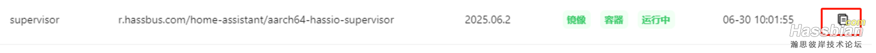

发表于 2025-6-30 14:58:53 | 显示全部楼层

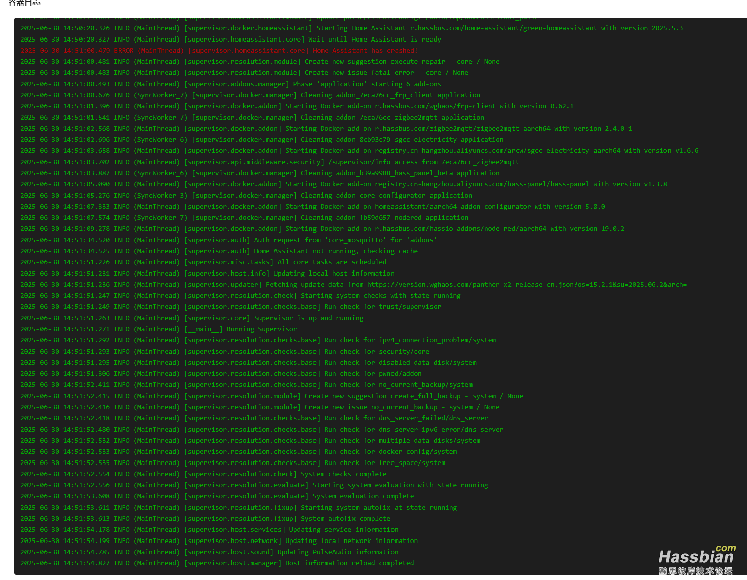

1751266686187.jpg 这个按钮点一下 截图发一下supervisor的日志

 楼主| 发表于 2025-6-30 15:05:07 | 显示全部楼层

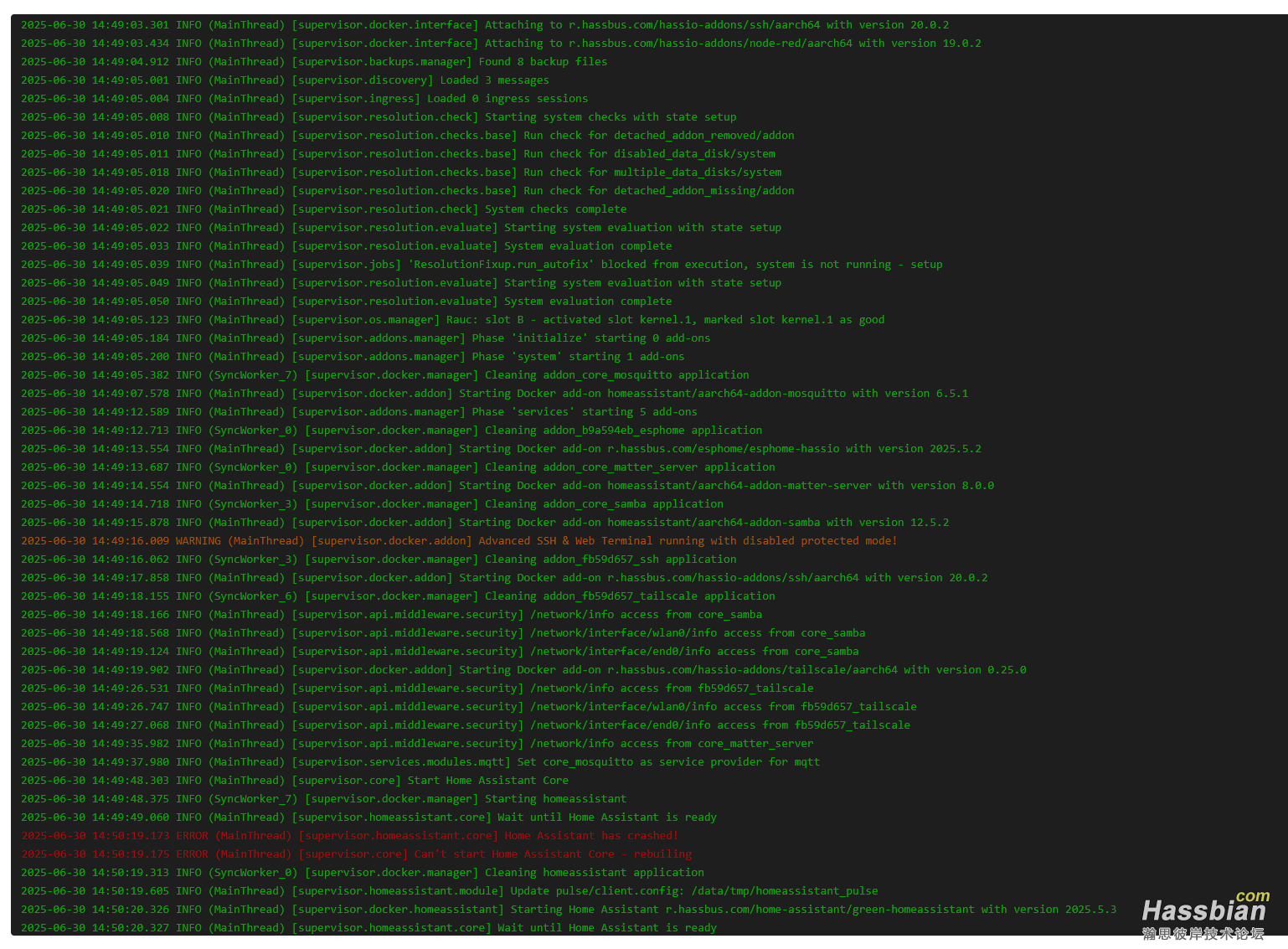

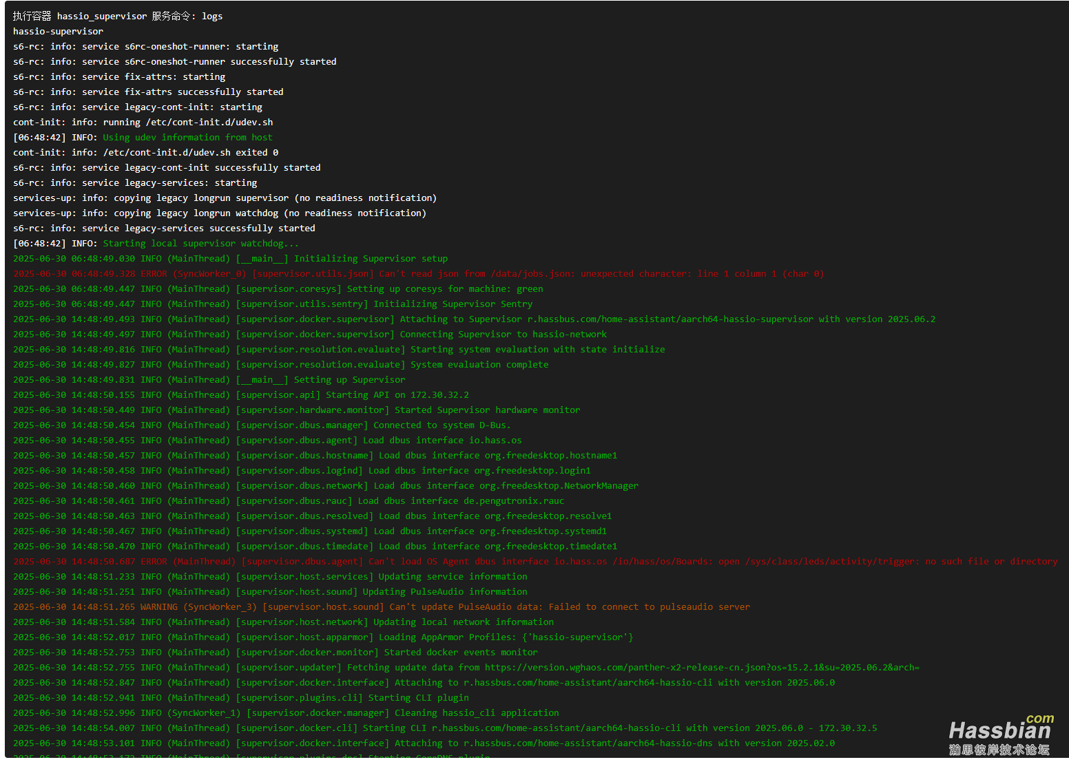

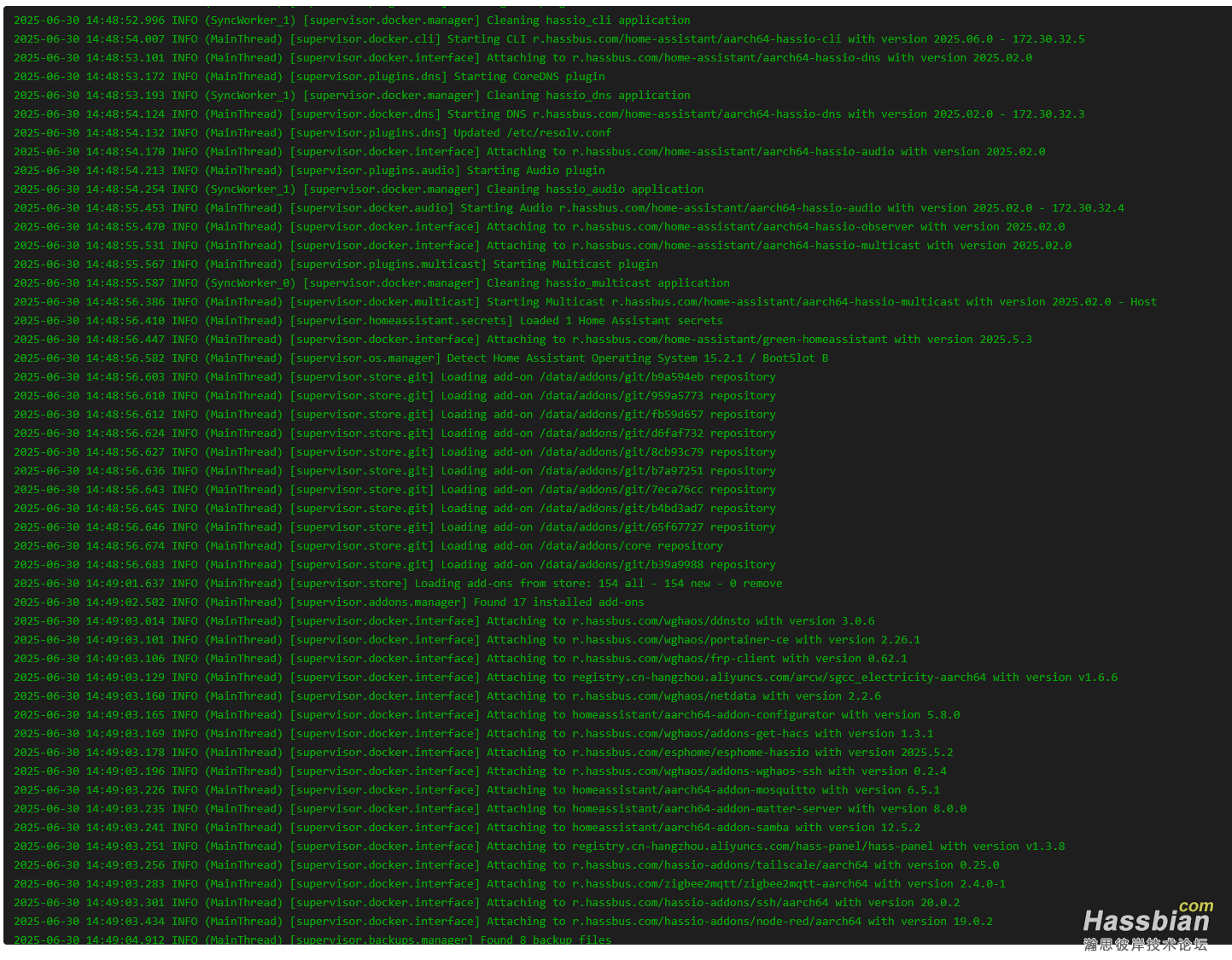

容器日志
执行容器 hassio_supervisor 服务命令: logs
hassio-supervisor
s6-rc: info: service s6rc-oneshot-runner: starting
s6-rc: info: service s6rc-oneshot-runner successfully started
s6-rc: info: service fix-attrs: starting
s6-rc: info: service fix-attrs successfully started
s6-rc: info: service legacy-cont-init: starting
cont-init: info: running /etc/cont-init.d/udev.sh
[06:48:42] INFO: Using udev information from host
cont-init: info: /etc/cont-init.d/udev.sh exited 0
s6-rc: info: service legacy-cont-init successfully started
s6-rc: info: service legacy-services: starting
services-up: info: copying legacy longrun supervisor (no readiness notification)
services-up: info: copying legacy longrun watchdog (no readiness notification)
s6-rc: info: service legacy-services successfully started
[06:48:42] INFO: Starting local supervisor watchdog...
2025-06-30 06:48:49.030 INFO (MainThread) [__main__] Initializing Supervisor setup
2025-06-30 06:48:49.328 ERROR (SyncWorker_0) [supervisor.utils.json] Can't read json from /data/jobs.json: unexpected character: line 1 column 1 (char 0)
2025-06-30 06:48:49.447 INFO (MainThread) [supervisor.coresys] Setting up coresys for machine: green
2025-06-30 06:48:49.447 INFO (MainThread) [supervisor.utils.sentry] Initializing Supervisor Sentry
2025-06-30 14:48:49.493 INFO (MainThread) [supervisor.docker.supervisor] Attaching to Supervisor r.hassbus.com/home-assistant/aarch64-hassio-supervisor with version 2025.06.2
2025-06-30 14:48:49.497 INFO (MainThread) [supervisor.docker.supervisor] Connecting Supervisor to hassio-network
2025-06-30 14:48:49.816 INFO (MainThread) [supervisor.resolution.evaluate] Starting system evaluation with state initialize
2025-06-30 14:48:49.827 INFO (MainThread) [supervisor.resolution.evaluate] System evaluation complete
2025-06-30 14:48:49.831 INFO (MainThread) [__main__] Setting up Supervisor
2025-06-30 14:48:50.155 INFO (MainThread) [supervisor.api] Starting API on 172.30.32.2
2025-06-30 14:48:50.449 INFO (MainThread) [supervisor.hardware.monitor] Started Supervisor hardware monitor
2025-06-30 14:48:50.454 INFO (MainThread) [supervisor.dbus.manager] Connected to system D-Bus.
2025-06-30 14:48:50.455 INFO (MainThread) [supervisor.dbus.agent] Load dbus interface io.hass.os
2025-06-30 14:48:50.457 INFO (MainThread) [supervisor.dbus.hostname] Load dbus interface org.freedesktop.hostname1
2025-06-30 14:48:50.458 INFO (MainThread) [supervisor.dbus.logind] Load dbus interface org.freedesktop.login1
2025-06-30 14:48:50.460 INFO (MainThread) [supervisor.dbus.network] Load dbus interface org.freedesktop.NetworkManager
2025-06-30 14:48:50.461 INFO (MainThread) [supervisor.dbus.rauc] Load dbus interface de.pengutronix.rauc
2025-06-30 14:48:50.463 INFO (MainThread) [supervisor.dbus.resolved] Load dbus interface org.freedesktop.resolve1
2025-06-30 14:48:50.467 INFO (MainThread) [supervisor.dbus.systemd] Load dbus interface org.freedesktop.systemd1
2025-06-30 14:48:50.470 INFO (MainThread) [supervisor.dbus.timedate] Load dbus interface org.freedesktop.timedate1
2025-06-30 14:48:50.687 ERROR (MainThread) [supervisor.dbus.agent] Can't load OS Agent dbus interface io.hass.os /io/hass/os/Boards: open /sys/class/leds/activity/trigger: no such file or directory
2025-06-30 14:48:51.233 INFO (MainThread) [supervisor.host.services] Updating service information
2025-06-30 14:48:51.251 INFO (MainThread) [supervisor.host.sound] Updating PulseAudio information
2025-06-30 14:48:51.265 WARNING (SyncWorker_3) [supervisor.host.sound] Can't update PulseAudio data: Failed to connect to pulseaudio server
2025-06-30 14:48:51.584 INFO (MainThread) [supervisor.host.network] Updating local network information
2025-06-30 14:48:52.017 INFO (MainThread) [supervisor.host.apparmor] Loading AppArmor Profiles: {'hassio-supervisor'}
2025-06-30 14:48:52.753 INFO (MainThread) [supervisor.docker.monitor] Started docker events monitor
2025-06-30 14:48:52.755 INFO (MainThread) [supervisor.updater] Fetching update data from https://version.wghaos.com/panth ... 2025.06.2&arch=
2025-06-30 14:48:52.847 INFO (MainThread) [supervisor.docker.interface] Attaching to r.hassbus.com/home-assistant/aarch64-hassio-cli with version 2025.06.0
2025-06-30 14:48:52.941 INFO (MainThread) [supervisor.plugins.cli] Starting CLI plugin
2025-06-30 14:48:52.996 INFO (SyncWorker_1) [supervisor.docker.manager] Cleaning hassio_cli application
2025-06-30 14:48:54.007 INFO (MainThread) [supervisor.docker.cli] Starting CLI r.hassbus.com/home-assistant/aarch64-hassio-cli with version 2025.06.0 - 172.30.32.5
2025-06-30 14:48:53.101 INFO (MainThread) [supervisor.docker.interface] Attaching to r.hassbus.com/home-assistant/aarch64-hassio-dns with version 2025.02.0
2025-06-30 14:48:53.172 INFO (MainThread) [supervisor.plugins.dns] Starting CoreDNS plugin
2025-06-30 14:48:53.193 INFO (SyncWorker_1) [supervisor.docker.manager] Cleaning hassio_dns application
2025-06-30 14:48:54.124 INFO (MainThread) [supervisor.docker.dns] Starting DNS r.hassbus.com/home-assistant/aarch64-hassio-dns with version 2025.02.0 - 172.30.32.3
2025-06-30 14:48:54.132 INFO (MainThread) [supervisor.plugins.dns] Updated /etc/resolv.conf
2025-06-30 14:48:54.170 INFO (MainThread) [supervisor.docker.interface] Attaching to r.hassbus.com/home-assistant/aarch64-hassio-audio with version 2025.02.0
2025-06-30 14:48:54.213 INFO (MainThread) [supervisor.plugins.audio] Starting Audio plugin
2025-06-30 14:48:54.254 INFO (SyncWorker_1) [supervisor.docker.manager] Cleaning hassio_audio application
2025-06-30 14:48:55.453 INFO (MainThread) [supervisor.docker.audio] Starting Audio r.hassbus.com/home-assistant/aarch64-hassio-audio with version 2025.02.0 - 172.30.32.4
2025-06-30 14:48:55.470 INFO (MainThread) [supervisor.docker.interface] Attaching to r.hassbus.com/home-assistant/aarch64-hassio-observer with version 2025.02.0
2025-06-30 14:48:55.531 INFO (MainThread) [supervisor.docker.interface] Attaching to r.hassbus.com/home-assistant/aarch64-hassio-multicast with version 2025.02.0
2025-06-30 14:48:55.567 INFO (MainThread) [supervisor.plugins.multicast] Starting Multicast plugin
2025-06-30 14:48:55.587 INFO (SyncWorker_0) [supervisor.docker.manager] Cleaning hassio_multicast application
2025-06-30 14:48:56.386 INFO (MainThread) [supervisor.docker.multicast] Starting Multicast r.hassbus.com/home-assistant/aarch64-hassio-multicast with version 2025.02.0 - Host
2025-06-30 14:48:56.410 INFO (MainThread) [supervisor.homeassistant.secrets] Loaded 1 Home Assistant secrets
2025-06-30 14:48:56.447 INFO (MainThread) [supervisor.docker.interface] Attaching to r.hassbus.com/home-assistant/green-homeassistant with version 2025.5.3
2025-06-30 14:48:56.582 INFO (MainThread) [supervisor.os.manager] Detect Home Assistant Operating System 15.2.1 / BootSlot B
2025-06-30 14:48:56.603 INFO (MainThread) [supervisor.store.git] Loading add-on /data/addons/git/b9a594eb repository
2025-06-30 14:48:56.610 INFO (MainThread) [supervisor.store.git] Loading add-on /data/addons/git/959a5773 repository
2025-06-30 14:48:56.612 INFO (MainThread) [supervisor.store.git] Loading add-on /data/addons/git/fb59d657 repository
2025-06-30 14:48:56.624 INFO (MainThread) [supervisor.store.git] Loading add-on /data/addons/git/d6faf732 repository
2025-06-30 14:48:56.627 INFO (MainThread) [supervisor.store.git] Loading add-on /data/addons/git/8cb93c79 repository
2025-06-30 14:48:56.636 INFO (MainThread) [supervisor.store.git] Loading add-on /data/addons/git/b7a97251 repository
2025-06-30 14:48:56.643 INFO (MainThread) [supervisor.store.git] Loading add-on /data/addons/git/7eca76cc repository
2025-06-30 14:48:56.645 INFO (MainThread) [supervisor.store.git] Loading add-on /data/addons/git/b4bd3ad7 repository
2025-06-30 14:48:56.646 INFO (MainThread) [supervisor.store.git] Loading add-on /data/addons/git/65f67727 repository
2025-06-30 14:48:56.674 INFO (MainThread) [supervisor.store.git] Loading add-on /data/addons/core repository
2025-06-30 14:48:56.683 INFO (MainThread) [supervisor.store.git] Loading add-on /data/addons/git/b39a9988 repository
2025-06-30 14:49:01.637 INFO (MainThread) [supervisor.store] Loading add-ons from store: 154 all - 154 new - 0 remove
2025-06-30 14:49:02.502 INFO (MainThread) [supervisor.addons.manager] Found 17 installed add-ons
2025-06-30 14:49:03.014 INFO (MainThread) [supervisor.docker.interface] Attaching to r.hassbus.com/wghaos/ddnsto with version 3.0.6
2025-06-30 14:49:03.101 INFO (MainThread) [supervisor.docker.interface] Attaching to r.hassbus.com/wghaos/portainer-ce with version 2.26.1
2025-06-30 14:49:03.106 INFO (MainThread) [supervisor.docker.interface] Attaching to r.hassbus.com/wghaos/frp-client with version 0.62.1
2025-06-30 14:49:03.129 INFO (MainThread) [supervisor.docker.interface] Attaching to registry.cn-hangzhou.aliyuncs.com/arcw/sgcc_electricity-aarch64 with version v1.6.6
2025-06-30 14:49:03.160 INFO (MainThread) [supervisor.docker.interface] Attaching to r.hassbus.com/wghaos/netdata with version 2.2.6
2025-06-30 14:49:03.165 INFO (MainThread) [supervisor.docker.interface] Attaching to homeassistant/aarch64-addon-configurator with version 5.8.0
2025-06-30 14:49:03.169 INFO (MainThread) [supervisor.docker.interface] Attaching to r.hassbus.com/wghaos/addons-get-hacs with version 1.3.1
2025-06-30 14:49:03.178 INFO (MainThread) [supervisor.docker.interface] Attaching to r.hassbus.com/esphome/esphome-hassio with version 2025.5.2
2025-06-30 14:49:03.196 INFO (MainThread) [supervisor.docker.interface] Attaching to r.hassbus.com/wghaos/addons-wghaos-ssh with version 0.2.4
2025-06-30 14:49:03.226 INFO (MainThread) [supervisor.docker.interface] Attaching to homeassistant/aarch64-addon-mosquitto with version 6.5.1
2025-06-30 14:49:03.235 INFO (MainThread) [supervisor.docker.interface] Attaching to homeassistant/aarch64-addon-matter-server with version 8.0.0
2025-06-30 14:49:03.241 INFO (MainThread) [supervisor.docker.interface] Attaching to homeassistant/aarch64-addon-samba with version 12.5.2
2025-06-30 14:49:03.251 INFO (MainThread) [supervisor.docker.interface] Attaching to registry.cn-hangzhou.aliyuncs.com/hass-panel/hass-panel with version v1.3.8
2025-06-30 14:49:03.256 INFO (MainThread) [supervisor.docker.interface] Attaching to r.hassbus.com/hassio-addons/tailscale/aarch64 with version 0.25.0
2025-06-30 14:49:03.283 INFO (MainThread) [supervisor.docker.interface] Attaching to r.hassbus.com/zigbee2mqtt/zigbee2mqtt-aarch64 with version 2.4.0-1
2025-06-30 14:49:03.301 INFO (MainThread) [supervisor.docker.interface] Attaching to r.hassbus.com/hassio-addons/ssh/aarch64 with version 20.0.2
2025-06-30 14:49:03.434 INFO (MainThread) [supervisor.docker.interface] Attaching to r.hassbus.com/hassio-addons/node-red/aarch64 with version 19.0.2
2025-06-30 14:49:04.912 INFO (MainThread) [supervisor.backups.manager] Found 8 backup files
2025-06-30 14:49:05.001 INFO (MainThread) [supervisor.discovery] Loaded 3 messages
2025-06-30 14:49:05.004 INFO (MainThread) [supervisor.ingress] Loaded 0 ingress sessions
2025-06-30 14:49:05.008 INFO (MainThread) [supervisor.resolution.check] Starting system checks with state setup
2025-06-30 14:49:05.010 INFO (MainThread) [supervisor.resolution.checks.base] Run check for detached_addon_removed/addon
2025-06-30 14:49:05.011 INFO (MainThread) [supervisor.resolution.checks.base] Run check for disabled_data_disk/system
2025-06-30 14:49:05.018 INFO (MainThread) [supervisor.resolution.checks.base] Run check for multiple_data_disks/system
2025-06-30 14:49:05.020 INFO (MainThread) [supervisor.resolution.checks.base] Run check for detached_addon_missing/addon
2025-06-30 14:49:05.021 INFO (MainThread) [supervisor.resolution.check] System checks complete
2025-06-30 14:49:05.022 INFO (MainThread) [supervisor.resolution.evaluate] Starting system evaluation with state setup
2025-06-30 14:49:05.033 INFO (MainThread) [supervisor.resolution.evaluate] System evaluation complete
2025-06-30 14:49:05.039 INFO (MainThread) [supervisor.jobs] 'ResolutionFixup.run_autofix' blocked from execution, system is not running - setup
2025-06-30 14:49:05.049 INFO (MainThread) [supervisor.resolution.evaluate] Starting system evaluation with state setup
2025-06-30 14:49:05.050 INFO (MainThread) [supervisor.resolution.evaluate] System evaluation complete
2025-06-30 14:49:05.123 INFO (MainThread) [supervisor.os.manager] Rauc: slot B - activated slot kernel.1, marked slot kernel.1 as good
2025-06-30 14:49:05.184 INFO (MainThread) [supervisor.addons.manager] Phase 'initialize' starting 0 add-ons
2025-06-30 14:49:05.200 INFO (MainThread) [supervisor.addons.manager] Phase 'system' starting 1 add-ons
2025-06-30 14:49:05.382 INFO (SyncWorker_7) [supervisor.docker.manager] Cleaning addon_core_mosquitto application
2025-06-30 14:49:07.578 INFO (MainThread) [supervisor.docker.addon] Starting Docker add-on homeassistant/aarch64-addon-mosquitto with version 6.5.1
2025-06-30 14:49:12.589 INFO (MainThread) [supervisor.addons.manager] Phase 'services' starting 5 add-ons
2025-06-30 14:49:12.713 INFO (SyncWorker_0) [supervisor.docker.manager] Cleaning addon_b9a594eb_esphome application
2025-06-30 14:49:13.554 INFO (MainThread) [supervisor.docker.addon] Starting Docker add-on r.hassbus.com/esphome/esphome-hassio with version 2025.5.2
2025-06-30 14:49:13.687 INFO (SyncWorker_0) [supervisor.docker.manager] Cleaning addon_core_matter_server application
2025-06-30 14:49:14.554 INFO (MainThread) [supervisor.docker.addon] Starting Docker add-on homeassistant/aarch64-addon-matter-server with version 8.0.0
2025-06-30 14:49:14.718 INFO (SyncWorker_3) [supervisor.docker.manager] Cleaning addon_core_samba application
2025-06-30 14:49:15.878 INFO (MainThread) [supervisor.docker.addon] Starting Docker add-on homeassistant/aarch64-addon-samba with version 12.5.2
2025-06-30 14:49:16.009 WARNING (MainThread) [supervisor.docker.addon] Advanced SSH & Web Terminal running with disabled protected mode!
2025-06-30 14:49:16.062 INFO (SyncWorker_3) [supervisor.docker.manager] Cleaning addon_fb59d657_ssh application
2025-06-30 14:49:17.858 INFO (MainThread) [supervisor.docker.addon] Starting Docker add-on r.hassbus.com/hassio-addons/ssh/aarch64 with version 20.0.2
2025-06-30 14:49:18.155 INFO (SyncWorker_6) [supervisor.docker.manager] Cleaning addon_fb59d657_tailscale application
2025-06-30 14:49:18.166 INFO (MainThread) [supervisor.api.middleware.security] /network/info access from core_samba
2025-06-30 14:49:18.568 INFO (MainThread) [supervisor.api.middleware.security] /network/interface/wlan0/info access from core_samba
2025-06-30 14:49:19.124 INFO (MainThread) [supervisor.api.middleware.security] /network/interface/end0/info access from core_samba
2025-06-30 14:49:19.902 INFO (MainThread) [supervisor.docker.addon] Starting Docker add-on r.hassbus.com/hassio-addons/tailscale/aarch64 with version 0.25.0
2025-06-30 14:49:26.531 INFO (MainThread) [supervisor.api.middleware.security] /network/info access from fb59d657_tailscale
2025-06-30 14:49:26.747 INFO (MainThread) [supervisor.api.middleware.security] /network/interface/wlan0/info access from fb59d657_tailscale
2025-06-30 14:49:27.068 INFO (MainThread) [supervisor.api.middleware.security] /network/interface/end0/info access from fb59d657_tailscale
2025-06-30 14:49:35.982 INFO (MainThread) [supervisor.api.middleware.security] /network/info access from core_matter_server
2025-06-30 14:49:37.980 INFO (MainThread) [supervisor.services.modules.mqtt] Set core_mosquitto as service provider for mqtt
2025-06-30 14:49:48.303 INFO (MainThread) [supervisor.core] Start Home Assistant Core
2025-06-30 14:49:48.375 INFO (SyncWorker_7) [supervisor.docker.manager] Starting homeassistant
2025-06-30 14:49:49.060 INFO (MainThread) [supervisor.homeassistant.core] Wait until Home Assistant is ready
2025-06-30 14:50:19.173 ERROR (MainThread) [supervisor.homeassistant.core] Home Assistant has crashed!
2025-06-30 14:50:19.175 ERROR (MainThread) [supervisor.core] Can't start Home Assistant Core - rebuiling
2025-06-30 14:50:19.313 INFO (SyncWorker_0) [supervisor.docker.manager] Cleaning homeassistant application
2025-06-30 14:50:19.605 INFO (MainThread) [supervisor.homeassistant.module] Update pulse/client.config: /data/tmp/homeassistant_pulse
2025-06-30 14:50:20.326 INFO (MainThread) [supervisor.docker.homeassistant] Starting Home Assistant r.hassbus.com/home-assistant/green-homeassistant with version 2025.5.3
2025-06-30 14:50:20.327 INFO (MainThread) [supervisor.homeassistant.core] Wait until Home Assistant is ready
2025-06-30 14:51:00.479 ERROR (MainThread) [supervisor.homeassistant.core] Home Assistant has crashed!
2025-06-30 14:51:00.481 INFO (MainThread) [supervisor.resolution.module] Create new suggestion execute_repair - core / None
2025-06-30 14:51:00.483 INFO (MainThread) [supervisor.resolution.module] Create new issue fatal_error - core / None
2025-06-30 14:51:00.493 INFO (MainThread) [supervisor.addons.manager] Phase 'application' starting 6 add-ons
2025-06-30 14:51:00.676 INFO (SyncWorker_7) [supervisor.docker.manager] Cleaning addon_7eca76cc_frp_client application
2025-06-30 14:51:01.396 INFO (MainThread) [supervisor.docker.addon] Starting Docker add-on r.hassbus.com/wghaos/frp-client with version 0.62.1
2025-06-30 14:51:01.541 INFO (SyncWorker_7) [supervisor.docker.manager] Cleaning addon_7eca76cc_zigbee2mqtt application
2025-06-30 14:51:02.568 INFO (MainThread) [supervisor.docker.addon] Starting Docker add-on r.hassbus.com/zigbee2mqtt/zigbee2mqtt-aarch64 with version 2.4.0-1
2025-06-30 14:51:02.696 INFO (SyncWorker_6) [supervisor.docker.manager] Cleaning addon_8cb93c79_sgcc_electricity application
2025-06-30 14:51:03.658 INFO (MainThread) [supervisor.docker.addon] Starting Docker add-on registry.cn-hangzhou.aliyuncs.com/arcw/sgcc_electricity-aarch64 with version v1.6.6
2025-06-30 14:51:03.702 INFO (MainThread) [supervisor.api.middleware.security] /supervisor/info access from 7eca76cc_zigbee2mqtt
2025-06-30 14:51:03.887 INFO (SyncWorker_6) [supervisor.docker.manager] Cleaning addon_b39a9988_hass_panel_beta application
2025-06-30 14:51:05.090 INFO (MainThread) [supervisor.docker.addon] Starting Docker add-on registry.cn-hangzhou.aliyuncs.com/hass-panel/hass-panel with version v1.3.8
2025-06-30 14:51:05.276 INFO (SyncWorker_3) [supervisor.docker.manager] Cleaning addon_core_configurator application
2025-06-30 14:51:07.333 INFO (MainThread) [supervisor.docker.addon] Starting Docker add-on homeassistant/aarch64-addon-configurator with version 5.8.0
2025-06-30 14:51:07.574 INFO (SyncWorker_7) [supervisor.docker.manager] Cleaning addon_fb59d657_nodered application
2025-06-30 14:51:09.278 INFO (MainThread) [supervisor.docker.addon] Starting Docker add-on r.hassbus.com/hassio-addons/node-red/aarch64 with version 19.0.2
2025-06-30 14:51:34.520 INFO (MainThread) [supervisor.auth] Auth request from 'core_mosquitto' for 'addons'
2025-06-30 14:51:34.525 INFO (MainThread) [supervisor.auth] Home Assistant not running, checking cache
2025-06-30 14:51:51.226 INFO (MainThread) [supervisor.misc.tasks] All core tasks are scheduled
2025-06-30 14:51:51.231 INFO (MainThread) [supervisor.host.info] Updating local host information
2025-06-30 14:51:51.236 INFO (MainThread) [supervisor.updater] Fetching update data from https://version.wghaos.com/panth ... 2025.06.2&arch=
2025-06-30 14:51:51.247 INFO (MainThread) [supervisor.resolution.check] Starting system checks with state running
2025-06-30 14:51:51.249 INFO (MainThread) [supervisor.resolution.checks.base] Run check for trust/supervisor
2025-06-30 14:51:51.263 INFO (MainThread) [supervisor.core] Supervisor is up and running
2025-06-30 14:51:51.271 INFO (MainThread) [__main__] Running Supervisor
2025-06-30 14:51:51.292 INFO (MainThread) [supervisor.resolution.checks.base] Run check for ipv4_connection_problem/system
2025-06-30 14:51:51.293 INFO (MainThread) [supervisor.resolution.checks.base] Run check for security/core
2025-06-30 14:51:51.295 INFO (MainThread) [supervisor.resolution.checks.base] Run check for disabled_data_disk/system
2025-06-30 14:51:51.306 INFO (MainThread) [supervisor.resolution.checks.base] Run check for pwned/addon
2025-06-30 14:51:52.411 INFO (MainThread) [supervisor.resolution.checks.base] Run check for no_current_backup/system
2025-06-30 14:51:52.415 INFO (MainThread) [supervisor.resolution.module] Create new suggestion create_full_backup - system / None
2025-06-30 14:51:52.416 INFO (MainThread) [supervisor.resolution.module] Create new issue no_current_backup - system / None
2025-06-30 14:51:52.418 INFO (MainThread) [supervisor.resolution.checks.base] Run check for dns_server_failed/dns_server
2025-06-30 14:51:52.480 INFO (MainThread) [supervisor.resolution.checks.base] Run check for dns_server_ipv6_error/dns_server
2025-06-30 14:51:52.532 INFO (MainThread) [supervisor.resolution.checks.base] Run check for multiple_data_disks/system
2025-06-30 14:51:52.533 INFO (MainThread) [supervisor.resolution.checks.base] Run check for docker_config/system
2025-06-30 14:51:52.535 INFO (MainThread) [supervisor.resolution.checks.base] Run check for free_space/system
2025-06-30 14:51:52.554 INFO (MainThread) [supervisor.resolution.check] System checks complete
2025-06-30 14:51:52.556 INFO (MainThread) [supervisor.resolution.evaluate] Starting system evaluation with state running
2025-06-30 14:51:53.608 INFO (MainThread) [supervisor.resolution.evaluate] System evaluation complete
2025-06-30 14:51:53.611 INFO (MainThread) [supervisor.resolution.fixup] Starting system autofix at state running
2025-06-30 14:51:53.613 INFO (MainThread) [supervisor.resolution.fixup] System autofix complete
2025-06-30 14:51:54.178 INFO (MainThread) [supervisor.host.services] Updating service information
2025-06-30 14:51:54.199 INFO (MainThread) [supervisor.host.network] Updating local network information
2025-06-30 14:51:54.785 INFO (MainThread) [supervisor.host.sound] Updating PulseAudio information
2025-06-30 14:51:54.827 INFO (MainThread) [supervisor.host.manager] Host information reload completed

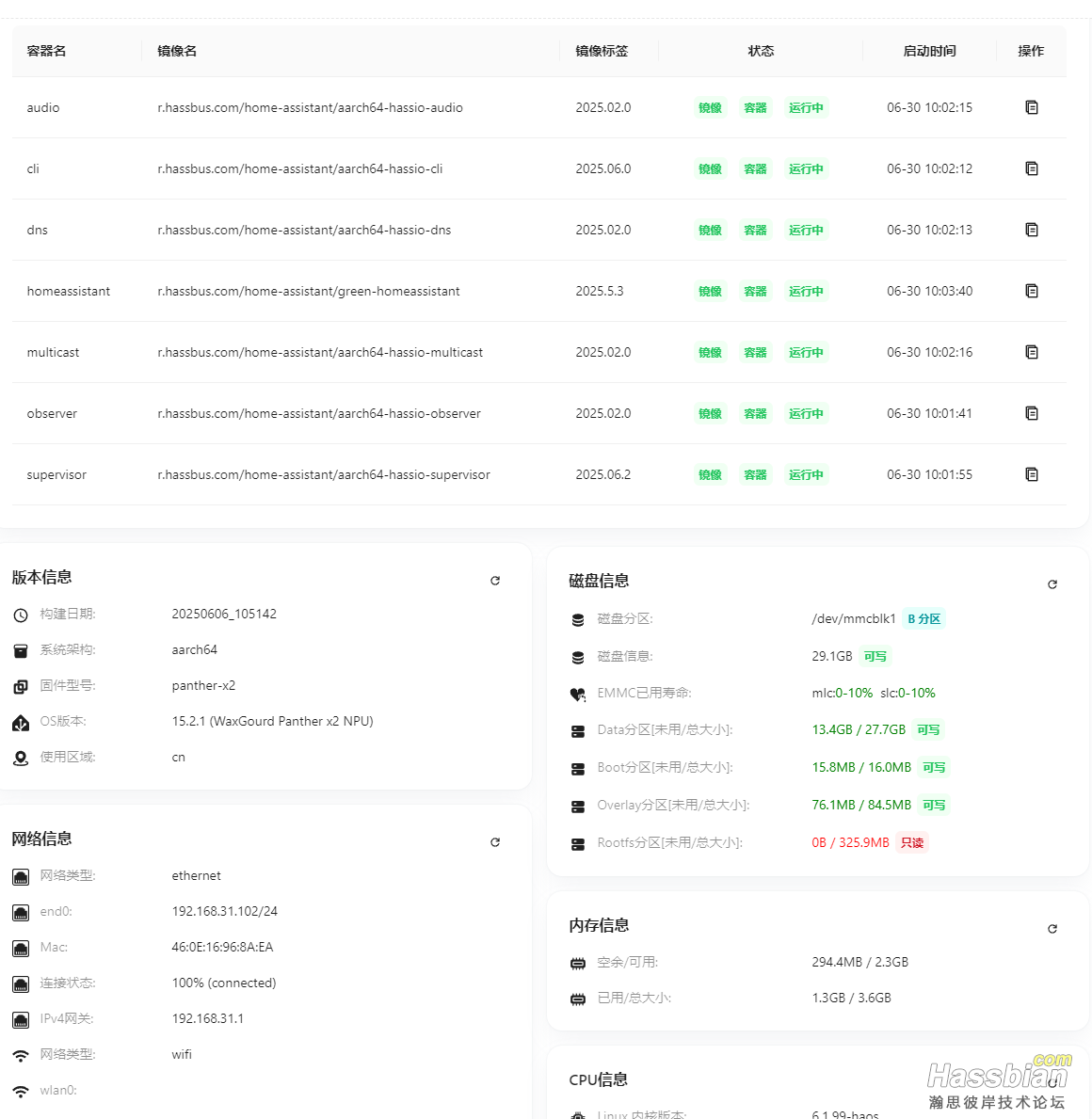

 楼主| 发表于 2025-6-30 15:23:13 | 显示全部楼层
v1na 手机认证
603
603
586
发表于 2025-6-30 18:17:13 | 显示全部楼层
用常规维护的core版本升降功能升级一下core 然后持续观察su日志
