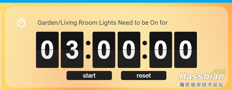

发表于 2025-6-23 21:37:46 | 显示全部楼层
type: custom:flipdown-timer-card
entity: timer.garden_occupancy_timer
show_hour: true
show_title: true
theme: dark
styles:
  rotor:
    width: 50px
    height: 80px
  button:
    width: 100px
    location: bottom
name: Garden/Living Rroom Lights Need to be On for
很好用,实时显示还有多少时间
