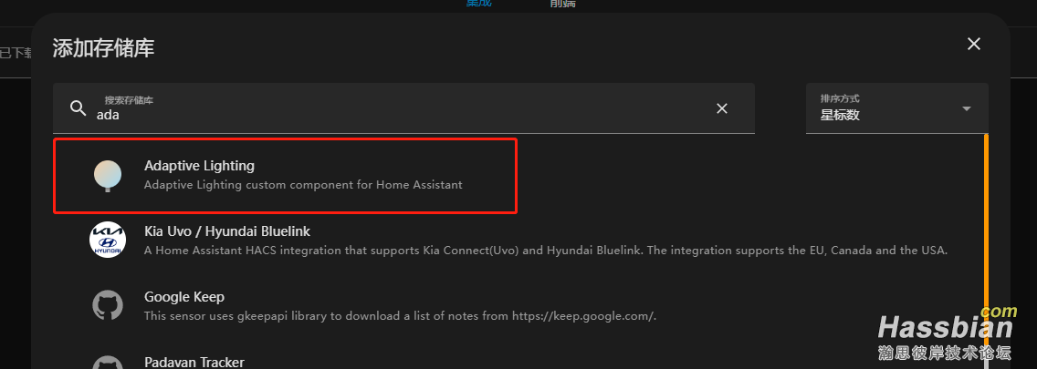

在HACS搜索
     Adaptive Lighting
存储库:basnijholt/adaptive-lighting: Adaptive Lighting custom component for Home Assistant (github.com)
