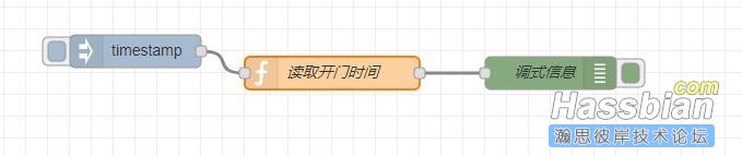

  1. 持久化存储的变量与存储在内存的变量是两个变量,即使它们名称完全一样
  2. 读取持久化变量的时候,需声明变量类型,否则会优先读取内存变量,即使这个变量不存在
[{"id":"17b92e08.db1f12","type":"inject","z":"6fddb7c0.6e1238","name":"","topic":"","payload":"","payloadType":"date","repeat":"","crontab":"","once":false,"onceDelay":0.1,"x":620,"y":540,"wires":[["ce9d5ed6.2510a"]]},{"id":"ce9d5ed6.2510a","type":"function","z":"6fddb7c0.6e1238","name":"读取开门时间","func":"var message = global.get('open_door_time', \"store\");\n\nmsg.payload = {};\nmsg.payload.data = {\"message\":message,\"miai_num\":\"0\"};\nreturn msg;\n","outputs":1,"noerr":0,"x":800,"y":560,"wires":[["5f7fa373.528d2c"]]},{"id":"5f7fa373.528d2c","type":"debug","z":"6fddb7c0.6e1238","name":"调式信息","active":true,"tosidebar":true,"console":false,"tostatus":false,"complete":"true","x":1000,"y":560,"wires":[]}]
