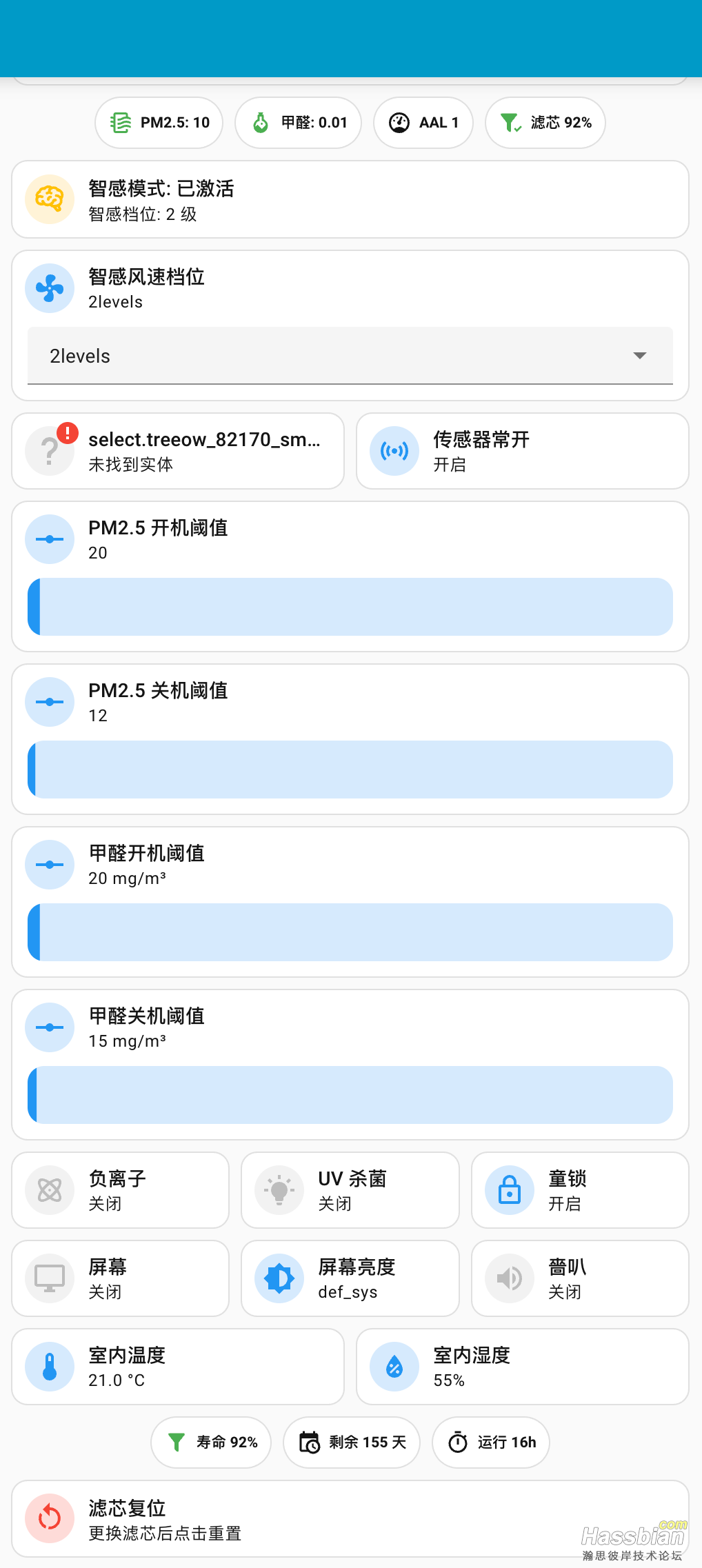

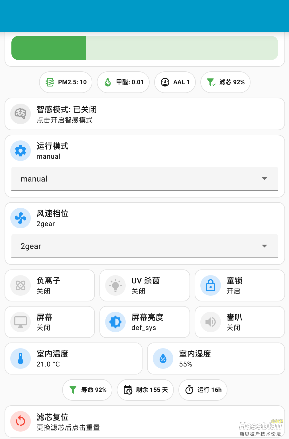

具体效果:
path: t2_pro_detail
title: T2 Pro 详细设置
subview: true
cards:
  - type: vertical-stack
    cards:
      - type: conditional
        conditions:
          - entity: switch.treeow_82170_smart_mode_switch
            state: "off"
        card:
          type: custom:mushroom-fan-card
          entity: fan.treeow_t2_pro_custom
          show_percentage_control: true
          icon_animation: true
          name: T2 Pro 空气净化器
      - type: conditional
        conditions:
            state: "on"
        card:
          show_percentage_control: false
          name: T2 Pro (智感模式)
      - type: custom:mushroom-chips-card
        alignment: center
        chips:
          - type: template
            entity: sensor.treeow_82170_pm25
            icon: mdi:air-filter
            content: "PM2.5: {{ states(entity) }}"
            icon_color: >
              {% set val = states(entity) | float %} {{ 'green' if val <= 35
              else 'orange' if val <= 75 else 'red' }}
            tap_action:
              action: more-info
          - type: template
            entity: sensor.treeow_82170_ch2o_value
            icon: mdi:flask-round-bottom
            content: "甲醛: {{ states(entity) }}"
            icon_color: >
              {% set val = states(entity) | float %} {{ 'green' if val <= 0.08
              else 'red' }}
            tap_action:
              action: more-info
          - type: template
            entity: sensor.treeow_82170_aal
            icon: mdi:gauge
            content: AAL {{ states(entity) }}
            tap_action:
              action: more-info
          - type: template
            entity: sensor.treeow_82170_filter_life
            icon: mdi:filter-check
            content: 滤芯 {{ states(entity) }}%
            icon_color: >
              {% set val = states(entity) | float %} {{ 'green' if val > 20 else
              'orange' if val > 10 else 'red' }}
            tap_action:
              action: more-info
      - type: custom:mushroom-template-card
        primary: "智感模式: {{ '已激活' if is_state(entity, 'on') else '已关闭' }}"
        secondary: >-
          {% if is_state(entity, 'on') %}智感档位: {{
          states('select.treeow_82170_smart_fan_speed').replace('levels', ' 级')
          }}{% else %}点击开启智感模式{% endif %}
        icon: mdi:brain
        tap_action:
          action: toggle
        icon_color: "{{ 'amber' if is_state(entity, 'on') else 'grey' }}"
      - type: conditional
        conditions:
            state: "on"
        card:
          cards:
            - type: custom:mushroom-select-card
              entity: select.treeow_82170_smart_fan_speed
              icon: mdi:fan
            - type: grid
              columns: 2
              square: false
              cards:
                - type: custom:mushroom-entity-card
                  entity: select.treeow_82170_smart_night_switch
                  secondary_info: 21:00 - 08:00
                  icon: mdi:weather-night
                  entity: switch.treeow_82170_sensor_onoff
                  icon: mdi:access-point
            - type: custom:mushroom-number-card
              entity: number.treeow_82170_smart_pm25
              entity: number.treeow_82170_smart_pm25_off
              entity: number.treeow_82170_smart_hcho
              entity: number.treeow_82170_smart_hcho_off
      - type: conditional
        conditions:
            state: "off"
        card:
          cards:
              entity: select.treeow_82170_mode
              icon: mdi:cog
              entity: select.treeow_82170_fan_speed_enum
              icon: mdi:fan
      - type: grid
        columns: 3
        square: false
        cards:
            entity: switch.treeow_82170_anion
            icon: mdi:atom
            entity: switch.treeow_82170_uv
            icon: mdi:lightbulb-on
            entity: switch.treeow_82170_child_lock
            icon: mdi:lock-outline
      - type: grid
        columns: 3
        square: false
        cards:
            entity: switch.treeow_82170_light
            icon: mdi:monitor
            entity: select.treeow_82170_screen_set
            icon: mdi:brightness-6
            entity: switch.treeow_82170_speaker_onoff
            icon: mdi:volume-high
      - type: grid
        columns: 2
        square: false
        cards:
            entity: sensor.treeow_82170_temp_indoor
            icon: mdi:thermometer
            entity: sensor.treeow_82170_humidity
            icon: mdi:water-percent
        alignment: center
        chips:
          - type: template
            icon: mdi:filter
            content: 寿命 {{ states(entity) }}%
            icon_color: >-
            tap_action:
              action: more-info
          - type: template
            entity: sensor.treeow_82170_filter_days
            icon: mdi:calendar-clock
            content: 剩余 {{ states(entity) }} 天
            tap_action:
              action: more-info
          - type: template
            entity: sensor.treeow_82170_runtime_total
            icon: mdi:timer-outline
            content: 运行 {{ (states(entity) | float / 60) | round(0) }}h
            tap_action:
              action: more-info
        entity: button.treeow_82170_filter_reset
        primary: 滤芯复位
        secondary: 更换滤芯后点击重置
        icon: mdi:restart
        icon_color: red
        tap_action:
          action: call-service
          service: button.press
          target:
            entity_id: button.treeow_82170_filter_reset
          confirmation:
            text: 确定要重置滤芯寿命吗?
