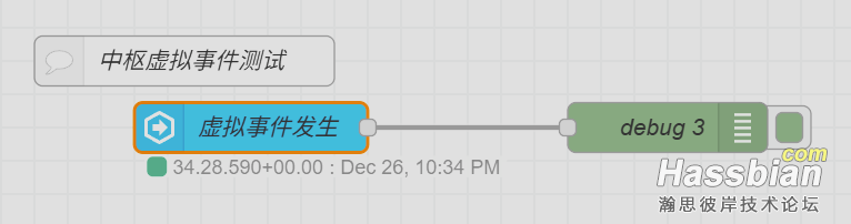

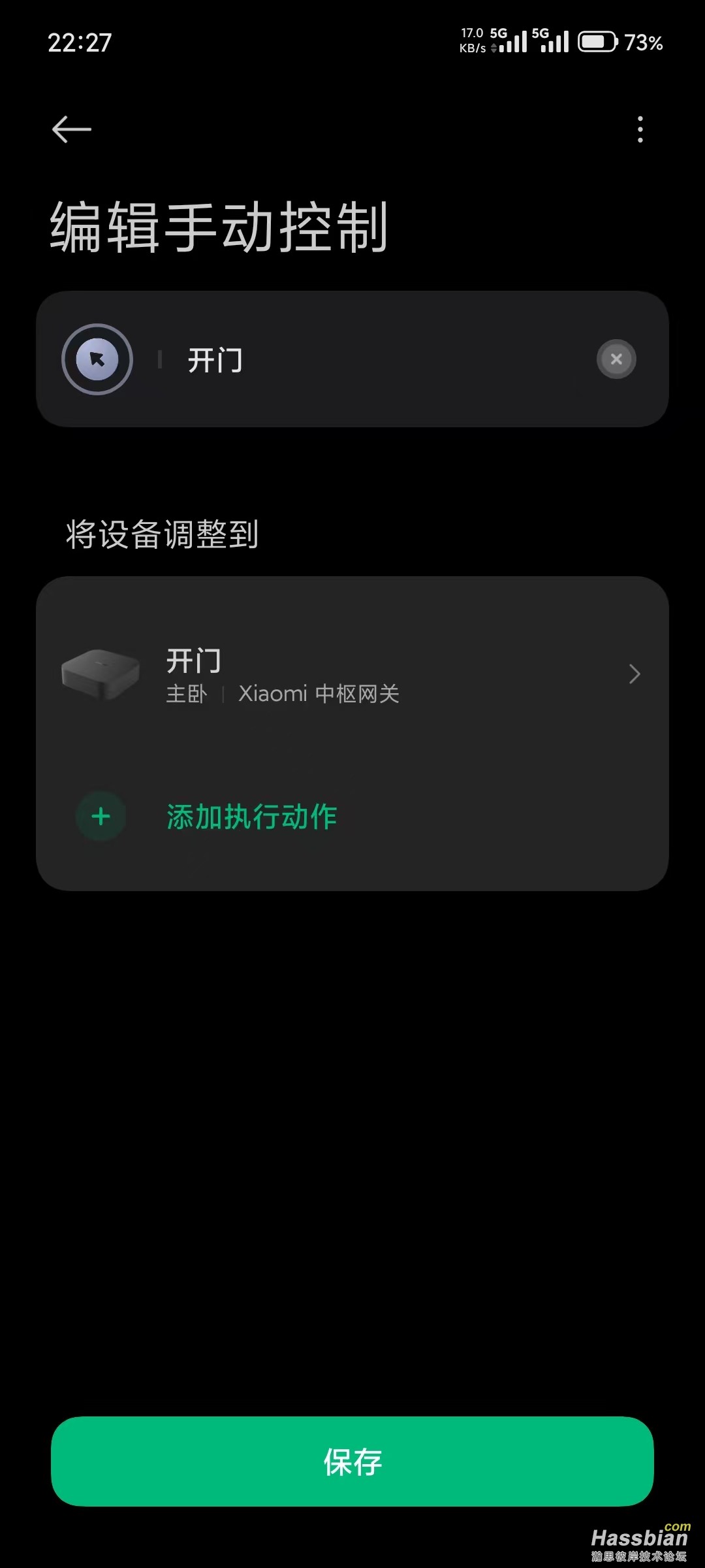

在米家APP里创建手动控制设置关键字

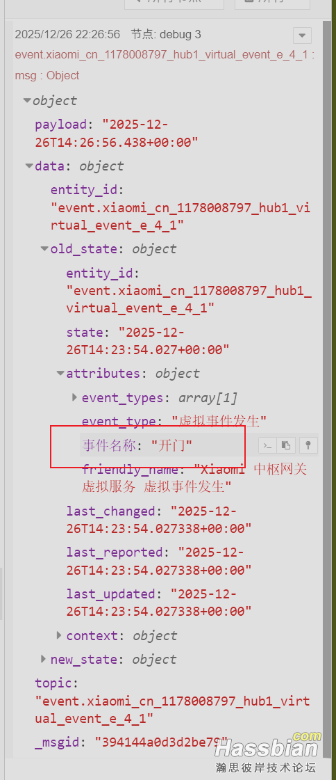

在NR里接收虚拟事件
用关键字识别就可以用小爱音箱控制你的任意设备了
[{"id":"a357f181a63ef08f","type":"function","z":"7a9968dc924e8577","g":"17c860a3b3bc74a6","name":"设置发送内容","func":"msg.payload = "开门";\nreturn msg;","outputs":1,"timeout":0,"noerr":0,"initialize":"","finalize":"","libs":[],"x":300,"y":3560,"wires":[["cde1c0cda94599fa"]]}]
这是NR给中枢网关发送事件的流
