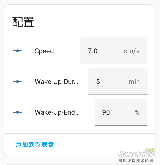

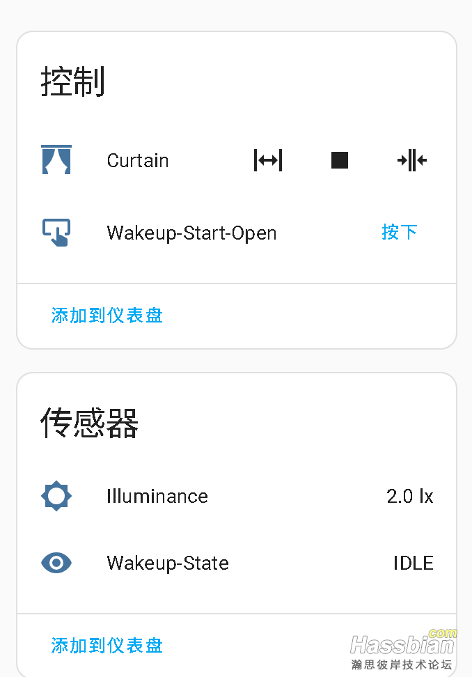

在hass配置文件夹下,建立xiaomi_gateway3.py,内容是
from custom_components.xiaomi_gateway3.core.devices import *
DEVICES = [{
    28968: ["Linptech", "Linptech Mini Curtain Motor", "linp.curtain.ec1db"],
    "spec": [
        MapConv("curtain", "cover", mi="2.p.1", map={0: "open", 1: "close", 2: "stop", 3: "toggle"}),
        MapConv("run_state", mi="2.p.2", map={0: "opening", 1: "closing", 2: "stop"}),
        CurtainPosConv("position", mi="2.p.3"),
        BaseConv("target_position", mi="2.p.4"),
        BaseConv("illuminance", "sensor", mi="3.p.1"),
        BaseConv("wakeup-start-open", "button", mi="5.a.5"),
        MapConv("wakeup-state", "sensor", mi="5.p.2", map={0: "IDLE", 1: "Running"}),
        MathConv("speed", "number", mi="5.p.4", min=1, max=14, step=0.1, entity={"category": "config", "units": "cm/s"}),
        MathConv("wake-up-end-position", "number", mi="5.p.5", min=10, max=100, step=1, entity={"category": "config", "units": "%"}),
        MathConv("wake-up-duration", "number", mi="5.p.6", min=5, max=240, step=1, entity={"category": "config", "units": UNIT_MINUTES}),
}] + DEVICES
效果
