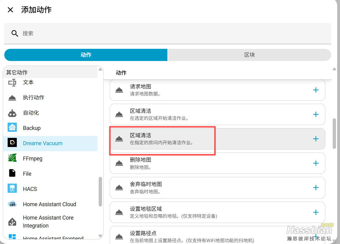

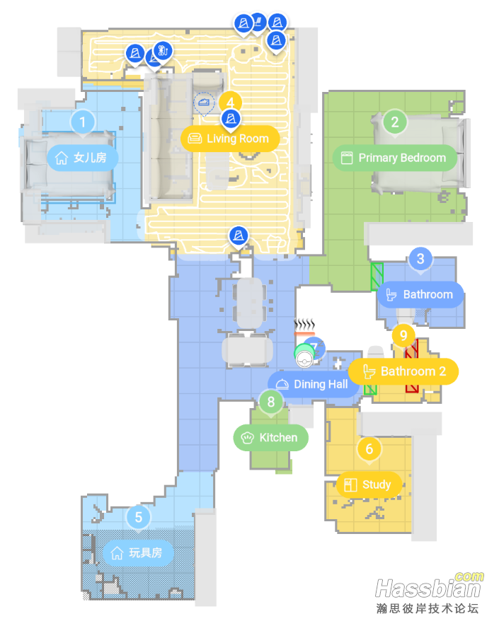

我已使用Dreame Vacuum在HA部署了S50PRO,后续在设置HA自动化的过程中发现执行动作有区域清扫选项(应该就是手机app的选区清扫)。但这边的具体房间需要用区域代码,请问这个代码怎么设置或者获取? image.png image.png image.png

需要提供房间ID号(segments)
action: dreame_vacuum.vacuum_clean_segment
data:
  segments: 3
  repeats: 1
  suction_level: 1
  water_volume: 1
  suction_level: "[0,3] or 0"
  water_volume: "[1,3] or 1"
vacuum实体属性里有
