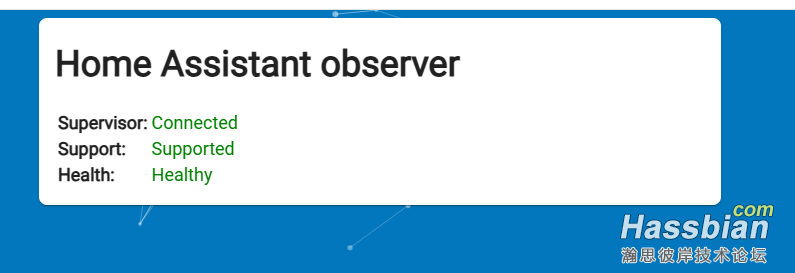

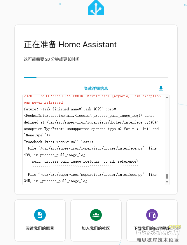

第一次卡住我设置了旁路由的代理,并且进去把网关挂上了,第二次一开始都很顺,然后出了个Error on Home Assistant installation.后就一直开始这个循环了
2025-11-23 00:34:48.577 ERROR (MainThread) [asyncio] Task exception was never retrieved
future: <Task finished name='Task-4023' coro=<DockerInterface.install.<locals>.process_pull_image_log() done, defined at /usr/src/supervisor/supervisor/docker/interface.py:404> exception=TypeError("unsupported operand type(s) for +=: 'int' and 'NoneType'")>
  File "/usr/src/supervisor/supervisor/docker/interface.py", line 406, in process_pull_image_log
    self._process_pull_image_log(curr_job_id, reference)
  File "/usr/src/supervisor/supervisor/docker/interface.py", line 345, in _process_pull_image_log
    total += job.extra["total"]
TypeError: unsupported operand type(s) for +=: 'int' and 'NoneType'
2025-11-23 00:34:48.813 ERROR (MainThread) [asyncio] Task exception was never retrieved
future: <Task finished name='Task-4024' coro=<DockerInterface.install.<locals>.process_pull_image_log() done, defined at /usr/src/supervisor/supervisor/docker/interface.py:404> exception=TypeError("unsupported operand type(s) for +=: 'int' and 'NoneType'")>
2025-11-23 00:34:48.926 ERROR (MainThread) [asyncio] Task exception was never retrieved
future: <Task finished name='Task-4025' coro=<DockerInterface.install.<locals>.process_pull_image_log() done, defined at /usr/src/supervisor/supervisor/docker/interface.py:404> exception=TypeError("unsupported operand type(s) for +=: 'int' and 'NoneType'")>
2025-11-23 00:34:49.026 ERROR (MainThread) [asyncio] Task exception was never retrieved
future: <Task finished name='Task-4026' coro=<DockerInterface.install.<locals>.process_pull_image_log() done, defined at /usr/src/supervisor/supervisor/docker/interface.py:404> exception=TypeError("unsupported operand type(s) for +=: 'int' and 'NoneType'")>
2025-11-23 00:34:49.132 ERROR (MainThread) [asyncio] Task exception was never retrieved
future: <Task finished name='Task-4027' coro=<DockerInterface.install.<locals>.process_pull_image_log() done, defined at /usr/src/supervisor/supervisor/docker/interface.py:404> exception=TypeError("unsupported operand type(s) for +=: 'int' and 'NoneType'")>
2025-11-23 00:34:49.142 ERROR (MainThread) [asyncio] Task exception was never retrieved
future: <Task finished name='Task-4028' coro=<DockerInterface.install.<locals>.process_pull_image_log() done, defined at /usr/src/supervisor/supervisor/docker/interface.py:404> exception=TypeError("unsupported operand type(s) for +=: 'int' and 'NoneType'")>
2025-11-23 00:34:49.144 ERROR (MainThread) [asyncio] Task exception was never retrieved
future: <Task finished name='Task-4029' coro=<DockerInterface.install.<locals>.process_pull_image_log() done, defined at /usr/src/supervisor/supervisor/docker/interface.py:404> exception=TypeError("unsupported operand type(s) for +=: 'int' and 'NoneType'")>

supervisor是否被升成11.2了?
 楼主| 发表于 2025-11-23 14:47:02 | 显示全部楼层
好像是,我有印象他在下11.2版本的supervisor
138
1163
1163
1024
发表于 2025-11-23 16:51:04 | 显示全部楼层
这个版本就会这样,现在应是11.4了,11.3就开始正常了。
