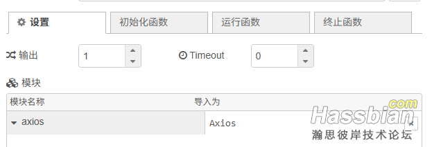

发表于 2025-12-5 10:26:27 | 显示全部楼层
ha上下文看起来都是只读数据,没办法直接执行
在函数内用axios加官方的rest api试试
const token = flow.get("rest_token")
const baseURL = flow.get("rest_host")
const axios = Axios.create({
    baseURL: baseURL,
    timeout: 1000,
    headers: {
        "Authorization": `Bearer ${token}`,
        "content-type": "application/json",
    responseType: "json",
    validateStatus: () => true
//https://developers.home-assistant.io/docs/api/rest/
msg.response = await axios.get("/config")
return msg;

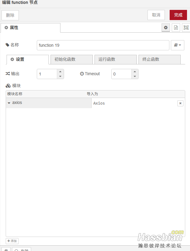

发表于 2025-12-5 10:45:12 | 显示全部楼层
ha上下文内貌似都是只读数据
用axios加官方的rset api 试试
    baseURL: baseURL,
    timeout: 1000,
    headers: {
return msg;
