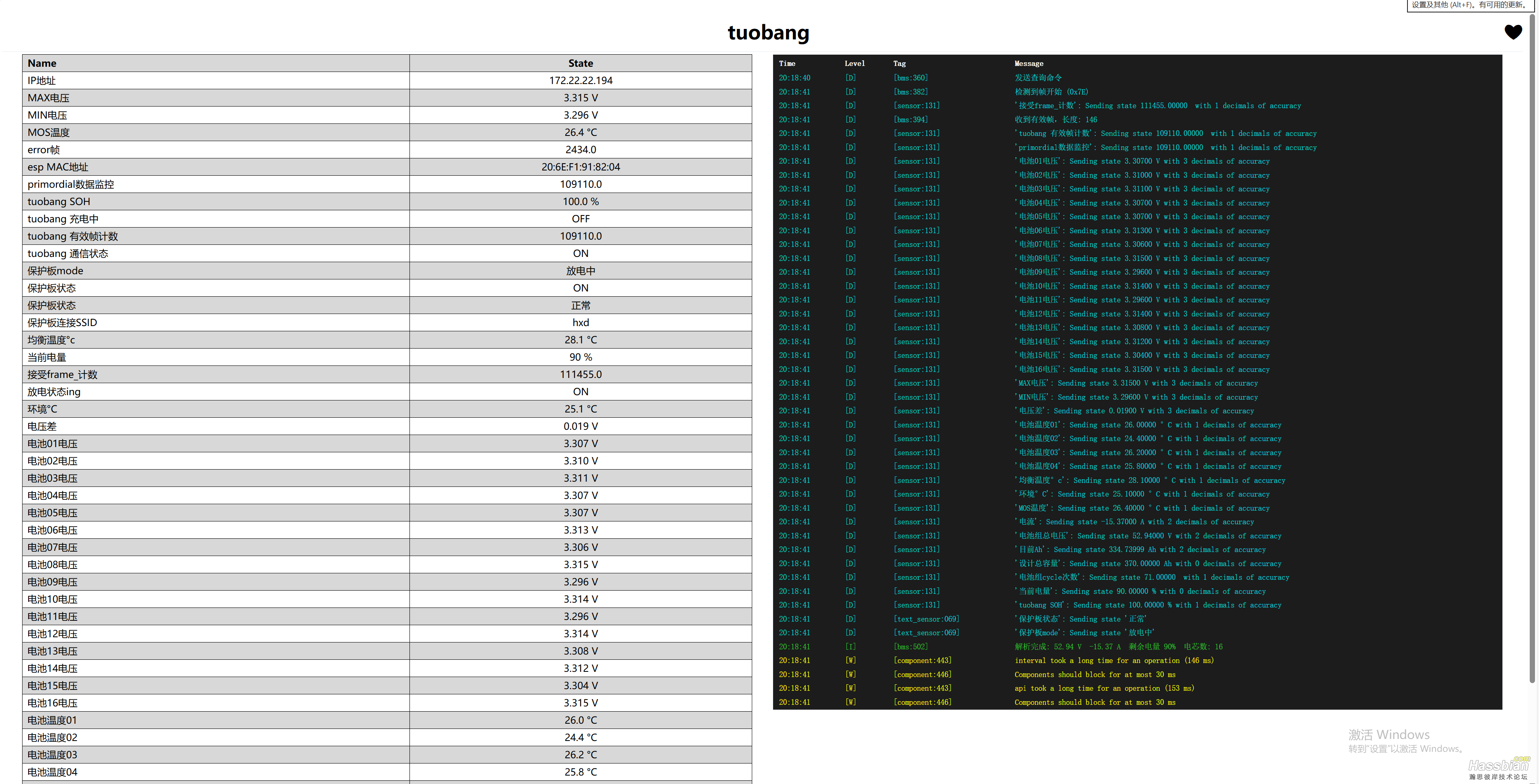

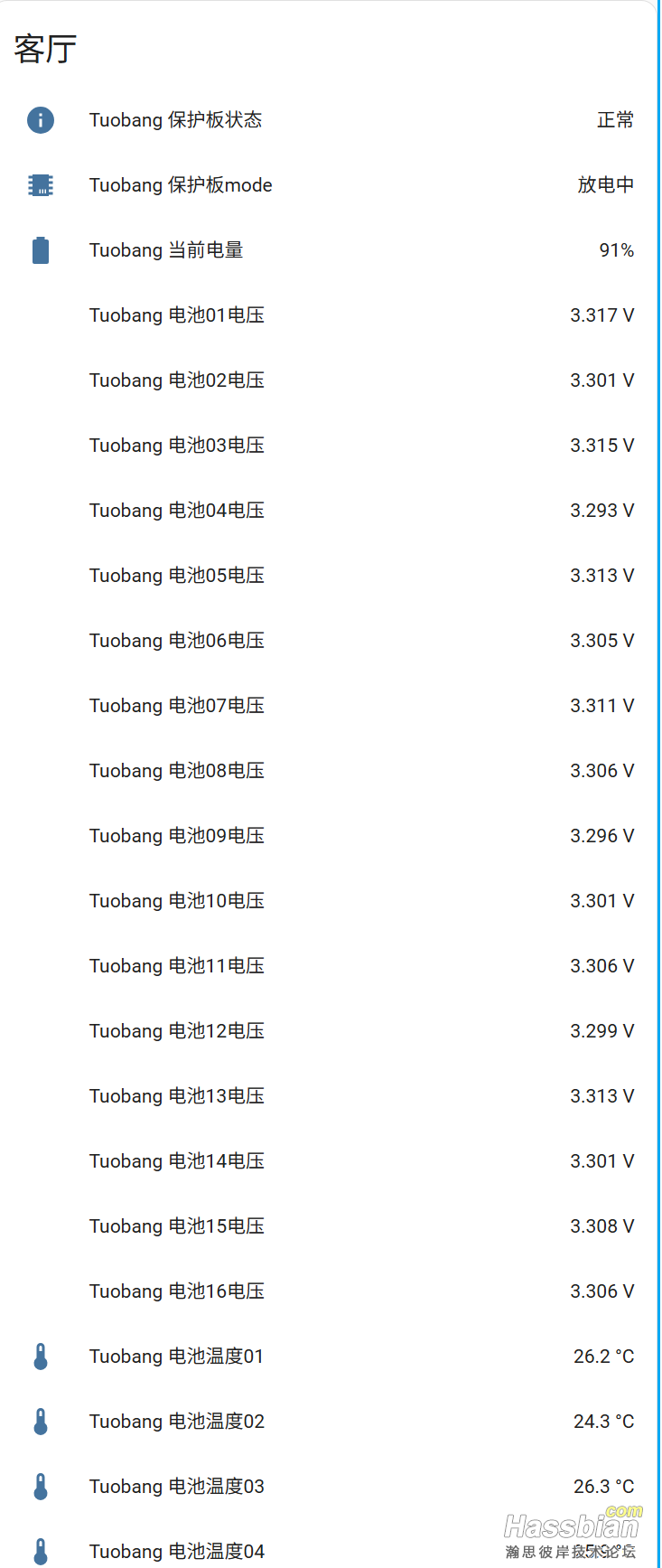

买了个大刀370,卖家送了拓邦200a的保护板,我想接入ha,发现没有任何教程,但是又看到不少人能接入,都是不公开,估计这个协议还是可以有收益的。直接通过ai折腾出来,通过485获取数据,但是只能看参数。不能调整设置,需要调整的请用通用上位机。想发bin文件,好像发不了
这个是是在ha的显示。 image.png ,这个是web显示 image.png 。这个是用esp32 s3版子的yaml。代码如下。

                    case 10: id(cell_11).publish_state(cell_v); break;
                    case 11: id(cell_12).publish_state(cell_v); break;
                    case 12: id(cell_13).publish_state(cell_v); break;
                    case 13: id(cell_14).publish_state(cell_v); break;
                    case 14: id(cell_15).publish_state(cell_v); break;
                    case 15: id(cell_16).publish_state(cell_v); break;
                  pos += 4;
                id(max_cell_voltage).publish_state(max_cell_v);
                id(min_cell_voltage).publish_state(min_cell_v);
                id(voltage_difference).publish_state(max_cell_v - min_cell_v);
                // 解析温度数量
                int temp_count = strtol(data.substr(pos, 2).c_str(), nullptr, 16);
                pos += 2;
                // 解析7路温度
                for (int i = 0; i < 7 && i < temp_count; i++) {
                  uint16_t temp_raw = strtol(data.substr(pos, 4).c_str(), nullptr, 16);
                  float temperature = (temp_raw - 2731) * 0.1f;
                  switch(i) {
                    case 0: id(temp_01).publish_state(temperature); break;
                    case 1: id(temp_02).publish_state(temperature); break;
                    case 2: id(temp_03).publish_state(temperature); break;
                    case 3: id(temp_04).publish_state(temperature); break;
                    case 4: id(temp_05).publish_state(temperature); break;
                    case 5: id(temp_06).publish_state(temperature); break;
                    case 6: id(temp_07).publish_state(temperature); break;
                  pos += 4;
                // 解析电流
                int16_t current_raw = (int16_t)strtol(data.substr(pos, 4).c_str(), nullptr, 16);
                float current = current_raw * 0.01f;
                id(bms_current).publish_state(current);
                pos += 4;
                // 解析总电压
                uint16_t total_voltage_raw = strtol(data.substr(pos, 4).c_str(), nullptr, 16);
                float total_voltage_val = total_voltage_raw * 0.01f;
                id(total_voltage).publish_state(total_voltage_val);
                pos += 4;
                // 解析剩余容量
                uint16_t remaining_cap_raw = strtol(data.substr(pos, 4).c_str(), nullptr, 16);
                float remaining_capacity_val = remaining_cap_raw * 0.01f;
                id(remaining_capacity).publish_state(remaining_capacity_val);
                pos += 4;
                // 跳过2字节标志
                pos += 2;
                // 解析总容量
                uint16_t total_cap_raw = strtol(data.substr(pos, 4).c_str(), nullptr, 16);
                float total_capacity_val = total_cap_raw * 0.01f;
                id(total_capacity).publish_state(total_capacity_val);
                pos += 4;
                // 解析循环次数
                uint16_t cycles = strtol(data.substr(pos, 4).c_str(), nullptr, 16);
                id(cycle_count).publish_state(cycles);
                pos += 4;
                // 解析SOC
                int soc = strtol(data.substr(pos, 2).c_str(), nullptr, 16);
                id(bms_soc).publish_state(soc);
                pos += 2;
                // 解析SOH
                int soh = strtol(data.substr(pos, 2).c_str(), nullptr, 16);
                id(bms_soh).publish_state(soh);
                pos += 2;
                // 更新状态
                id(bms_status).publish_state(crc_ok ? "Normal" : "CRC Error");
                id(bms_mode).publish_state(current > 0.02f ? "Charging" :
                                          (current < -0.02f ? "Discharging" : "Idle"));
                id(bms_charging).publish_state(current > 0.02f);
                id(bms_discharging).publish_state(current < -0.02f);
                id(bms_communication).publish_state(true);
                id(last_bms_update) = millis();
                ESP_LOGI("bms", "Frame parsed: %.2fV, %.2fA, %d%%, CRC: %s",
                        total_voltage_val, current, soc, crc_ok ? "OK" : "ERROR");
                ascii_buffer.clear();
              // 处理数据字符
              else if (byte >= 0x20 || byte == 0x09 || byte == 0x0A) {
                ascii_buffer += (char)byte;
                if (ascii_buffer.length() > 200) {
                  ESP_LOGW("bms", "Buffer overflow, clearing buffer");
              else if (byte != 0x00) {
                ESP_LOGD("bms", "Ignored non-printable char: 0x%02X", byte);
  # 10秒检查通信状态
  - interval: 10s
    then:
      - lambda: |-
          if (millis() - id(last_bms_update) > 30000) {
            id(bms_communication).publish_state(false);
            id(bms_status).publish_state("Timeout");
