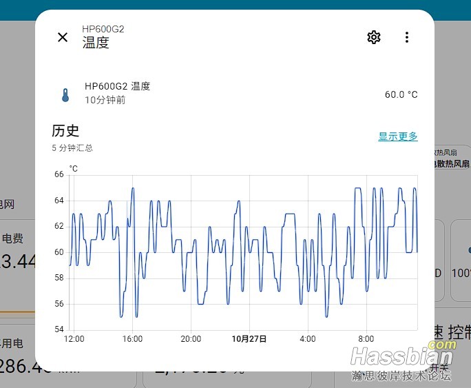

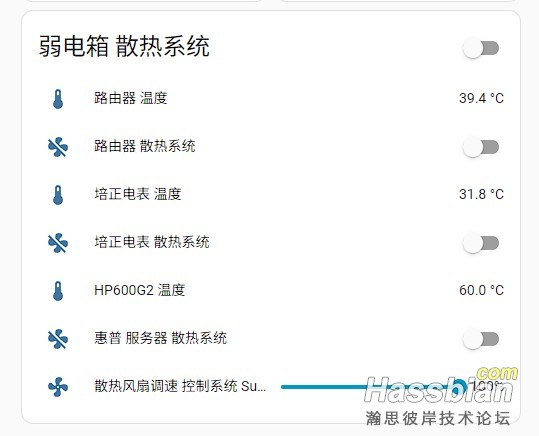

我想用服务器的cpu温度作为 一个条件,比如cpu温度低于59度就关闭外置风扇,高于60 低于70,这个外置风扇风扇就根据温度的变化调整风扇转速,且风扇的转速限制在10%-50%这个区间范围,转速太高吵死人。风扇具备调速功能,通esp8266,用pwm输出电压,控制风扇转速。

让AI帮你写一个,使用ESPHOME,我就是这样处理:储能一体柜有8个风扇,根据内部温度传感器的温度来PWM控制风扇,最高25~65度对应5~100%,晚上还增加一个系数(晚上温度低,再降一点风扇速度)

 楼主| 发表于 2025-10-27 17:10:49 | 显示全部楼层
alias: 温控风扇平滑调节(带最低运行时间)
description: ""
triggers:
  - minutes: /1
    trigger: time_pattern
  - entity_id: sensor.hp600g2_temperature
    trigger: state
actions:
  - variables:
      target: "{{ states('sensor.fan_target_speed') | int(0) }}"
      current: "{{ states('input_number.fan_smoothing_speed') | int(0) }}"
  - choose:
      - conditions:
          - condition: template
            value_template: "{{ target > 0 }}"
            value_template: "{{ current == 0 }}"
        sequence:
          - target:
              entity_id: timer.fan_min_run
            action: timer.start
  - choose:
      - conditions:
            value_template: "{{ target > current }}"
        sequence:
          - target:
              entity_id: input_number.fan_smoothing_speed
            data:
              value: "{{ [current + 2, target] | min }}"
            action: input_number.set_value
      - conditions:
            value_template: "{{ target < current }}"
        sequence:
          - target:
            data:
              value: "{{ [current - 2, target] | max }}"
  - target:
      entity_id: fan.super_fan_super_fan_kai_guan
    data:
      percentage: "{{ states('input_number.fan_smoothing_speed') | int(0) }}"
    action: fan.set_percentage
mode: single
configurator.yaml
input_number:
  fan_smoothing_speed:
    min: 0
    max: 100
    step: 1
    mode: box
input_boolean:
  fan_keep_running:
    initial: off
timer:
  fan_min_run:
    duration: "00:02:00"
