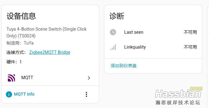

不是有两个禁用的实体吗?
这两个实体没用的吧,z2m报错:
[2025/11/10 10:56:35] z2m: Configuring '0xcc86ecfffef8bd19'[2025/11/10 10:56:35] z2m: Failed to configure '0xcc86ecfffef8bd19', attempt 1 (TypeError: logger.warn is not a function    at Object.configure (/config/zigbee2mqtt/external_converters/.tmp-ed42d4f2-tuya_ts0024-e4176679-36a2-4926-a191-45f593d3c8ca.js:47:24)    at processTicksAndRejections (node:internal/process/task_queues:105:5)    at runNextTicks (node:internal/process/task_queues:69:3)    at processImmediate (node:internal/timers:453:9)    at Configure.configure (/app/lib/extension/configure.ts:123:13)    at Immediate.<anonymous> (/app/lib/extension/configure.ts:66:17))
