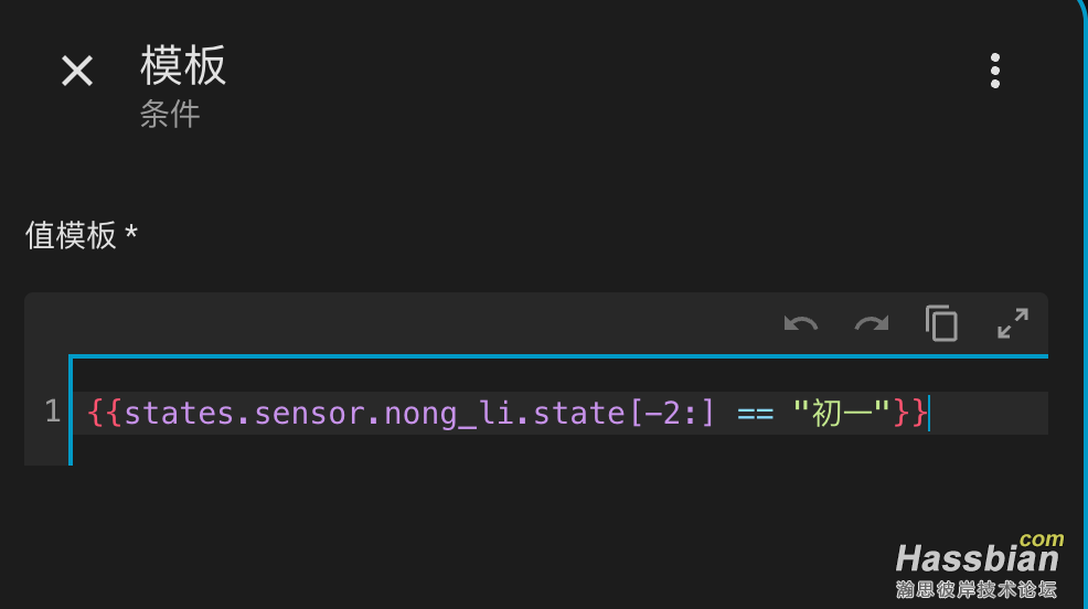

解决办法由@dscao提供:
alias: 农历初一
description: ""
triggers:
  - trigger: state
    entity_id:
      - sensor.zhong_guo_lao_huang_li_nong_li
    from: null
conditions:
  - condition: template
    value_template: "{{states("sensor.zhong_guo_lao_huang_li_nong_li")[10:] == "初一" }}"
actions:
  - action: notify.send_message
    metadata: {}
    data:
      message: 今天是初一
82

发表于 2025-10-19 09:40:14 | 显示全部楼层
用模板:{{states.sensor.zhong-guo_lao_huang-li_nong_li.state[-2:]}}

发表于 2025-10-19 23:03:52 | 显示全部楼层
myron412 发表于 2025-10-19 21:28
谢谢D大回复我,如果大佬有时间,麻烦贴个类似这种自动化的例子让我抄抄 ...
description: ""
mode: single
triggers:
  - trigger: time
    at: "09:00:00"
conditions:
    value_template: "{{states.sensor.nong_li.state[-2:] == "初一"}}"
actions:
  - action: persistent_notification.create
    metadata: {}
    data:
      message: 今天是初一
