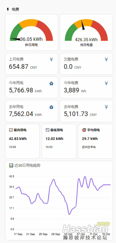

发表于 2025-10-16 11:10:33 | 显示全部楼层 |阅读模式
用了cubicpil大大的南方电网电费数据HA集成(https://bbs.hassbian.com/thread-18578-1-1.html)和hunl1986大大的[UI界面] 记录南方电网集成UI界面使用(sensor和apexcharts-card卡片)(https://bbs.hassbian.com/forum.php?mod=viewthread&tid=21834&page=1&authorid=62030
具体代码:
type: grid
columns: 2
square: false
cards:
  - type: vertical-stack
    cards:
      - type: gauge
        entity: sensor.lastdate_power_2
        unit: kWh
        min: 0
        max: 1000
        severity:
          green: 0
          yellow: 300
          red: 600
        needle: true
    cards:
      - type: gauge
        entity: sensor.curmonth_power_2
        unit: kWh
        min: 0
        max: 1000
        severity:
          green: 0
          yellow: 300
          red: 600
        needle: true
cards:
  - type: horizontal-stack
    cards:
      - hours_to_show: 24
        graph: none
        type: sensor
        detail: 1
        entity: sensor.lastmonth_fee_2
      - hours_to_show: 24
        graph: none
        type: sensor
        detail: 1
        entity: sensor.0800150051235490_arrears
    cards:
      - hours_to_show: 24
        graph: none
        type: sensor
        detail: 1
        entity: sensor.year_power_2
      - hours_to_show: 24
        graph: none
        type: sensor
        detail: 1
        entity: sensor.year_fee_2
    cards:
      - hours_to_show: 24
        graph: none
        type: sensor
        detail: 1
        entity: sensor.lastyear_power_2
      - hours_to_show: 24
        graph: none
        type: sensor
        detail: 1
        entity: sensor.lastyear_fee_2
cards:
  - type: grid
    columns: 3
    cards:
      - type: markdown
        content: >
          **📈 最高用电**
          <h3 style="color: #EF4444; margin: 5px 0;">{{
          (state_attr('sensor.history_day', 'history_day_value')[-30:] |
          map(attribute='kwh') | max) }} kWh</h3>
          <small style="color: #666;">
          {% set max_kwh = state_attr('sensor.history_day',
          'history_day_value')[-30:] | map(attribute='kwh') | max %}
          {% set max_date = state_attr('sensor.history_day',
          'history_day_value')[-30:] | selectattr('kwh', 'equalto', max_kwh) |
          map(attribute='date') | first %}
          {{ max_date[5:7] }}/{{ max_date[8:10] }}
          </small>
      - type: markdown
        content: >
          **📉 最低用电**
          <h3 style="color: #3B82F6; margin: 5px 0;">{{
          map(attribute='kwh') | min) }} kWh</h3>
          {% set min_kwh = state_attr('sensor.history_day',
          'history_day_value')[-30:] | map(attribute='kwh') | min %}
          {% set min_date = state_attr('sensor.history_day',
          'history_day_value')[-30:] | selectattr('kwh', 'equalto', min_kwh) |
          {{ min_date[5:7] }}/{{ min_date[8:10] }}
          </small>
      - type: markdown
        content: >
          **🎯 平均用电**
          <h3 style="color: #10B981; margin: 5px 0;">{{
          ((state_attr('sensor.history_day', 'history_day_value')[-30:] |
          map(attribute='kwh') | sum) / (state_attr('sensor.history_day',
          'history_day_value')[-30:] | length)) | round(1) }} kWh</h3>
          <small style="color: #666;">近30日平均</small>
  - type: custom:apexcharts-card
    header:
      show: true
      title: 📊 近30日用电趋势
    graph_span: 30d
    series:
      - entity: sensor.history_day
        type: line
        color: "#8B5CF6"
        stroke_width: 3
        unit: kWh
        curve: smooth
        data_generator: |
          const dailyData = entity.attributes.history_day_value || [];
          const recentData = dailyData.slice(-30);
          return recentData.map(item => {
            const date = new Date(item.date);
            return [date.getTime(), parseFloat(item.kwh) || 0];
    yaxis:
      - min: 0
        decimals: 1

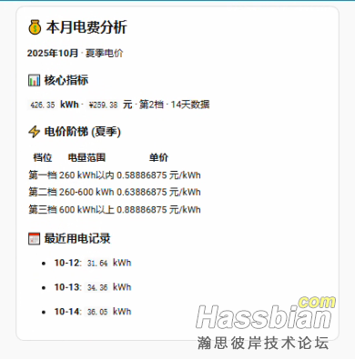

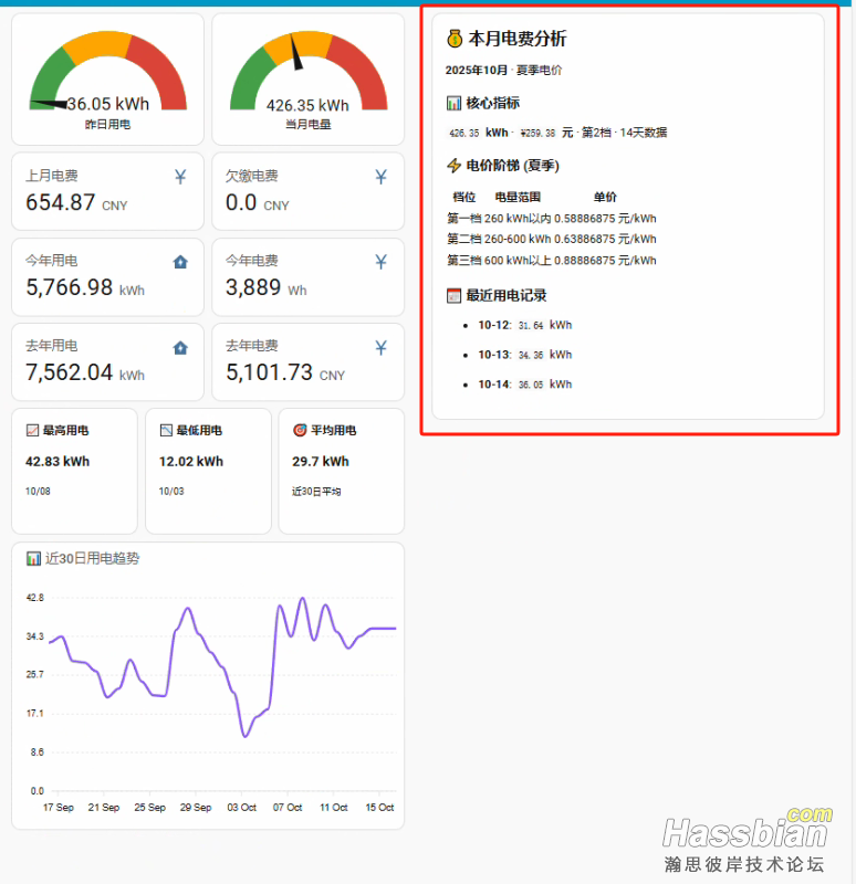

 楼主| 发表于 2025-10-16 11:40:14 | 显示全部楼层
再分享一个电价计算卡片
204
204
161
 楼主| 发表于 2025-10-16 11:42:07 | 显示全部楼层
Unripe3336 发表于 2025-10-16 11:40
再分享一个电价计算卡片
## 💰 本月电费分析
**{{ now().strftime('%Y年%m月') }}** · {{ (now().month in [5,6,7,8,9,10]) | iif('夏季', '冬季') }}电价
{% set daily_data = state_attr('sensor.0800150051235490_this_month_total_usage', 'this_month_by_day') %}
{% if daily_data is defined and daily_data %}
  {% set total_kwh = daily_data | map(attribute='kwh') | map('float') | sum %}
  {% set month = now().month %}
  {% set is_summer = month in [5,6,7,8,9,10] %}
  {% set phase1_price = 0.58886875 %}
  {% set phase2_price = 0.63886875 %}
  {% set phase3_price = 0.88886875 %}
  {% set phase1_power = 260 if is_summer else 200 %}
  {% set phase2_power = 600 if is_summer else 400 %}
  {% set phase1_fee = phase1_power * phase1_price %}
  {% set phase2_fee = phase1_fee + (phase2_power - phase1_power) * phase2_price %}
  {% if total_kwh <= phase1_power %}
    {% set total_fee = total_kwh * phase1_price %}
    {% set current_tier = 1 %}
  {% elif total_kwh <= phase2_power %}
    {% set total_fee = phase1_fee + (total_kwh - phase1_power) * phase2_price %}
    {% set current_tier = 2 %}
  {% else %}
    {% set total_fee = phase2_fee + (total_kwh - phase2_power) * phase3_price %}
    {% set current_tier = 3 %}
  {% endif %}
### 📊 核心指标
`{{ total_kwh | round(2) }}` **kWh** · `¥{{ total_fee | round(2) }}` **元** · 第{{ current_tier }}档 · {{ daily_data | length }}天数据
### ⚡ 电价阶梯 ({{ '夏季' if is_summer else '冬季' }})
| 档位 | 电量范围 | 单价 |
| 第一档 | {{ phase1_power }} kWh以内 | {{ phase1_price }} 元/kWh |
| 第二档 | {{ phase1_power }}-{{ phase2_power }} kWh | {{ phase2_price }} 元/kWh |
| 第三档 | {{ phase2_power }} kWh以上 | {{ phase3_price }} 元/kWh |
### 📅 最近用电记录
{% for day in daily_data[-3:] %}
- **{{ day.date[-5:] }}**: `{{ day.kwh }}` kWh
{% endfor %}
{% else %}
### ❌ 数据暂不可用
请检查传感器数据更新
{% endif %}

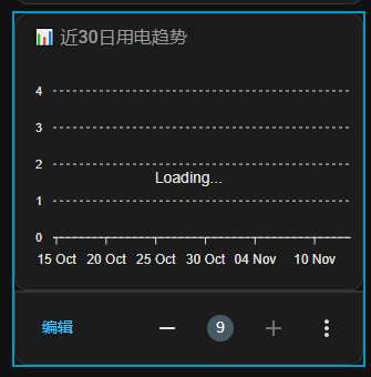

发表于 2025-10-17 01:53:45 | 显示全部楼层
38
105
发表于 2025-11-13 16:47:02 | 显示全部楼层
需要等几天?
