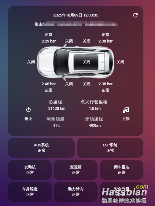

为了解决以上的问题,我重构了卡片,先请各位大佬看一下成品的视频吧。
这个界面使用的卡片为:Vehicle Status Card,可以直接从HACS中下载,这个卡片还自带了地图功能,如果各位大佬吧汽车接入后,能出现设备追踪器,就可以吧车辆定为添加到地图中。
下面贴几张截图吧

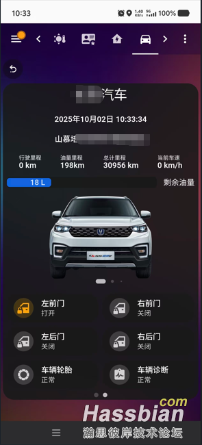

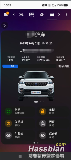

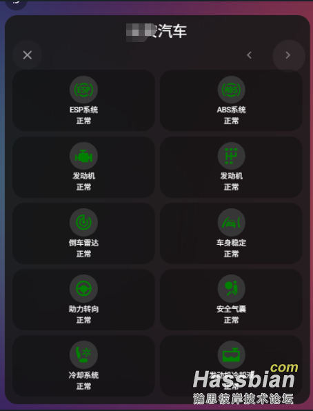

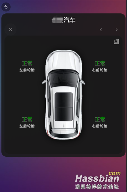

这个卡片解决了我的诉求,当车门、轮胎等状态发生变化时,图标的颜色也会发生变化,重点说一下,四个轮胎中只要有一个胎压异常,那首页上的车辆轮胎的图标就会变颜色,状态同时变为异常;车辆诊断也是同理,只要有一个系统是异常,那么车辆诊断的图标就会变色,状态也会随之变为异常。通过以上的颜色和状态变化,就可以起到醒目提醒的作用。
这个卡片我觉的挺美观的,各位大佬觉得呢

          - show_name: true
            show_icon: true
            type: custom:button-card
            entity: sensor.bian_su_xiang
            show_state: true
            tap_action:
              action: none
            hold_action:
              action: none
            state:
              - operator: template
                value: "[[[ return entity.state === "正常" ]]]"
                color: green
                value: "[[[ return entity.state === "异常" ]]]"
                color: "#ffa500"
            styles:
              icon:
                - width: 30px
              name:
                - font-size: 12px
              state:
                - font-size: 12px
              img_cell:
                - width: 45px
                - height: 45px
                - border-radius: 50%
                - background: "#363636"
      - type: horizontal-stack
        cards:
          - show_name: true
            show_icon: true
            entity: sensor.dao_che_lei_da
            show_state: true
            tap_action:
              action: none
            hold_action:
              action: none
            state:
                color: green
                color: "#ffa500"
            styles:
              icon:
                - width: 30px
              name:
                - font-size: 12px
              state:
                - font-size: 12px
              img_cell:
                - width: 45px
                - height: 45px
          - show_name: true
            show_icon: true
            entity: sensor.che_shen_wen_ding
            show_state: true
            tap_action:
              action: none
            hold_action:
              action: none
            state:
                color: green
                color: "#ffa500"
            styles:
              icon:
                - width: 30px
              name:
                - font-size: 12px
              state:
                - font-size: 12px
              img_cell:
                - width: 45px
                - height: 45px
        cards:
          - show_name: true
            show_icon: true
            entity: sensor.zhu_li_zhuan_xiang
            show_state: true
            tap_action:
              action: none
            hold_action:
              action: none
            state:
                color: green
                color: "#ffa500"
            styles:
              icon:
                - width: 30px
              name:
                - font-size: 12px
              state:
                - font-size: 12px
              img_cell:
                - width: 45px
                - height: 45px
          - show_name: true
            show_icon: true
            entity: sensor.an_quan_qi_nang
            show_state: true
            tap_action:
              action: none
            hold_action:
              action: none
            state:
                color: green
                color: "#ffa500"
            styles:
              icon:
                - width: 30px
              name:
                - font-size: 12px
              state:
                - font-size: 12px
              img_cell:
                - width: 45px
                - height: 45px
        cards:
          - show_name: true
            show_icon: true
            entity: sensor.leng_que_xi_tong
            show_state: true
            tap_action:
              action: none
            hold_action:
              action: none
            state:
                color: green
                color: "#ffa500"
            styles:
              icon:
                - width: 30px
              name:
                - font-size: 12px
              state:
                - font-size: 12px
              img_cell:
                - width: 45px
                - height: 45px
          - show_name: true
            show_icon: true
            entity: sensor.fa_dong_ji_leng_que_ye
            show_state: true
            tap_action:
              action: none
            hold_action:
              action: none
            state:
                color: green
                color: "#ffa500"
            styles:
              icon:
                - width: 30px
              name:
                - font-size: 12px
              state:
                - font-size: 12px
              img_cell:
                - width: 45px
                - height: 45px
    button_action:
      entity: ""
    button_type: default
images:
  - url: /local/CS55/车头.png
    title: /local/CS55/车头.png
  - url: /local/CS55/侧面.png
    title: /local/CS55/侧面.png
  - url: /local/CS55/车尾.png
    title: /local/CS55/车尾.png
layout_config:
  hide_card_name: false
  section_order:
    - indicators
    - range_info
    - images
    - buttons
  theme_config:
    theme: ios-dark-mode-blue-red
    mode: auto
  button_grid:
    columns: 2
    swipe: true
    button_layout: horizontal
    transparent: false
    hide_notify_badge: false
    rows: 3
mini_map:
  device_tracker: device_tracker.lao_bi_shou_ji
  enable_popup: true
indicator_rows:
  - row_items:
      - entity: input_text.che_liang_xin_xi_geng_xin_shi_jian
        type: entity
        show_name: false
        show_state: true
        show_icon: false
        tap_action:
          action: more-info
      - type: entity
        show_name: false
        show_state: true
        show_icon: false
        show_entity_picture: false
        include_state_template: false
        tap_action:
          action: more-info
        entity: sensor.che_liang_ding_wei
  - row_items:
      - type: entity
        show_name: true
        show_state: true
        show_icon: false
        tap_action:
          action: more-info
        entity: sensor.dian_huo_xing_shi_li_cheng
      - entity: sensor.ran_you_li_cheng
        type: entity
        show_name: true
        show_state: true
        show_icon: false
        tap_action:
          action: none
        color: accent
        ignore_global: false
        column_reverse: false
        row_reverse: false
      - type: entity
        show_name: true
        show_state: true
        show_icon: false
        tap_action:
          action: more-info
        entity: sensor.zong_li_cheng
        row_reverse: false
      - type: entity
        show_name: true
        show_state: true
        show_icon: false
        tap_action:
          action: none
        entity: sensor.dang_qian_che_su
range_info:
  - energy_level:
      entity: sensor.sheng_yu_you_liang
      tap_action:
        action: none
      value_position: inside
      value_alignment: end
      max_value: 58
    range_level:
      value_position: outside
      attribute: friendly_name
    charging_entity: ""
    progress_color: "#9bc1f8"
    color_blocks: false
    bar_height: 20
    color_thresholds:
      - value: 20
        color: "#0f64e1"
      - value: 30
        color: "#2879f1"
      - value: 40
        color: "#4e91f3"
      - value: 50
        color: "#75a9f6"
      - value: 60
        color: "#9bc1f8"
