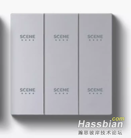

架不住这玩意便宜,45块钱,6个键都支持单击双击和长按,18种触发,还是玻璃面板很爽。
原不支持Xiaomi Gateway 3,研究了一晚上整明白了发出来给大家共享。
建文件:    /config/xiaomi_gateway3.py   粘贴以下内容即可(如电量不显示需重装电池):
from custom_components.xiaomi_gateway3.core.devices import *
DEVICES = [{
    16747: ["lemesh", "情景无线开关K6", "lemesh.remote.ts5"],
    "spec": [
        BaseConv("action", "sensor"),
        MapConv("action", mi="5.e.1012.p.1", map={1:"key1", 2:"key2", 3:"key3", 4:"key4", 5:"key5", 6:"key6"}),
        MapConv("action", mi="5.e.1013.p.1", map={1:"key1_double", 2:"key2_double", 3:"key3_double", 4:"key4_double", 5:"key5_double", 6:"key6_double"}),
        MapConv("action", mi="5.e.1014.p.1", map={1:"key1_hold", 2:"key2_hold", 3:"key3_hold", 4:"key4_hold", 5:"key5_hold", 6:"key6_hold"}),
#        BaseConv("battery", "sensor", mi="4.p.1003"),
        BLEByteConv("battery", "sensor", mi="4.p.1003", entity=ENTITY_LAZY),
}]+ DEVICES
