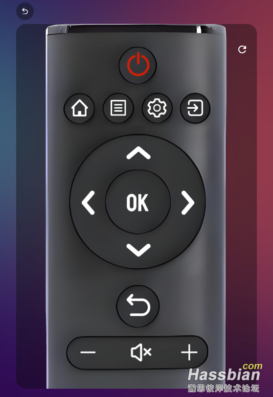

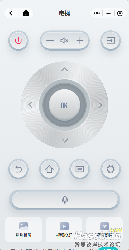

目前海信爱家小程序有虚拟遥控器界面,可以通过手机来控制电视,目前控制功能还未写完,先做个遥控器的UI,让各位老爷们看看吧。
小程序的遥控器界面如下:

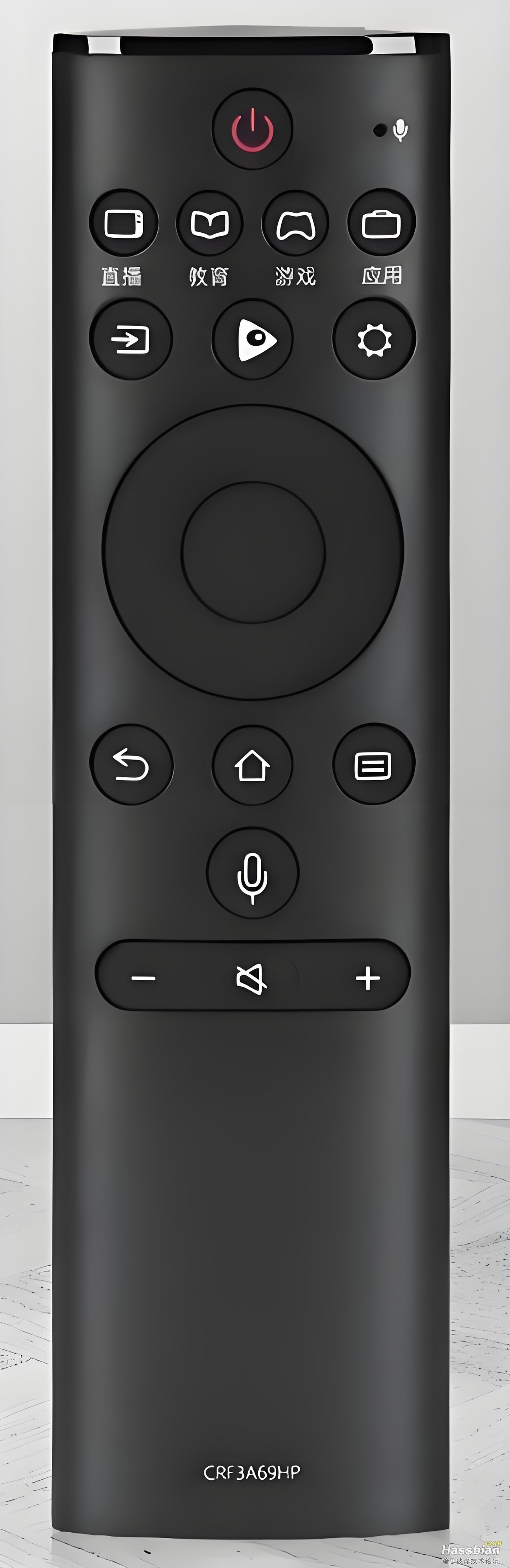

物理遥控器的样式如下:
因为小程序中的遥控器功能不如物理遥控器的多,比如“直播、教育、游戏”等功能在小程序上没有,抓的包中也没有以上功能的控制接口,所以我就已小程序的遥控器功能为准做了以下UI。
此UI支持“电源键、主页、菜单、设置、信号源、确认、上下左右、返回、音量+ -、静音”功能。
此UI的底图是用物理遥控器照片通过PS进行调整得来的,具体代码如下,图片请见附件。
type: vertical-stack
cards:
  - type: vertical-stack
    cards:
      - type: picture-elements
        image: /local/电视遥控器/遥控器.png
        elements:
          - type: icon
            entity: button.dian_shi_shua_xin_an_niu
            tap_action:
              action: toggle
            content_info: none
            icon: mdi:refresh
            style:
              top: 7%
              left: 94%
          - type: image
            image: /local/电视遥控器/开关键.png
            style:
              top: 11%
              left: 51%
              width: 10%
            tap_action:
              action: toggle
            hold_action:
              action: none
          - type: image
            image: /local/电视遥控器/主页.png
            style:
              top: 23%
              left: 26.5%
              width: 7%
            tap_action:
              action: toggle
          - type: image
            image: /local/电视遥控器/菜单.png
            style:
              top: 23%
              left: 42.5%
              width: 7%
            tap_action:
              action: toggle
          - type: image
            image: /local/电视遥控器/设置.png
            style:
              top: 23%
              left: 58.7%
              width: 11%
            tap_action:
              action: toggle
          - type: image
            image: /local/电视遥控器/信号源.png
            style:
              top: 23%
              left: 74.5%
              width: 8%
            tap_action:
              action: toggle
          - type: image
            image: /local/电视遥控器/上.png
            style:
              top: 35.3%
              left: 51%
              width: 15%
            tap_action:
              action: toggle
          - type: image
            image: /local/电视遥控器/下.png
            style:
              top: 62%
              left: 51%
              width: 15%
            tap_action:
              action: toggle
          - type: image
            image: /local/电视遥控器/左.png
            style:
              top: 49%
              left: 30%
              width: 15%
            tap_action:
              action: toggle
          - type: image
            image: /local/电视遥控器/右.png
            style:
              top: 49%
              left: 71.5%
              width: 15%
            tap_action:
              action: toggle
          - type: image
            image: /local/电视遥控器/确认.png
            style:
              top: 49%
              left: 50.5%
              width: 17%
            tap_action:
              action: toggle
          - type: image
            image: /local/电视遥控器/返回.png
            style:
              top: 77%
              left: 51%
              width: 12%
            tap_action:
              action: toggle
          - type: image
            image: /local/电视遥控器/加号.png
            style:
              top: 90%
              left: 72%
              width: 8%
            tap_action:
              action: toggle
          - type: image
            image: /local/电视遥控器/减号.png
            style:
              top: 90%
              left: 30%
              width: 8%
            tap_action:
              action: toggle
          - type: image
            image: /local/电视遥控器/静音.png
            style:
              top: 90%
              left: 52%
              width: 10%
            tap_action:
              action: toggle
