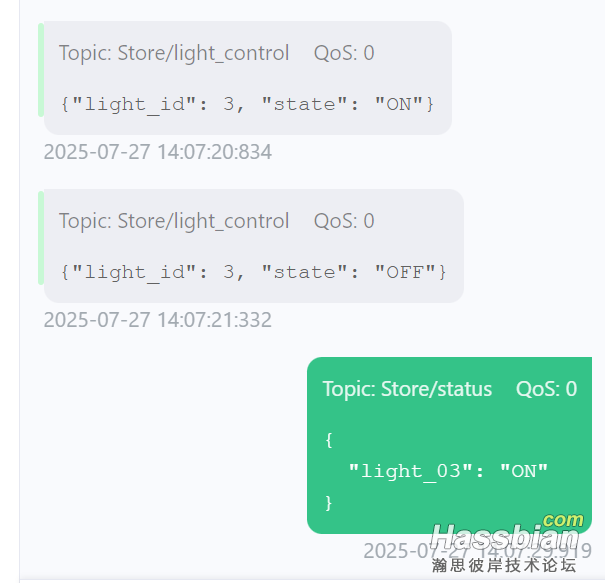

mqtt:
  - light:
      schema: template
      unique_id: shop_light_counter_3
      command_topic: "Store/light_control"
      state_topic: "Store/status"
      command_on_template: '{"light_id": 3, "state": "ON"}'
      command_off_template: '{"light_id": 3, "state": "OFF"}'
      state_template: "{{ value_json.light_03 | lower == 'on' or value_json.light_03 == '1' }}"
      optimistic: false
      retain: true
这是代码段

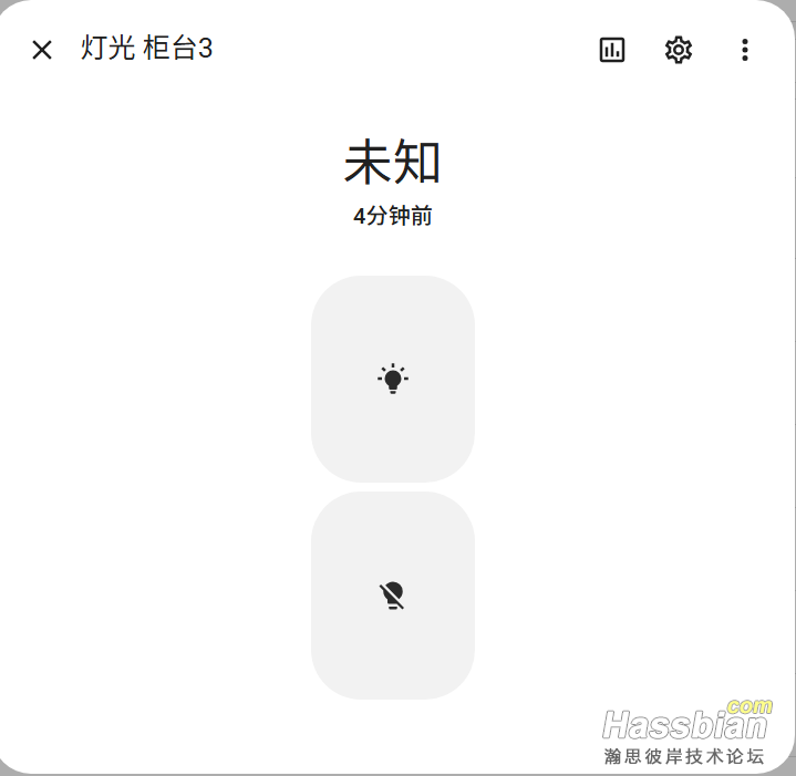

发送命令正常,但无法识别来修改状态,大佬们应该如何修改

ha最新版的mqtt已经支持UI配置了,可以尝试一下
