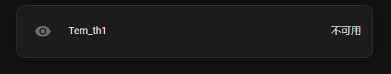

  - type: tcp
    host: 192.168.32.10
    port: 8899
    sensors:
      - name: "Tem_th1"
        slave: 1
        address: 0x0000
        unit_of_measurement: °C
        precision: 1
        scale: 0.1
        data_type: float16
        unique_id: "2025072201"
然后实体一直显示不可用

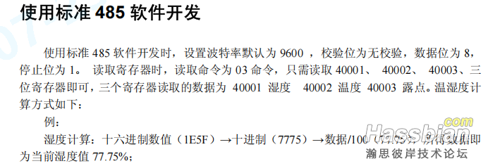

这是温湿度仪厂家给的说明
串口服务器设置也没啥问题,各位大佬看下是哪里有问题?
