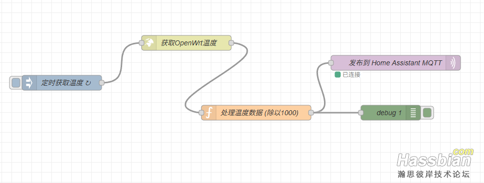

第三步nodered生成流,请在mqtt  out 节点修改对应的mqtt服务器用户名和密码

        "id": "4e46d03797b743c4",
        "type": "tab",
        "label": "路由器温度",
        "disabled": false,
        "info": "",
        "env": []
        "id": "e0a2b1c3d4e5f6a7b8c9d0e1f2a3b4c5",
        "type": "inject",
        "z": "4e46d03797b743c4",
        "name": "定时获取温度",
        "props": [
                "p": "payload"
                "p": "topic",
                "vt": "str"
        "repeat": "20",
        "crontab": "",
        "once": true,
        "onceDelay": 0.1,
        "topic": "",
        "payload": "",
        "payloadType": "date",
        "x": 300,
        "y": 320,
        "wires": [
                "f1a2b3c4d5e6f7a8b9c0d1e2f3a4b5c6"
        "id": "f1a2b3c4d5e6f7a8b9c0d1e2f3a4b5c6",
        "type": "http request",
        "name": "获取OpenWrt温度",
        "method": "GET",
        "ret": "txt",
        "paytoqs": "ignore",
        "url": "http://192.168.1.1/cgi-bin/temp",
        "tls": "",
        "persist": false,
        "proxy": "",
        "insecureHTTPParser": false,
        "authType": "",
        "senderr": false,
        "headers": [],
        "x": 550,
        "y": 240,
        "wires": [
                "a2b3c4d5e6f7a8b9c0d1e2f3a4b5c6d7"
        "id": "a2b3c4d5e6f7a8b9c0d1e2f3a4b5c6d7",
        "type": "function",
        "name": "处理温度数据 (除以1000)",
        "func": "let rawTemp = parseInt(msg.payload);\n\nif (isNaN(rawTemp)) {\n    node.warn(\"接收到的温度数据无效: \" + msg.payload);\n    // 如果获取到的不是有效数字,则不向下传递消息\n    return null; \n}\n\n// 将原始整数值除以 1000 得到实际温度 (例如 43300 -> 43.3)\nlet actualTemp = rawTemp / 1000;\n\n// 构建 Home Assistant 期望的 JSON 格式\nmsg.payload = {\n    \"temperature\": actualTemp,\n    \"unit\": \"°C\"\n};\nreturn msg;",
        "outputs": 1,
        "timeout": "",
        "noerr": 0,
        "initialize": "",
        "finalize": "",
        "libs": [],
        "x": 690,
        "y": 380,
        "wires": [
                "c4d5e6f7a8b9c0d1e2f3a4b5c6d7e8f9",
                "eea95cde404912bd"
        "id": "c4d5e6f7a8b9c0d1e2f3a4b5c6d7e8f9",
        "type": "mqtt out",
        "name": "发布到 Home Assistant MQTT",
        "topic": "homeassistant/sensor/openwrt_cpu/state",
        "qos": "1",
        "retain": "true",
        "respTopic": "",
        "contentType": "",
        "userProps": "",
        "correl": "",
        "expiry": "",
        "broker": "16dbc903cbb78b24",
        "x": 970,
        "y": 280,
        "wires": []
        "id": "eea95cde404912bd",
        "type": "debug",
        "name": "debug 1",
        "active": true,
        "tosidebar": true,
        "console": false,
        "tostatus": false,
        "complete": "payload.temperature",
        "targetType": "jsonata",
        "statusVal": "",
        "statusType": "auto",
        "x": 960,
        "y": 380,
        "wires": []
        "id": "16dbc903cbb78b24",
        "type": "mqtt-broker",
        "name": "",
        "broker": "192.168.1.13",
        "port": 1883,
        "clientid": "",
        "autoConnect": true,
        "usetls": false,
        "protocolVersion": 4,
        "keepalive": 60,
        "cleansession": true,
        "autoUnsubscribe": true,
        "birthTopic": "",
        "birthQos": "1",
        "birthRetain": "true",
        "birthPayload": "",
        "birthMsg": {},
        "closeTopic": "",
        "closeQos": "0",
        "closeRetain": "false",
        "closePayload": "",
        "closeMsg": {},
        "willTopic": "",
        "willQos": "0",
        "willRetain": "false",
        "willPayload": "",
        "willMsg": {},
        "userProps": "",
        "sessionExpiry": ""
