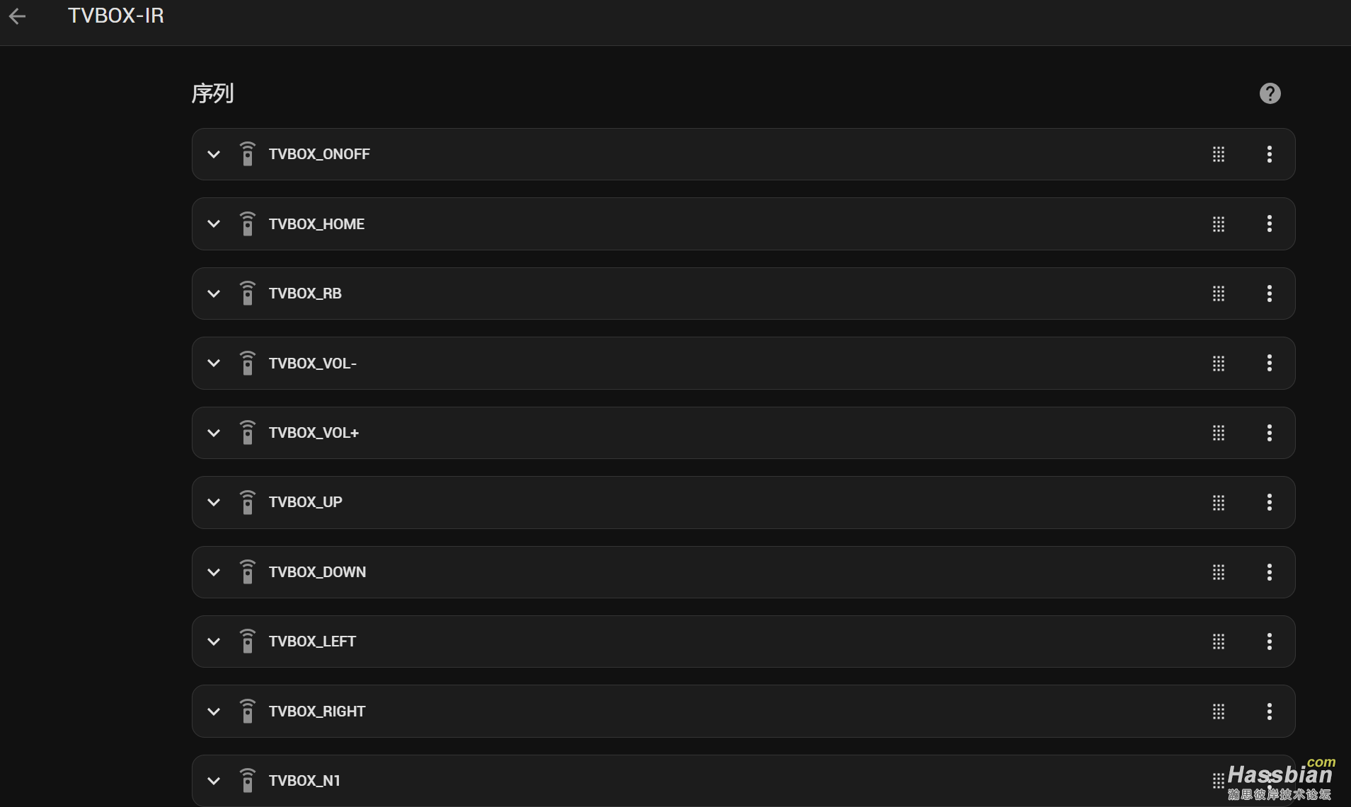

电视机顶盒通过涂鸦发红外传感器,把各个配对码已经弄出来在脚本里面去了。现在怎样转换成实体按键呢?有开关机,有数字按键,怎样弄成?
tvbox_ir:
  sequence:
  - action: remote.send_command
    metadata: {}
    data:
      num_repeats: 1
      delay_secs: 0.4
      hold_secs: 0
      device: TVBOX
      command: ONOFF
    target:
      entity_id: remote.tuya_ir_remote_control
    alias: TVBOX_ONOFF
    metadata: {}
    data:
      num_repeats: 1
      delay_secs: 0.4
      hold_secs: 0
      device: TVBOX
      command: HOME
    target:
    alias: TVBOX_HOME
    metadata: {}
    data:
      num_repeats: 1
      delay_secs: 0.4
      hold_secs: 0
      device: TVBOX
      command: RB
    target:
    alias: TVBOX_RB
    metadata: {}
    data:
      num_repeats: 1
      delay_secs: 0.4
      hold_secs: 0
      device: TVBOX
      command: VOL-
    target:
    alias: TVBOX_VOL-
    metadata: {}
    data:
      num_repeats: 1
      delay_secs: 0.4
      hold_secs: 0
      device: TVBOX
      command: VOL+
    target:
    alias: TVBOX_VOL+
    metadata: {}
    data:
      num_repeats: 1
      delay_secs: 0.4
      hold_secs: 0
      device: TVBOX
      command: UP
    target:
    alias: TVBOX_UP
    metadata: {}
    data:
      num_repeats: 1
      delay_secs: 0.4
      hold_secs: 0
      device: TVBOX
      command: DOWN
    target:
    alias: TVBOX_DOWN
    metadata: {}
    data:
      num_repeats: 1
      delay_secs: 0.4
      hold_secs: 0
      device: TVBOX
      command: LEFT
    target:
    alias: TVBOX_LEFT
    metadata: {}
    data:
      num_repeats: 1
      delay_secs: 0.4
      hold_secs: 0
      device: TVBOX
      command: RIGHT
    target:
    alias: TVBOX_RIGHT
    metadata: {}
    data:
      num_repeats: 1
      delay_secs: 0.4
      hold_secs: 0
      device: TVBOX
      command: 1
    target:
    alias: TVBOX_N1
    metadata: {}
    data:
      num_repeats: 1
      delay_secs: 0.4
      hold_secs: 0
      device: TVBOX
      command: 2
    target:
    alias: TVBOX_N2
    metadata: {}
    data:
      num_repeats: 1
      delay_secs: 0.4
      hold_secs: 0
      device: TVBOX
      command: 3
    target:
    alias: TVBOX_N3
    metadata: {}
    data:
      num_repeats: 1
      delay_secs: 0.4
      hold_secs: 0
      device: TVBOX
      command: 4
    target:
    alias: TVBOX_N4
    metadata: {}
    data:
      num_repeats: 1
      delay_secs: 0.4
      hold_secs: 0
      device: TVBOX
      command: 5
    target:
    alias: TVBOX_N5
    metadata: {}
    data:
      num_repeats: 1
      delay_secs: 0.4
      hold_secs: 0
      device: TVBOX
      command: 6
    target:
    alias: TVBOX_N6
    metadata: {}
    data:
      num_repeats: 1
      delay_secs: 0.4
      hold_secs: 0
      device: TVBOX
      command: 7
    target:
    alias: TVBOX_N7
    metadata: {}
    data:
      num_repeats: 1
      delay_secs: 0.4
      hold_secs: 0
      device: TVBOX
      command: 8
    target:
    alias: TVBOX_N8
    metadata: {}
    data:
      num_repeats: 1
      delay_secs: 0.4
      hold_secs: 0
      device: TVBOX
      command: 9
    target:
    alias: TVBOX_N9
    metadata: {}
    data:
      num_repeats: 1
      delay_secs: 0.4
      hold_secs: 0
      device: TVBOX
      command: 0
    target:
    alias: TVBOX_N0
  alias: TVBOX-IR
  description: ''

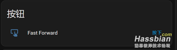

 楼主| 发表于 2025-6-28 12:08:50 | 显示全部楼层
按键模式,可以是上下左右这种按键,
但开机按键想要这种能够变色的滑动块?
另外涂鸦的RF在home assistant里面怎样获取学习? tuyaIR remote control插件好像是不支持的
template:
  - button:
      - name: Fast Forward
        press:
          target:
          data:
            device: TV
            command: on off
