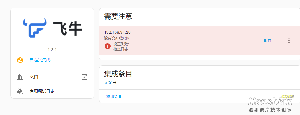

发表于 2025-7-4 17:11:31 | 显示全部楼层
Raylo 发表于 2025-7-4 17:06
刚刚连接上了 可能要多等待下 之前试了两次都不成功
我就是1.3.1,,,这个错误,头大,比较菜,,那个SSH也不知道怎么弄

发表于 2025-7-4 17:13:01 | 显示全部楼层
日志记录器: homeassistant.config_entries
来源: config_entries.py:640
首次出现: 17:03:51 (1 次总计出现)
上次记录: 17:03:51
Error setting up entry 192.168.31.201 for fn_nas
  File "/config/custom_components/fn_nas/coordinator.py", line 183, in run_command
    conn = await self.get_ssh_connection()
  File "/config/custom_components/fn_nas/coordinator.py", line 104, in get_ssh_connection
    return await self.get_ssh_connection()
  [Previous line repeated 972 more times]
  File "/config/custom_components/fn_nas/coordinator.py", line 103, in get_ssh_connection
    await asyncio.sleep(0.1)
  File "/usr/local/lib/python3.13/asyncio/tasks.py", line 714, in sleep
    h = loop.call_later(delay,
                        futures._set_result_unless_cancelled,
                        future, result)
  File "/usr/local/lib/python3.13/asyncio/base_events.py", line 795, in call_later
    timer = self.call_at(self.time() + delay, callback, *args,
                         context=context)
  File "/usr/local/lib/python3.13/asyncio/base_events.py", line 812, in call_at
    timer = events.TimerHandle(when, callback, args, self, context)
  File "/usr/local/lib/python3.13/asyncio/events.py", line 114, in __init__
    super().__init__(callback, args, loop, context)
  File "/usr/local/lib/python3.13/asyncio/events.py", line 45, in __init__
    if self._loop.get_debug():
RecursionError: maximum recursion depth exceeded
