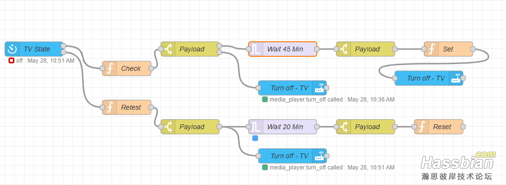

已实现的功能:电视机持续播放XX分钟后,强制关闭,并且必需等待XX分钟后,才能继续开启。
1、自定义电视机持续播放的时间(设置trigger节点对应的时间间隔)
2、自定义电视机休息的时间(设置trigger节点对应的时间间隔)
3、休息时间未达到,强制开机,5秒后强制关机(5秒可在第一个节点中自行设置,建议最短不要小于3秒)
4、未使用global变量,而是使用的flow变量,重新部署后会全部初始化(可自行改为global变量,即使重新部署也会持续状态。)
未实现的功能:未超过持续播放时间,中途关闭后,下次继续打开,不能继续上次的计时
流程图如下:
完整Json如下:

希望有大神能帮忙完善,感谢。

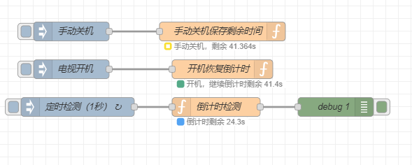

发表于 2025-5-28 16:50:42 | 显示全部楼层
我写一个Demo应该符合你的逻辑,请参考。
[{"id":"1a2b3c4d5e6f7g8h","type":"tab","label":"倒计时测试模板","disabled":false,"info":""},{"id":"manual_off","type":"inject","z":"1a2b3c4d5e6f7g8h","name":"手动关机","props":[],"repeat":"","crontab":"","once":false,"onceDelay":0.1,"topic":"","payloadType":"date","x":120,"y":80,"wires":[["manual_off_func"]]},{"id":"manual_off_func","type":"function","z":"1a2b3c4d5e6f7g8h","name":"手动关机保存剩余时间","func":"// 当前时间\nconst now = Date.now();\n// 获取倒计时结束时间\nconst endTime = flow.get('countdownEndTime') || 0;\n\nif(endTime > now){\n    const remaining = endTime - now;\n    flow.set('countdownRemaining', remaining);\n    node.status({fill:'yellow',shape:'ring',text:`手动关机,剩余 ${remaining/1000}s`});\n    node.warn(`手动关机,保存剩余时间 ${remaining} 毫秒`);\n}else{\n    flow.set('countdownRemaining', 0);\n    node.status({fill:'grey',shape:'dot',text:'无剩余时间'});\n}\nflow.set('countdownEndTime', 0);\nreturn null;","outputs":0,"timeout":"","noerr":0,"initialize":"","finalize":"","libs":[],"x":360,"y":80,"wires":[]},{"id":"tv_on","type":"inject","z":"1a2b3c4d5e6f7g8h","name":"电视开机","props":[],"repeat":"","crontab":"","once":false,"onceDelay":0.1,"topic":"","x":120,"y":140,"wires":[["tv_on_func"]]},{"id":"tv_on_func","type":"function","z":"1a2b3c4d5e6f7g8h","name":"开机恢复倒计时","func":"const now = Date.now();\nlet remaining = flow.get('countdownRemaining') || 0;\nif(remaining > 0){\n    flow.set('countdownEndTime', now + remaining);\n    flow.set('countdownRemaining', 0);\n    node.status({fill:'green',shape:'dot',text:`开机,继续倒计时剩余 ${(remaining/1000).toFixed(1)}s`});\n    node.warn(`开机,继续倒计时剩余 ${remaining} 毫秒`);\n}else{\n    const defaultTime = 60 * 1000;\n    flow.set('countdownEndTime', now + defaultTime);\n    node.warn('开机,启动60秒新倒计时');\n}\nreturn null;","outputs":0,"timeout":"","noerr":0,"initialize":"","finalize":"","libs":[],"x":360,"y":140,"wires":[]},{"id":"countdown_check_inject","type":"inject","z":"1a2b3c4d5e6f7g8h","name":"定时检测(1秒)","props":[],"repeat":"1","crontab":"","once":true,"onceDelay":"1","topic":"","x":130,"y":200,"wires":[["countdown_check_func"]]},{"id":"countdown_check_func","type":"function","z":"1a2b3c4d5e6f7g8h","name":"倒计时检测","func":"const now = Date.now();\nconst endTime = flow.get('countdownEndTime') || 0;\n\nif(endTime !== 0 && now >= endTime){\n    flow.set('countdownEndTime', 0);\n    flow.set('countdownRemaining', 0);\n    node.status({fill:'red',shape:'dot',text:'倒计时结束,自动关机'});\n    node.warn('倒计时结束,自动关闭电视');\n    return {payload: '自动关机'};\n}else if(endTime !== 0){\n    const left = ((endTime - now)/1000).toFixed(1);\n    node.status({fill:'blue',shape:'dot',text:`倒计时剩余 ${left}s`});\n    return {payload: `倒计时剩余 ${left} 秒`};\n}\n","outputs":1,"timeout":"","noerr":0,"initialize":"","finalize":"","libs":[],"x":350,"y":200,"wires":[["0decc9c6affb810c"]]},{"id":"0decc9c6affb810c","type":"debug","z":"1a2b3c4d5e6f7g8h","name":"debug 1","active":true,"tosidebar":true,"console":false,"tostatus":false,"complete":"false","statusVal":"","statusType":"auto","x":540,"y":200,"wires":[]}]
104
764
764
657
发表于 2025-5-28 16:51:46 | 显示全部楼层
卡了!!!只保留上一帖子。
