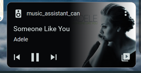

发表于 2025-5-21 11:56:51 | 显示全部楼层
可以的,界面控制,你在ha界面上,添加ma的播放器就行了。自动化参考这个,播放列表
target:
  entity_id: media_player.music_assistant_can
data:
  media_content_id: library://playlist/8
  media_content_type: music
metadata:
  title: Adele
  thumbnail: null
  media_class: playlist
  children_media_class: null
  navigateIds:
    - media_content_type: music_assistant
      media_content_id: playlists
action: media_player.play_media
