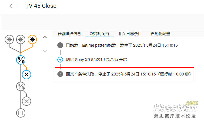

 楼主| 发表于 2025-5-24 15:12:14 | 显示全部楼层
hhh. 发表于 2025-5-24 14:32
我使用插座实体测试没问题的。
你把自动化贴出来看看。

发表于 2025-5-24 16:58:49 | 显示全部楼层
wolfcdd 发表于 2025-5-24 15:12
我怎么调试到底是什么条件导致运行失败呢。
首先时间触发器只是作为一个冗余,10分钟就可以了,秒级没必要。
其次media_player.sony_xr_55x91j 这个实体能做到毫秒级的响应能力吗?
状态更新延迟如何呢?
如果做不到就增加时间延迟:
alias: TV 45 Close
description: ""
triggers:
  - trigger: state
    entity_id:
      - media_player.sony_xr_55x91j
    from: null
    to: "on"
    for:
      hours: 0
      minutes: 45
      seconds: 10
  - trigger: state
    entity_id:
    from: null
    to: "on"
    for:
      hours: 0
      minutes: 0
      seconds: 20
  - trigger: time_pattern
    minutes: /10
conditions:
  - condition: state
    entity_id: media_player.sony_xr_55x91j
    state: "on"
  - condition: or
    conditions:
      - condition: state
        state: "on"
        for:
          hours: 0
          minutes: 45
          seconds: 0
      - condition: not
        conditions:
          - condition: state
            state: "off"
            for:
              hours: 0
              minutes: 20
              seconds: 0
actions:
  - delay:
      hours: 0
      minutes: 0
      seconds: 10
      milliseconds: 0
  - type: turn_off
    device_id: 1994afab4d04741fff3d17a580d865f0
    entity_id: c07746ab64755844713d7bf852b24b63
    domain: remote
mode: single
调试结果很明显:时间触发器触发,根据环境条件 sony_xr_55x91j  未开启。 所以自动化停止。
还有代码照抄即可,干嘛要更改一些你不懂的东西?
