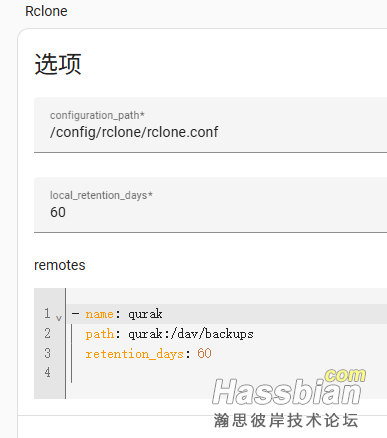

大佬们,我在冬瓜haos上安装了插件rclone,准备把夸克网盘挂载到本地,研究实操了几天,rclone配置好了并且路径填写的http://ip:5244/dav,
alist上webdav也配置好了夸克网盘挂载路径/dav。
使用命令“curl -X PROPFIND”能读取到夸克网盘上的文件。启动后rclone插件后,运行一会插件就停止运行,
查看日志:
2025/05/07 10:32:22 ERROR : Automatic_backup_2025.4.4_2025-05-07_04.54_34006288.tar: Failed to copy: Not Found: 404 Not Found
2025/05/07 10:32:22 ERROR : Automatic_backup_2025.4.4_2025-05-06_18.57_47253149.tar: Failed to copy: Not Found: 404 Not Found
2025/05/07 10:32:22 ERROR : Attempt 1/3 failed with 2 errors and: Not Found: 404 Not Found
2025/05/07 10:32:23 ERROR : Automatic_backup_2025.4.4_2025-05-07_04.54_34006288.tar: Failed to copy: Not Found: 404 Not Found
2025/05/07 10:32:23 ERROR : Automatic_backup_2025.4.4_2025-05-06_18.57_47253149.tar: Failed to copy: Not Found: 404 Not Found
2025/05/07 10:32:23 ERROR : Attempt 2/3 failed with 2 errors and: Not Found: 404 Not Found
2025/05/07 10:32:24 ERROR : Automatic_backup_2025.4.4_2025-05-06_18.57_47253149.tar: Failed to copy: Not Found: 404 Not Found
2025/05/07 10:32:25 ERROR : Automatic_backup_2025.4.4_2025-05-07_04.54_34006288.tar: Failed to copy: Not Found: 404 Not Found
2025/05/07 10:32:25 ERROR : Attempt 3/3 failed with 2 errors and: Not Found: 404 Not Found
2025/05/07 10:32:25 INFO  :
Transferred:               5.602 MiB / 5.602 MiB, 100%, 1.867 MiB/s, ETA 0s
Errors:                 2 (retrying may help)
Elapsed time:         3.1s
2025/05/07 10:32:25 NOTICE: Failed to sync with 2 errors: last error was: Not Found: 404 Not Found

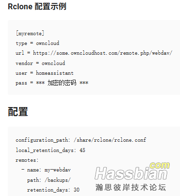

参照示例配置了rclone.conf
参照示例配置了rclone.conf
参照示例配置了rclone.conf
