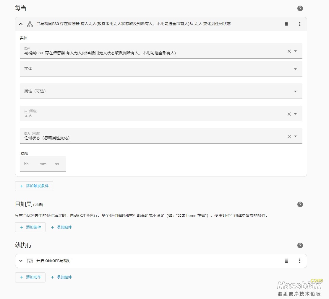

想设置成,从任何状态判断成无人,且状态不等于‘有人12’

发表于 2025-5-6 10:11:15 | 显示全部楼层
且如果:
这个地方添加环境条件
如:
添加组件:非
添加实体,判断实体是否为有人。
如果状态=有人,那么不执行。状态=其它,执行。
示例:
description: ""
mode: single
triggers:
  - trigger: state
    entity_id:
      - binary_sensor.shu_fang_ren_ti_jian_ce
    from: null
    to: "on"
conditions:
  - condition: not
    conditions:
      - condition: state
        entity_id: binary_sensor.shu_fang_ren_ti_jian_ce
        state: "off"
actions: []
