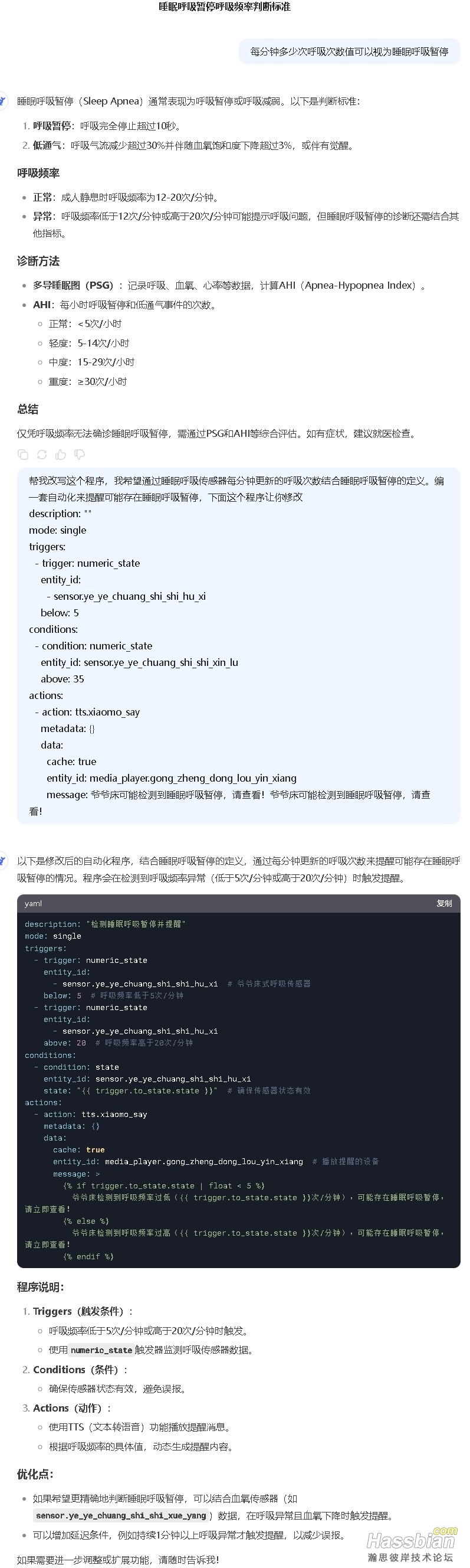

description: "检测睡眠呼吸暂停并提醒(持续1分钟以上异常)"
mode: single
triggers:
  - trigger: numeric_state
    entity_id:
      - sensor.ye_ye_chuang_shi_shi_hu_xi  # 爷爷床式呼吸传感器
    below: 5  # 呼吸频率低于5次/分钟
    for:
      minutes: 1  # 持续1分钟以上
    entity_id:
    above: 20  # 呼吸频率高于20次/分钟
    for:
conditions:
  - condition: state
    entity_id: sensor.ye_ye_chuang_shi_shi_hu_xi
    state: "{{ trigger.to_state.state }}"  # 确保传感器状态有效
actions:
  - action: tts.xiaomo_say
    metadata: {}
    data:
      cache: true
      entity_id: media_player.gong_zheng_dong_lou_yin_xiang  # 播放提醒的设备
      message: >
        {% if trigger.to_state.state | float < 5 %}
          爷爷床检测到呼吸频率过低({{ trigger.to_state.state }}次/分钟),持续1分钟以上,可能存在睡眠呼吸暂停,请立即查看!
        {% else %}
          爷爷床检测到呼吸频率过高({{ trigger.to_state.state }}次/分钟),持续1分钟以上,可能存在睡眠呼吸暂停,请立即查看!
        {% endif %}
