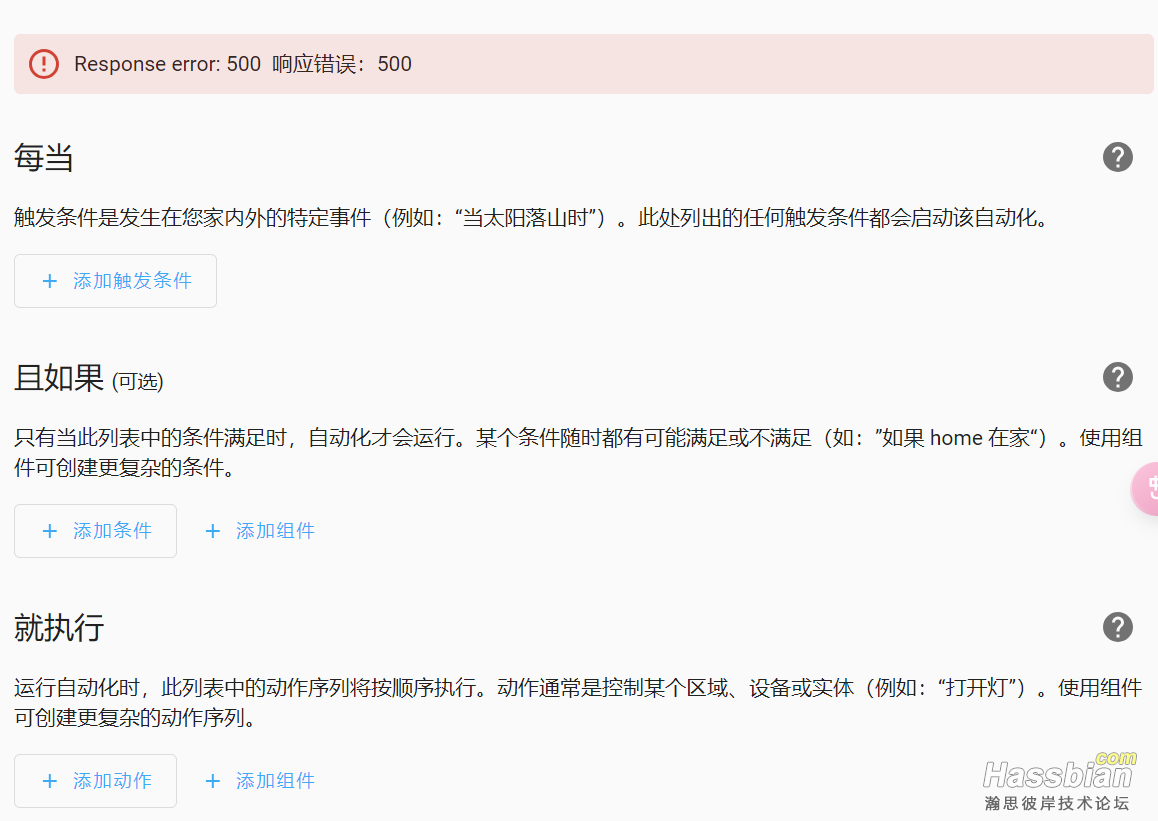

出现这个错误,并且现有的自动化,也不能正常工作了
日志报错
日志记录器: aiohttp.server
来源: /usr/local/lib/python3.12/site-packages/aiohttp/web_protocol.py:448
首次出现: 22:03:44 (16 次总计出现)
上次记录: 22:29:55
Error handling request
  File "/usr/local/lib/python3.12/site-packages/aiohttp/web_protocol.py", line 477, in _handle_request
    resp = await request_handler(request)
  File "/usr/local/lib/python3.12/site-packages/aiohttp/web_app.py", line 567, in _handle
    return await handler(request)
  File "/usr/local/lib/python3.12/site-packages/aiohttp/web_middlewares.py", line 117, in impl
  File "/usr/src/homeassistant/homeassistant/components/http/security_filter.py", line 92, in security_filter_middleware
  File "/usr/src/homeassistant/homeassistant/components/http/forwarded.py", line 83, in forwarded_middleware
  File "/usr/src/homeassistant/homeassistant/components/http/request_context.py", line 26, in request_context_middleware
  File "/usr/src/homeassistant/homeassistant/components/http/ban.py", line 86, in ban_middleware
  File "/usr/src/homeassistant/homeassistant/components/http/auth.py", line 242, in auth_middleware
  File "/usr/src/homeassistant/homeassistant/components/http/headers.py", line 32, in headers_middleware
    response = await handler(request)
  File "/usr/src/homeassistant/homeassistant/helpers/http.py", line 73, in handle
    result = await handler(request, **request.match_info)
  File "/usr/src/homeassistant/homeassistant/components/http/decorators.py", line 81, in with_admin
    return await func(self, request, *args, **kwargs)
  File "/usr/src/homeassistant/homeassistant/components/config/view.py", line 134, in post
    await hass.async_add_executor_job(_write, path, current)
  File "/usr/local/lib/python3.12/concurrent/futures/thread.py", line 58, in run
    result = self.fn(*self.args, **self.kwargs)
  File "/usr/src/homeassistant/homeassistant/components/config/view.py", line 251, in _write
    write_utf8_file_atomic(path, contents)
  File "/usr/src/homeassistant/homeassistant/util/file.py", line 39, in write_utf8_file_atomic
    fdesc.write(utf8_data)
UnicodeEncodeError: 'ascii' codec can't encode characters in position 31-36: ordinal not in range(128)

发表于 2025-3-7 22:45:07 | 显示全部楼层
删除所有中文自动化

 楼主| 发表于 2025-3-7 22:52:55 | 显示全部楼层
xhily 发表于 2025-3-7 22:45
删除所有中文自动化
选择删除后,没反应。自动化还是存在

发表于 2025-3-8 10:55:36 | 显示全部楼层
偶尔 可以保存。不晓得为什么 升级core 2.0 就有这个问题,一直没有解决

发表于 2025-3-17 15:19:09 | 显示全部楼层
我也是这个问题!!
