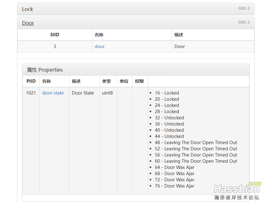

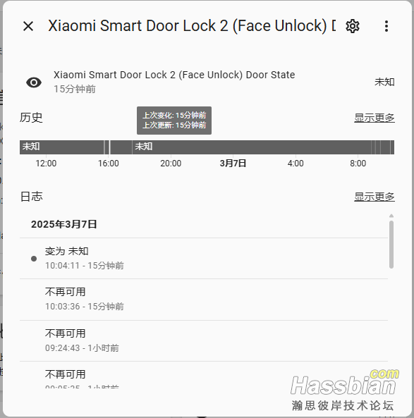

我在spec列表(https://home.miot-spec.com/spec/loock.lock.t3pmax)中看到了door相关的参数,但是在gateway3中按照3.p.1021配置后状态还是未知。这个是为什么呢,有大佬知道吗?

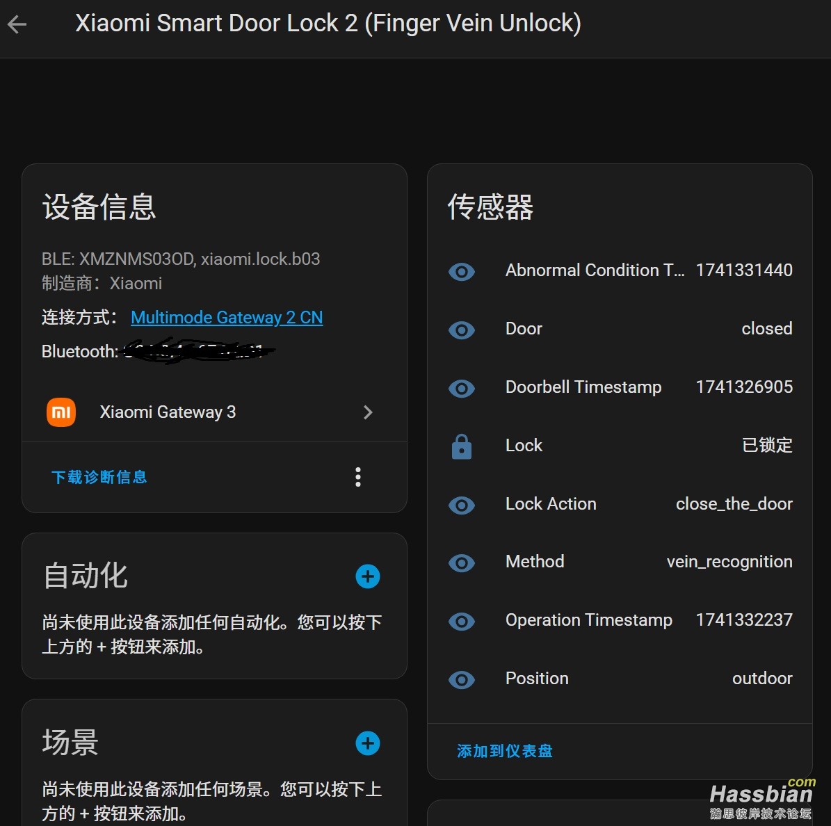

发表于 2025-3-7 15:39:32 | 显示全部楼层
同款锁,只不过我的是指静脉版的,我自己写了一个配置文件基本功能都可以实现了,楼主可以把你的配置贴出来,让大家帮你看看吧。下面是我的截图:

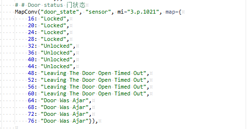

 楼主| 发表于 2025-3-11 18:48:08 | 显示全部楼层
qjrxsoft 发表于 2025-3-7 15:39
同款锁,只不过我的是指静脉版的,我自己写了一个配置文件基本功能都可以实现了,楼主可以把你的配置贴出来 ...
谢谢,这是我的代码

        # # Door status 门状态
        MapConv("door_state", "sensor", mi="3.e.1021", map={
            16: "Locked",
            20: "Locked",
            24: "Locked",
            28: "Locked",
            32: "Unlocked",
            36: "Unlocked",
            40: "Unlocked",
            44: "Unlocked",
            48: "Leaving The Door Open Timed Out",
            52: "Leaving The Door Open Timed Out",
            56: "Leaving The Door Open Timed Out",
            60: "Leaving The Door Open Timed Out",
            64: "Door Was Ajar",
            68: "Door Was Ajar",
            72: "Door Was Ajar",
            76: "Door Was Ajar"}),
