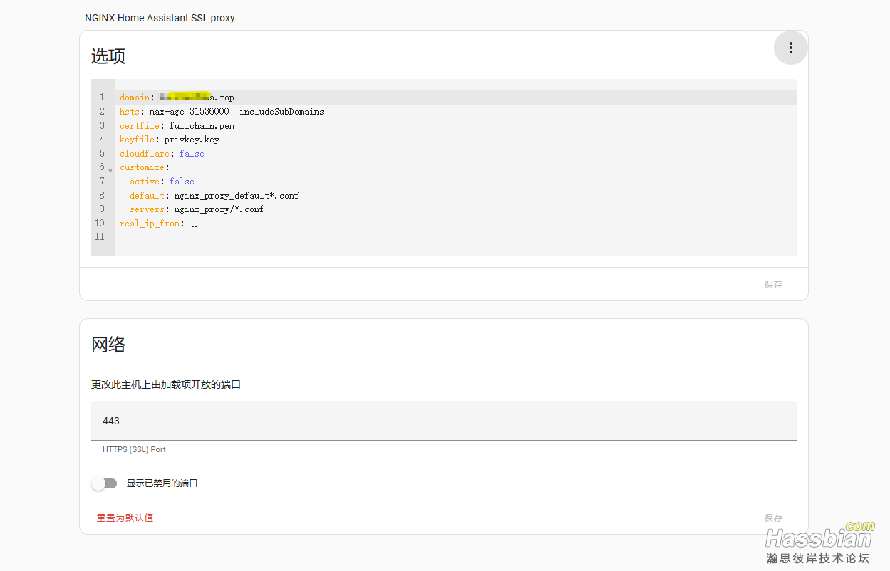

我是盒子刷的冬瓜大佬的OS本地已经是有公网的
第一个方法:用域名解析到公网IP可以用端口访问,但是无法https
第二个方法:试过duckdns,配置完也是可以访问,但是无法https
config那也修改了证书地址, 在下面也添加了http: ......的配置,重启后依旧无法https,不知道是不是duckdns版本太老了?
请问大哥们,有没有好用的能开启https的办法,先声明我不是docker版的版本。
下面这个配置换了不是443的端口也不行!
NGINX Home Assistant SSL proxy的日志
docker-default
s6-rc: info: service s6rc-oneshot-runner: starting
s6-rc: info: service s6rc-oneshot-runner successfully started
s6-rc: info: service fix-attrs: starting
s6-rc: info: service fix-attrs successfully started
s6-rc: info: service legacy-cont-init: starting
s6-rc: info: service legacy-cont-init successfully started
s6-rc: info: service nginx: starting
s6-rc: info: service nginx successfully started
s6-rc: info: service crond: starting
s6-rc: info: service crond successfully started
s6-rc: info: service legacy-services: starting
[19:33:05] INFO: Merging options & variables for template
s6-rc: info: service legacy-services successfully started
[19:33:05] INFO: Generating nginx.conf from template in /etc/nginx/nginx.conf.gtpl
[19:33:05] INFO: Generating dhparams (this will take some time)...
Generating DSA parameters, 4096 bit long prime
[19:33:37] INFO: Running nginx...
已经搞定了,用了万吉加载项,功能强大!!!!

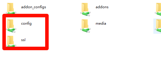

184
184
157
 楼主| 发表于 2025-3-2 18:25:33 | 显示全部楼层
他两不是同级目录吗?
