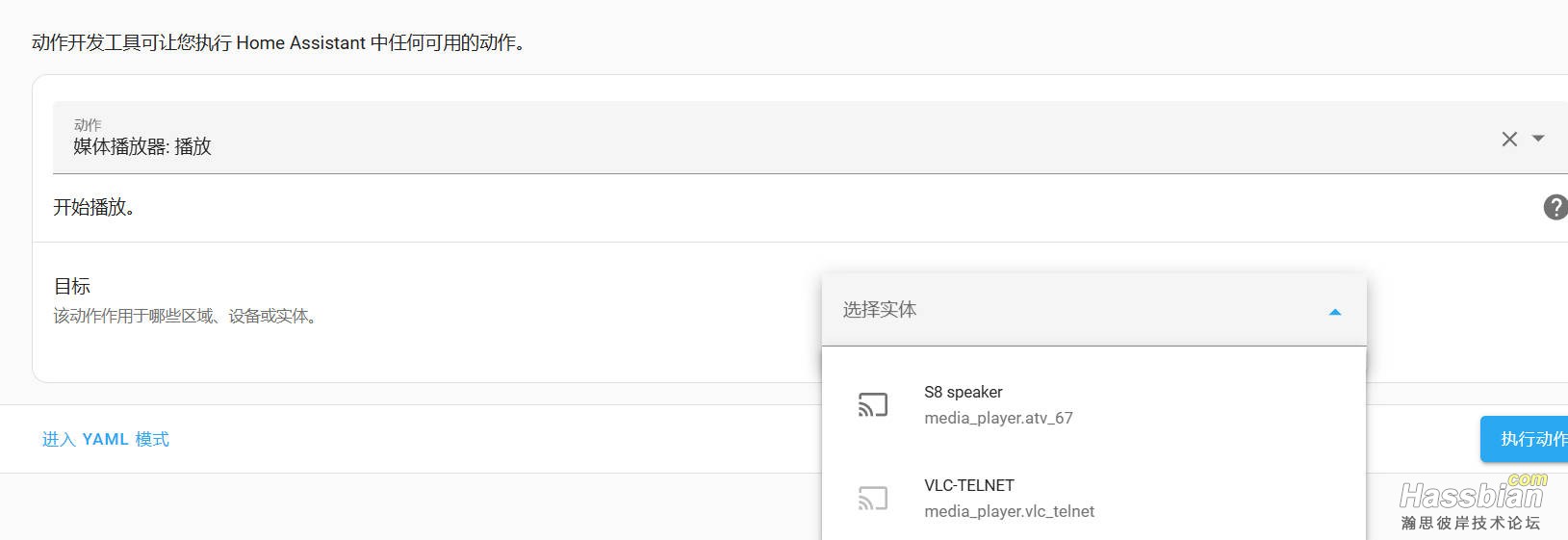

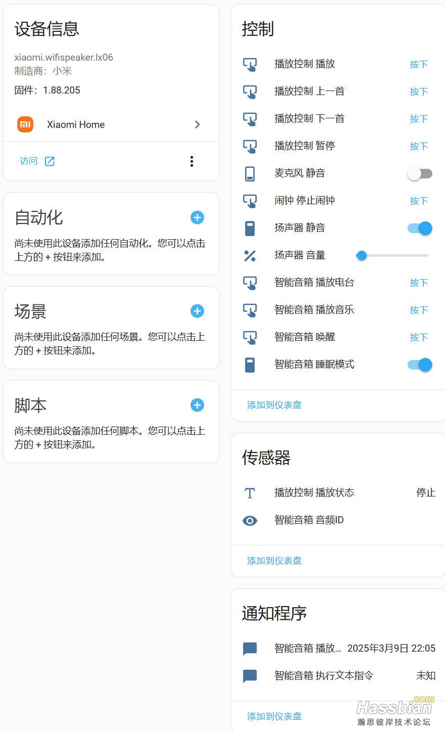

发表于 2025-3-9 22:12:07 | 显示全部楼层
entity_id: media_player.xiaomi_l05c_a7a4_play_control_2
entity_id: media_player.xiaoai_speaker

 楼主| 发表于 2025-3-17 00:29:32 | 显示全部楼层
请教 ...
一个是Xiaomi Miot Auto集成,一个是media_player.play_media`服务
