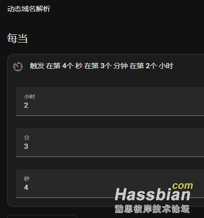

照猫画虎,automations.yaml用下面代码还可以在网页里面编辑更新时间或频率,要方便一些
- id: DDNS6
  alias: UpdateDDNS6
  description: 动态域名解析
  triggers:
  - trigger: time_pattern
    hours: '2'
    minutes: '3'
    seconds: '4'
  conditions: []
  actions:
  - action: shell_command.update_ddns
    data: {}
  mode: single
