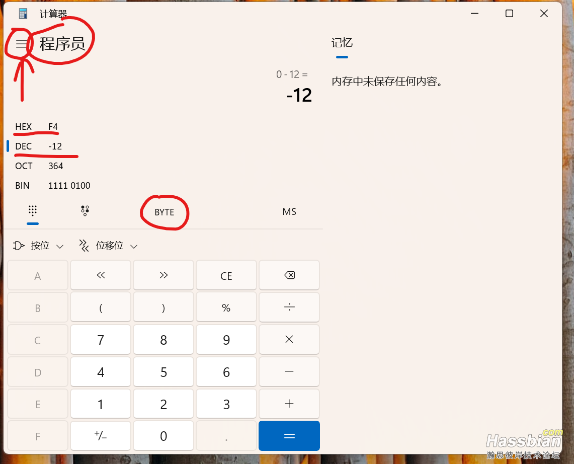

 楼主| 发表于 2025-7-29 20:15:42 | 显示全部楼层
goodheartman 发表于 2025-7-29 17:52
没有前辈以及大家的基础,也不可能有我目前的结果出来
后来的思路是把 MIOT 代码 (mi="5.e.1012.p.1") 转 ...
看样子你的版本没有把sint8和str类型的hex8直接做转换。
与其花时间研究这个,干嘛不直接把源代码给改了?试试这个?
如果还不行,你可以自己写测试文件的慢慢差错。不需要用实物按钮测试,AlexxIT自己也写了很多测试案例的。在这里找一个测试案例抄抄改改,跑一下就好了 https://github.com/AlexxIT/Xiaom ... ts/test_conv_ble.py
    # https://github.com/AlexxIT/XiaomiGateway3/pull/1303
    17825: ["Unknown", "Eight scene knob switch", "cxw.remote.ble006"],
    "spec": [
        # mibeacon2 spec
        BLEByteConv("battery", "sensor", mi=23555),  # uint8
        BaseConv("action", "sensor"), # uint8
        MapConv("action", mi=22028, map={"01": BUTTON_1_SINGLE, "02": BUTTON_2_SINGLE, "03": BUTTON_3_SINGLE, "04": BUTTON_4_SINGLE, "05": "button_5_single", "06": "button_6_single", "07": "button_7_single", "08": "button_8_single"}),
        MapConv("action", mi=22029, map={"01": BUTTON_1_DOUBLE, "02": BUTTON_2_DOUBLE, "03": BUTTON_3_DOUBLE, "04": BUTTON_4_DOUBLE, "05": "button_5_double", "06": "button_6_double", "07": "button_7_double", "08": "button_8_double"}),
        MapConv("action", mi=22030, map={"01": BUTTON_1_HOLD, "02": BUTTON_2_HOLD, "03": BUTTON_3_HOLD, "04": BUTTON_4_HOLD, "05": "button_5_hold", "06": "button_6_hold", "07": "button_7_hold", "08": "button_8_hold"}),
        BLENegativeConv("rotate", "sensor", mi=22052),
        MapConv("action", mi=22052, map={"f5": "knob_anticlockwise_after_toggling_button_1",
                                         "f4": "knob_anticlockwise_after_toggling_button_2",
                                         "f3": "knob_anticlockwise_after_toggling_button_3",
                                         "f2": "knob_anticlockwise_after_toggling_button_4",
                                         "f1": "knob_anticlockwise_after_toggling_button_5",
                                         "f0": "knob_anticlockwise_after_toggling_button_6",
                                         "ef": "knob_anticlockwise_after_toggling_button_7",
                                         "ee": "knob_anticlockwise_after_toggling_button_8",
                                         "0b": "knob_clockwise_after_toggling_button_1",
                                         "0c": "knob_clockwise_after_toggling_button_2",
                                         "0d": "knob_clockwise_after_toggling_button_3",
                                         "0e": "knob_clockwise_after_toggling_button_4",
                                         "0f": "knob_clockwise_after_toggling_button_5",
                                         "10": "knob_clockwise_after_toggling_button_6",
                                         "11": "knob_clockwise_after_toggling_button_7",
                                         "12": "knob_clockwise_after_toggling_button_8",
                                         "eb": "knob_anticlockwise_after_toggling_button_1_and_knob",
                                         "ea": "knob_anticlockwise_after_toggling_button_2_and_knob",
                                         "e9": "knob_anticlockwise_after_toggling_button_3_and_knob",
                                         "e8": "knob_anticlockwise_after_toggling_button_4_and_knob",
                                         "e7": "knob_anticlockwise_after_toggling_button_5_and_knob",
                                         "e6": "knob_anticlockwise_after_toggling_button_6_and_knob",
                                         "e5": "knob_anticlockwise_after_toggling_button_7_and_knob",
                                         "e4": "knob_anticlockwise_after_toggling_button_8_and_knob",
                                         "16": "knob_clockwise_after_toggling_button_1_and_knob",
                                         "17": "knob_clockwise_after_toggling_button_2_and_knob",
                                         "18": "knob_clockwise_after_toggling_button_3_and_knob",
                                         "19": "knob_clockwise_after_toggling_button_4_and_knob",
                                         "20": "knob_clockwise_after_toggling_button_5_and_knob",
                                         "21": "knob_clockwise_after_toggling_button_6_and_knob",
                                         "22": "knob_clockwise_after_toggling_button_7_and_knob",
                                         "23": "knob_clockwise_after_toggling_button_8_and_knob",}),
        # The knob in this device can be tuned clockwise and anti-clockwise. It can also be pressed.
        # The device does not report how much the knob is turned and only report one knob event per second.
        # However, the device remembers the previous state and report the previous state along with the knob event.
        # Such complex events are designed to map different clockwise/anti-clockwise knob events to each button, so users do not need to create dedicated state machine to track it.
        # e.g. a usecase is that button 1 controls the ceiling light and knob for its brightness. Button 2 controls lamps and knob for their brightness.
        #      When the knob is pressed, the knob events controls the temperature of these lights instead.
        # The toggling knob state will get reset after you press a different button
        # e.g. 1) press button_1 and turn knob -> knob_anti_clockwise_after_pressing_button_1
        #      2) press the knob and turn knob -> knob_anti_clockwise_after_toggling_knob_and_pressing_button_1
        #      3) press button_2 and turn knob -> knob_anti_clockwise_after_pressing_button_2
        # Therefore, if you only uses clockwise and anti-clockwise events on its own, you need to merge these events into two triggers in your automation.
    # "ttl": "6h"  # battery every 6 hours

goodheartman 发表于 2025-7-29 20:37
前辈不愧是高手一下就抓出我的毛病来,我刚刚也透过log档把每个负值的数值抓出来,跟您写的代码一模一样
HA就是个好玩的无底洞,总有新东西可以研究
十进制和十六进制换算以后不会的话,可以试试用windows或者mac自带的计算器,
选择程序员模式,
调成BYTE模式,就是1字节(8比特)显示
在DEC(十进制)里面输入负数,比如0-12=-12
它在HEX(十六进制)里面就会显示它用8个比特表示的十六进制的数值了。这里是F4
