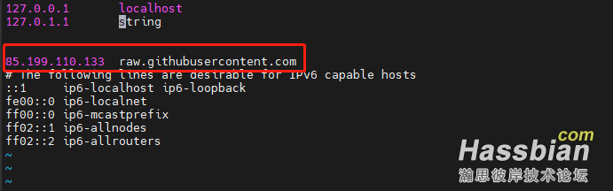

点保存后,将页面滑动到最上方,会让你下载本地文件,直接下载。查看日志,可能会有域名解析失败的错误。
如果报错,将域名复制到这个地址(https://site.ip138.com/ip.cn/),获取ip地址,然后在/etc/hosts文件中添加下面这句话
>> vim /etc/hosts
>> 85.199.110.133  raw.githubusercontent.com
然后再去下载文件,之后重启服务

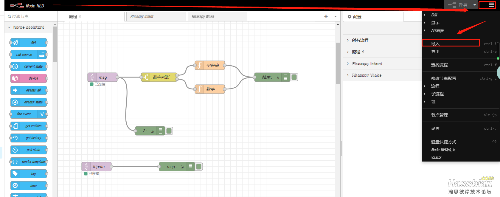

六、 配置HA中的node-red
官方文档:https://rhasspy.readthedocs.io/en/latest/tutorials/#wake-word
将一下控制流复制到 node-red 中
[{"id":"70d90eed.9fc7e8","type":"tab","label":"Rhasspy Intent","disabled":false,"info":""},{"id":"d7f94fdd.9b5028","type":"debug","z":"70d90eed.9fc7e8","name":"","active":true,"tosidebar":true,"console":false,"tostatus":false,"complete":"true","targetType":"full","x":230,"y":200,"wires":[]},{"id":"d60f2a3e.ec485","type":"websocket in","z":"70d90eed.9fc7e8","name":"","server":"","client":"be111083.116b5","x":200,"y":60,"wires":[["d7f94fdd.9b5028"]]},{"id":"be111083.116b5","type":"websocket-client","z":"","path":"ws://localhost:12101/api/events/intent","tls":"","wholemsg":"true"}]
node_1
node_1
node_2
node_2
配置node的数据源地址(rhasspy地址)
配置node
配置node
然后唤醒麦克风,说出命令,可以看到以下信息:
out_put
out_put
现在 外置麦克风+外置音响+rhasspy+HA+node-red 本地语音控制的整个流程就完成了,当然rhasspy玩法很多,这只是最基本用法,欢迎大家学习交流
