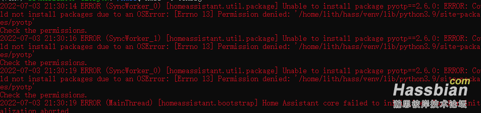

运行 hass -c config时报错:
[homeassistant.util.package] Unable to install package pyotp==2.6.0: ERROR: Could not install packages due to an OSError: [Errno 13] Permission denied: '/home/lith/hass/venv/lib/python3.9/site-packages/pyotp'
解决:
给hass目录赋予管理员权限
sudo chown -R lith:lith /home/lith/hass #注意替换用户和目录
