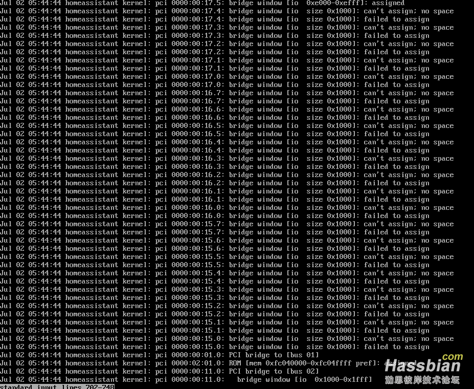

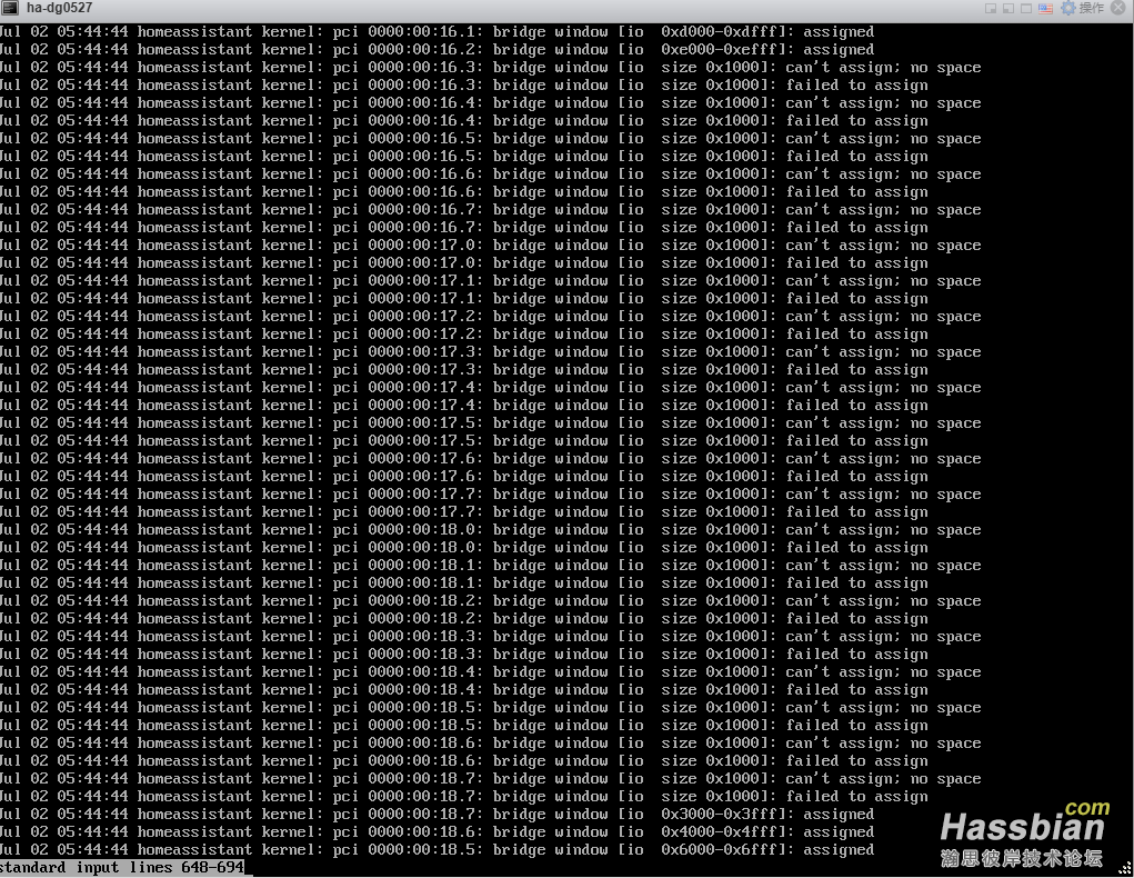

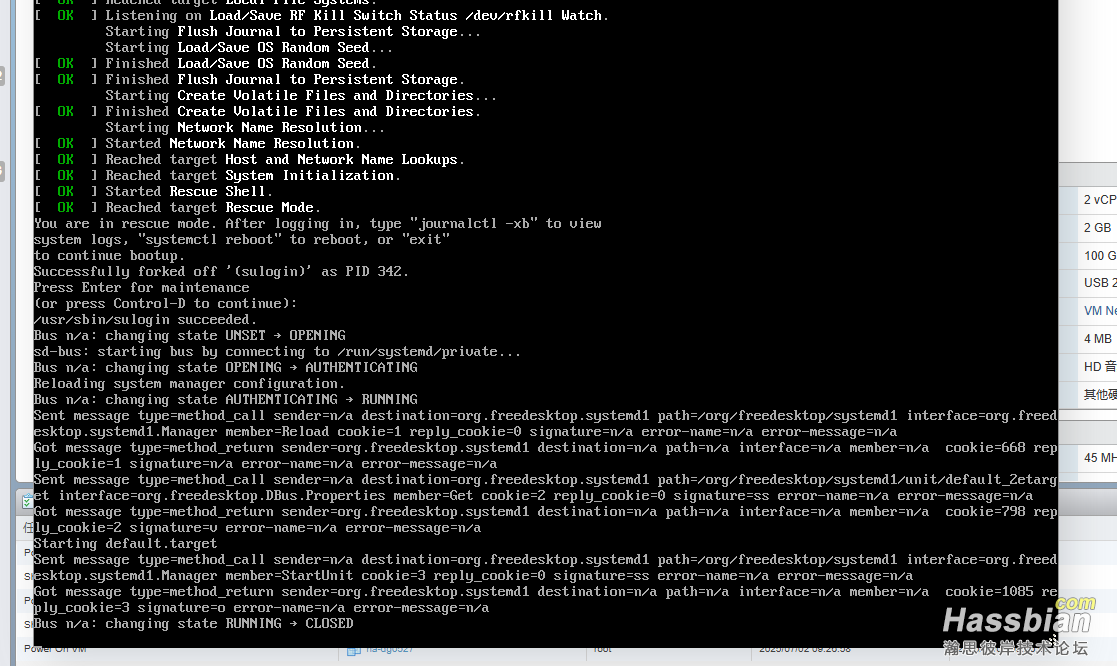

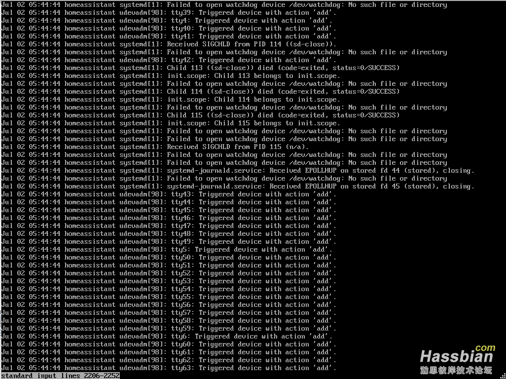

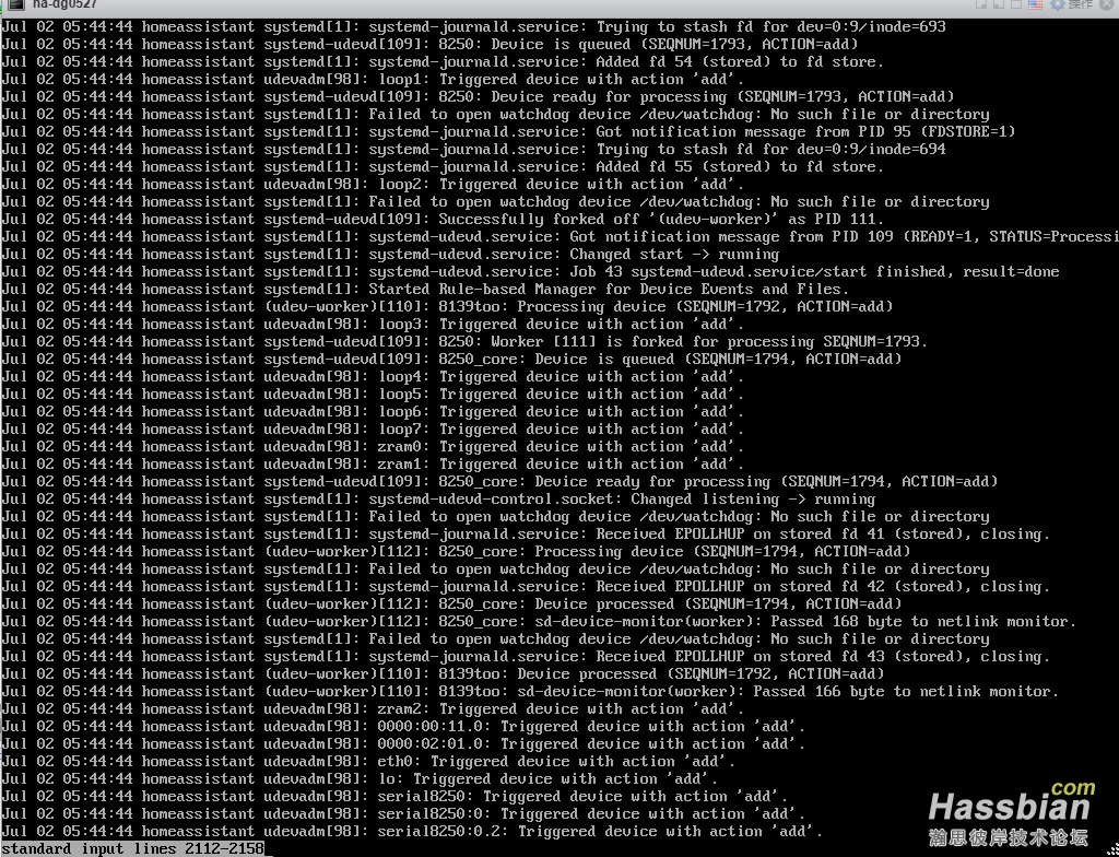

微信图片_20250702103405.png 微信图片_20250702135615.png 微信图片_20250702135645.png 微信图片_20250702135650.png 微信图片_20250702135656.png 你们还好,还能进系统,我是虚拟机反复重启,连HA都进入不了。。。哪位大神99我。。。

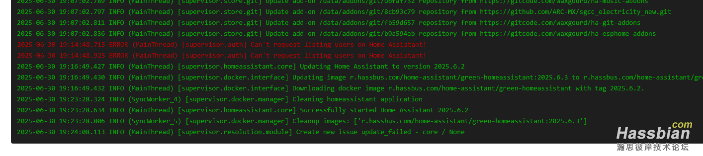

v1na 发表于 2025-6-30 18:17
用常规维护的core版本升降功能升级一下core 然后持续观察su日志
之前是6.2的  不行了就给他升到6.3了还是不行  现在降回来了

发表于 7 天前 | 显示全部楼层

2025-06-30 14:49:12.589 INFO (MainThread) [supervisor.addons.manager] Phase 'services' starting 5 add-ons
2025-06-30 14:49:12.713 INFO (SyncWorker_0) [supervisor.docker.manager] Cleaning addon_b9a594eb_esphome application
2025-06-30 14:49:13.554 INFO (MainThread) [supervisor.docker.addon] Starting Docker add-on r.hassbus.com/esphome/esphome-hassio with version 2025.5.2
2025-06-30 14:49:13.687 INFO (SyncWorker_0) [supervisor.docker.manager] Cleaning addon_core_matter_server application
2025-06-30 14:49:14.554 INFO (MainThread) [supervisor.docker.addon] Starting Docker add-on homeassistant/aarch64-addon-matter-server with version 8.0.0
2025-06-30 14:49:14.718 INFO (SyncWorker_3) [supervisor.docker.manager] Cleaning addon_core_samba application
2025-06-30 14:49:15.878 INFO (MainThread) [supervisor.docker.addon] Starting Docker add-on homeassistant/aarch64-addon-samba with version 12.5.2
2025-06-30 14:49:16.009 WARNING (MainThread) [supervisor.docker.addon] Advanced SSH & Web Terminal running with disabled protected mode!
2025-06-30 14:49:16.062 INFO (SyncWorker_3) [supervisor.docker.manager] Cleaning addon_fb59d657_ssh application
2025-06-30 14:49:17.858 INFO (MainThread) [supervisor.docker.addon] Starting Docker add-on r.hassbus.com/hassio-addons/ssh/aarch64 with version 20.0.2
2025-06-30 14:49:18.155 INFO (SyncWorker_6) [supervisor.docker.manager] Cleaning addon_fb59d657_tailscale application
2025-06-30 14:49:18.166 INFO (MainThread) [supervisor.api.middleware.security] /network/info access from core_samba
2025-06-30 14:49:18.568 INFO (MainThread) [supervisor.api.middleware.security] /network/interface/wlan0/info access from core_samba
2025-06-30 14:49:19.124 INFO (MainThread) [supervisor.api.middleware.security] /network/interface/end0/info access from core_samba
2025-06-30 14:49:19.902 INFO (MainThread) [supervisor.docker.addon] Starting Docker add-on r.hassbus.com/hassio-addons/tailscale/aarch64 with version 0.25.0
2025-06-30 14:49:26.531 INFO (MainThread) [supervisor.api.middleware.security] /network/info access from fb59d657_tailscale
2025-06-30 14:49:26.747 INFO (MainThread) [supervisor.api.middleware.security] /network/interface/wlan0/info access from fb59d657_tailscale
2025-06-30 14:49:27.068 INFO (MainThread) [supervisor.api.middleware.security] /network/interface/end0/info access from fb59d657_tailscale
2025-06-30 14:49:35.982 INFO (MainThread) [supervisor.api.middleware.security] /network/info access from core_matter_server
2025-06-30 14:49:37.980 INFO (MainThread) [supervisor.services.modules.mqtt] Set core_mosquitto as service provider for mqtt
2025-06-30 14:49:48.303 INFO (MainThread) [supervisor.core] Start Home Assistant Core
2025-06-30 14:49:48.375 INFO (SyncWorker_7) [supervisor.docker.manager] Starting homeassistant
2025-06-30 14:49:49.060 INFO (MainThread) [supervisor.homeassistant.core] Wait until Home Assistant is ready
2025-06-30 14:50:19.173 ERROR (MainThread) [supervisor.homeassistant.core] Home Assistant has crashed!
2025-06-30 14:50:19.175 ERROR (MainThread) [supervisor.core] Can't start Home Assistant Core - rebuiling
2025-06-30 14:50:19.313 INFO (SyncWorker_0) [supervisor.docker.manager] Cleaning homeassistant application
2025-06-30 14:50:19.605 INFO (MainThread) [supervisor.homeassistant.module] Update pulse/client.config: /data/tmp/homeassistant_pulse
2025-06-30 14:50:20.326 INFO (MainThread) [supervisor.docker.homeassistant] Starting Home Assistant r.hassbus.com/home-assistant/green-homeassistant with version 2025.5.3
2025-06-30 14:50:20.327 INFO (MainThread) [supervisor.homeassistant.core] Wait until Home Assistant is ready
2025-06-30 14:51:00.479 ERROR (MainThread) [supervisor.homeassistant.core] Home Assistant has crashed!
2025-06-30 14:51:00.481 INFO (MainThread) [supervisor.resolution.module] Create new suggestion execute_repair - core / None
2025-06-30 14:51:00.483 INFO (MainThread) [supervisor.resolution.module] Create new issue fatal_error - core / None
2025-06-30 14:51:00.493 INFO (MainThread) [supervisor.addons.manager] Phase 'application' starting 6 add-ons
2025-06-30 14:51:00.676 INFO (SyncWorker_7) [supervisor.docker.manager] Cleaning addon_7eca76cc_frp_client application
2025-06-30 14:51:01.396 INFO (MainThread) [supervisor.docker.addon] Starting Docker add-on r.hassbus.com/wghaos/frp-client with version 0.62.1
2025-06-30 14:51:01.541 INFO (SyncWorker_7) [supervisor.docker.manager] Cleaning addon_7eca76cc_zigbee2mqtt application
2025-06-30 14:51:02.568 INFO (MainThread) [supervisor.docker.addon] Starting Docker add-on r.hassbus.com/zigbee2mqtt/zigbee2mqtt-aarch64 with version 2.4.0-1
2025-06-30 14:51:02.696 INFO (SyncWorker_6) [supervisor.docker.manager] Cleaning addon_8cb93c79_sgcc_electricity application
2025-06-30 14:51:03.658 INFO (MainThread) [supervisor.docker.addon] Starting Docker add-on registry.cn-hangzhou.aliyuncs.com/arcw/sgcc_electricity-aarch64 with version v1.6.6
2025-06-30 14:51:03.702 INFO (MainThread) [supervisor.api.middleware.security] /supervisor/info access from 7eca76cc_zigbee2mqtt
2025-06-30 14:51:03.887 INFO (SyncWorker_6) [supervisor.docker.manager] Cleaning addon_b39a9988_hass_panel_beta application
2025-06-30 14:51:05.090 INFO (MainThread) [supervisor.docker.addon] Starting Docker add-on registry.cn-hangzhou.aliyuncs.com/hass-panel/hass-panel with version v1.3.8
2025-06-30 14:51:05.276 INFO (SyncWorker_3) [supervisor.docker.manager] Cleaning addon_core_configurator application
2025-06-30 14:51:07.333 INFO (MainThread) [supervisor.docker.addon] Starting Docker add-on homeassistant/aarch64-addon-configurator with version 5.8.0
2025-06-30 14:51:07.574 INFO (SyncWorker_7) [supervisor.docker.manager] Cleaning addon_fb59d657_nodered application
2025-06-30 14:51:09.278 INFO (MainThread) [supervisor.docker.addon] Starting Docker add-on r.hassbus.com/hassio-addons/node-red/aarch64 with version 19.0.2
2025-06-30 14:51:34.520 INFO (MainThread) [supervisor.auth] Auth request from 'core_mosquitto' for 'addons'
2025-06-30 14:51:34.525 INFO (MainThread) [supervisor.auth] Home Assistant not running, checking cache
2025-06-30 14:51:51.226 INFO (MainThread) [supervisor.misc.tasks] All core tasks are scheduled
2025-06-30 14:51:51.231 INFO (MainThread) [supervisor.host.info] Updating local host information
2025-06-30 14:51:51.236 INFO (MainThread) [supervisor.updater] Fetching update data from https://version.wghaos.com/panth ... 2025.06.2&arch=
2025-06-30 14:51:51.247 INFO (MainThread) [supervisor.resolution.check] Starting system checks with state running
2025-06-30 14:51:51.249 INFO (MainThread) [supervisor.resolution.checks.base] Run check for trust/supervisor
2025-06-30 14:51:51.263 INFO (MainThread) [supervisor.core] Supervisor is up and running
2025-06-30 14:51:51.271 INFO (MainThread) [__main__] Running Supervisor
2025-06-30 14:51:51.292 INFO (MainThread) [supervisor.resolution.checks.base] Run check for ipv4_connection_problem/system
2025-06-30 14:51:51.293 INFO (MainThread) [supervisor.resolution.checks.base] Run check for security/core
2025-06-30 14:51:51.295 INFO (MainThread) [supervisor.resolution.checks.base] Run check for disabled_data_disk/system
2025-06-30 14:51:51.306 INFO (MainThread) [supervisor.resolution.checks.base] Run check for pwned/addon
2025-06-30 14:51:52.411 INFO (MainThread) [supervisor.resolution.checks.base] Run check for no_current_backup/system
2025-06-30 14:51:52.415 INFO (MainThread) [supervisor.resolution.module] Create new suggestion create_full_backup - system / None
2025-06-30 14:51:52.416 INFO (MainThread) [supervisor.resolution.module] Create new issue no_current_backup - system / None
2025-06-30 14:51:52.418 INFO (MainThread) [supervisor.resolution.checks.base] Run check for dns_server_failed/dns_server
2025-06-30 14:51:52.480 INFO (MainThread) [supervisor.resolution.checks.base] Run check for dns_server_ipv6_error/dns_server
2025-06-30 14:51:52.532 INFO (MainThread) [supervisor.resolution.checks.base] Run check for multiple_data_disks/system
2025-06-30 14:51:52.533 INFO (MainThread) [supervisor.resolution.checks.base] Run check for docker_config/system
2025-06-30 14:51:52.535 INFO (MainThread) [supervisor.resolution.checks.base] Run check for free_space/system
2025-06-30 14:51:52.554 INFO (MainThread) [supervisor.resolution.check] System checks complete
2025-06-30 14:51:52.556 INFO (MainThread) [supervisor.resolution.evaluate] Starting system evaluation with state running
2025-06-30 14:51:53.608 INFO (MainThread) [supervisor.resolution.evaluate] System evaluation complete
2025-06-30 14:51:53.611 INFO (MainThread) [supervisor.resolution.fixup] Starting system autofix at state running
2025-06-30 14:51:53.613 INFO (MainThread) [supervisor.resolution.fixup] System autofix complete
2025-06-30 14:51:54.178 INFO (MainThread) [supervisor.host.services] Updating service information
2025-06-30 14:51:54.199 INFO (MainThread) [supervisor.host.network] Updating local network information
2025-06-30 14:51:54.785 INFO (MainThread) [supervisor.host.sound] Updating PulseAudio information
2025-06-30 14:51:54.827 INFO (MainThread) [supervisor.host.manager] Host information reload completed
