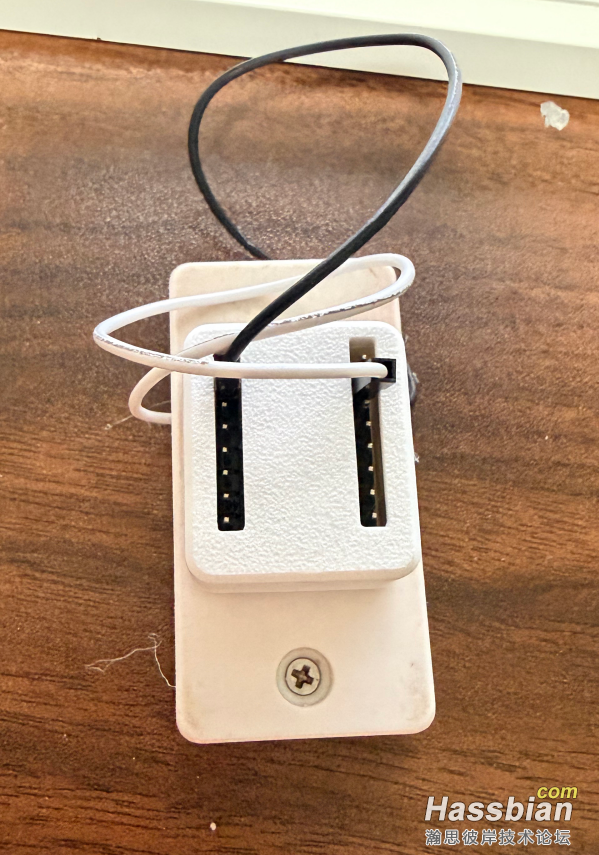

起因老人需要来家里帮忙照看孩子,但是这种指纹锁对老年人指纹识别率较低。又不想更换。所以想到了这个办法。前提是指纹锁支持遥控器控制开关,否则就要在门锁上进行飞线。还要有HA,docker。才能复现这些功能。

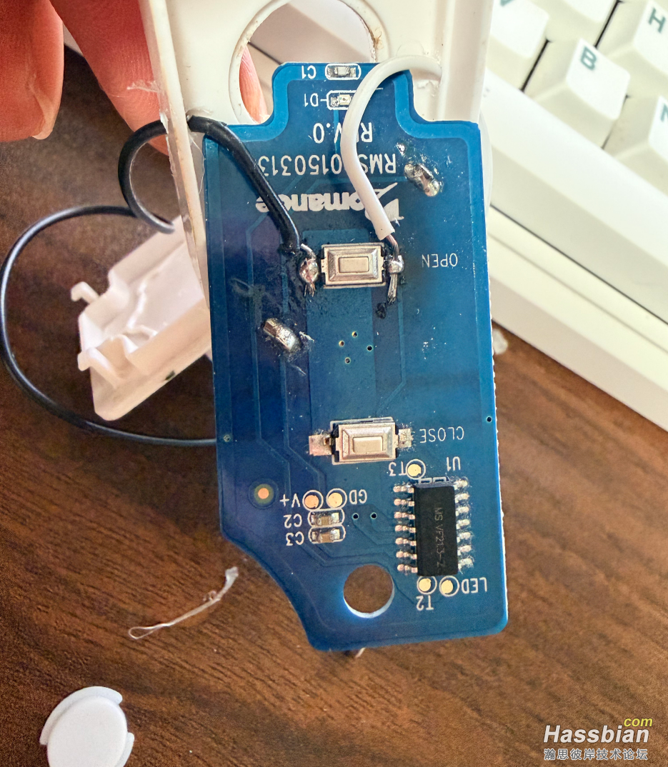

.查看指纹锁遥控器是否可以焊接飞线,可以实现短路开锁!遥控器的负极必须要和开关的一端共用G口。如果不能,就要想其他办法,比如查看遥控器是否是常见的频率,能否复制等。

一、焊接遥控器;开关必须有一端和负极共用的。否则容易出现不触发的情况。

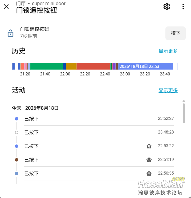

二、连接ESP32,并接入HA看一下能不能触发;

六,连接小程序和HA,建议ha建立自动化,不要直接触发控制该设备,方便前期调试(比如说先控制灯)后期改变的时候不需要更改前端和docker代码。直接在HA中就可以完成;

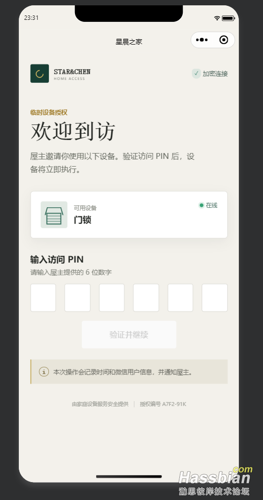

1. index.js
const DEMO_MODE = false
const API_BASE_URL = 'https://<YOUR_PUBLIC_HTTPS_DOMAIN>'
const DEMO_PIN = '<DEMO_PIN>'
Component({
  data: {
    authorizationId: '<YOUR_ACCESS_ID>',
    pin: '',
    pinCells: ['', '', '', '', '', ''],
    pinFocused: false,
    pinError: false,
    verifying: false,
    verified: false,
    triggering: false,
    triggered: false,
    triggerError: false,
    canControlAgain: false,
  lifetimes: {
    attached() {
      const pages = getCurrentPages()
      const currentPage = pages[pages.length - 1]
      const authorizationId = currentPage && currentPage.options && currentPage.options.authorizationId
      if (authorizationId) {
        this.setData({ authorizationId })
  methods: {
    onShareAppMessage() {
      return {
        title: '邀请你使用家庭设备',
        path: `/pages/index/index?authorizationId=${encodeURIComponent(this.data.authorizationId)}`,
    onPinInput(event) {
      const pin = String(event.detail.value).replace(/\D/g, '').slice(0, 6)
      this.setData({
        pin,
        pinCells: Array.from({ length: 6 }, (_, index) => pin[index] || ''),
        pinError: false,
      if (pin.length === 6) {
        this.setData({ pinFocused: false })
        wx.hideKeyboard()
    onPinFocus() {
      this.setData({ pinFocused: true })
    onPinBlur() {
    focusPin() {
    verifyPin() {
      if (this.data.pin.length !== 6 || this.data.verifying) return
      this.setData({ verifying: true, pinError: false })
      if (DEMO_MODE) {
        setTimeout(() => {
          const verified = this.data.pin === DEMO_PIN
          this.setData({ verifying: false, verified, pinError: !verified })
          if (verified) this.triggerDevice()
          else wx.vibrateShort({ type: 'medium' })
        }, 550)
        return
      wx.request({
        url: `${API_BASE_URL}/api/access/verify`,
        method: 'POST',
        data: {
          authorizationId: this.data.authorizationId,
          pin: this.data.pin,
        success: (response) => {
          const verified = response.statusCode === 200
          this.setData({ verified, pinError: !verified })
        fail: () => wx.showToast({ title: '网络连接失败', icon: 'none' }),
        complete: () => this.setData({ verifying: false }),
    triggerDevice() {
      if (this.data.triggering) return
      this.setData({
        triggering: true,
        triggered: false,
      if (DEMO_MODE) {
        setTimeout(() => this.handleTriggerSuccess(), 900)
        return
      wx.request({
        url: `${API_BASE_URL}/api/access/trigger`,
        method: 'POST',
        data: {
          pin: this.data.pin,
          if (response.statusCode === 200) {
          } else {
            this.setData({ triggerError: true })
            wx.showToast({ title: '设备执行失败', icon: 'none' })
        fail: () => {
        complete: () => this.setData({ triggering: false }),
    handleTriggerSuccess() {
      this.setData({ triggering: false, triggered: true })
      wx.showToast({ title: '设备指令已发送', icon: 'success', duration: 2200 })
      wx.vibrateShort({ type: 'light' })
      setTimeout(() => this.setData({ canControlAgain: true }), 3000)
    controlAgain() {
index.wxml
<scroll-view class="page" scroll-y enhanced show-scrollbar="{{false}}">
  <view class="shell">
    <view class="topbar">
      <view class="brand-mark"><view class="brand-dot"></view></view>
      <view class="brand-copy">
        <text class="brand-name">HOME ACCESS</text>
        <text class="brand-subtitle">FAMILY DEVICE</text>
      </view>
      <view class="security-pill"><view class="shield">✓</view><text>加密连接</text></view>
    </view>
    <view class="intro">
      <text class="eyebrow">临时设备授权</text>
      <text class="title">欢迎到访</text>
      <text class="description">屋主邀请你使用以下设备。验证访问 PIN 后,设备将立即执行。</text>
    </view>
    <view class="device-panel">
      <view class="device-head">
        <view class="device-icon">
          <view class="garage-roof"></view>
          <view class="garage-door"><view></view><view></view><view></view></view>
        </view>
        <view class="device-copy">
          <text class="device-label">可用设备</text>
          <text class="device-name">门锁</text>
        </view>
        <view class="status"><view class="status-dot"></view><text>在线</text></view>
      </view>
    </view>
    <view wx:if="{{!verified}}" class="auth-section">
      <text class="section-title">输入访问 PIN</text>
      <text class="section-hint">请输入屋主提供的 6 位数字</text>
      <view class="pin-wrap {{pinError ? 'pin-error' : ''}}">
        <input class="pin-input" type="number" maxlength="6" value="{{pin}}" focus="{{pinFocused}}" bindinput="onPinInput" bindfocus="onPinFocus" bindblur="onPinBlur" />
        <view class="pin-cells" bindtap="focusPin">
          <view wx:for="{{pinCells}}" wx:key="index" class="pin-cell {{pin.length === index && pinFocused ? 'active' : ''}}">
            <view wx:if="{{item}}" class="pin-dot"></view>
          </view>
        </view>
      </view>
      <text wx:if="{{pinError}}" class="error-text">PIN 不正确,请检查后重试</text>
      <button class="primary-button" disabled="{{pin.length !== 6 || verifying}}" loading="{{verifying}}" bindtap="verifyPin">{{verifying ? '正在验证' : '验证并继续'}}</button>
    </view>
    <view wx:else class="control-section">
      <view class="verified-row"><view class="verified-icon">✓</view><text>身份验证成功</text></view>
      <view class="execution-status {{triggered ? 'success' : ''}} {{triggerError ? 'error' : ''}}">
        <view class="execution-icon">{{triggered ? '✓' : (triggerError ? '!' : '···')}}</view>
        <text>{{triggered ? '门锁已开' : (triggerError ? '设备执行失败' : '正在执行设备指令')}}</text>
      </view>
      <button wx:if="{{canControlAgain}}" class="primary-button control-again-button" disabled="{{triggering}}" bindtap="controlAgain">点击开锁</button>
      <text class="control-note">{{triggerError ? '请联系屋主检查设备状态' : (canControlAgain ? '点击后将再次开锁' : '3 秒后可以继续控制设备')}}</text>
    </view>
    <view class="notice">
      <view class="notice-icon">i</view>
      <text>本次操作会记录时间和微信用户信息,并通知屋主。</text>
    </view>
    <view class="footer"><text>家庭设备安全服务</text><view class="footer-line"></view><text>授权编号 {{authorizationId}}</text></view>
  </view>
</scroll-view>
index.wxss
