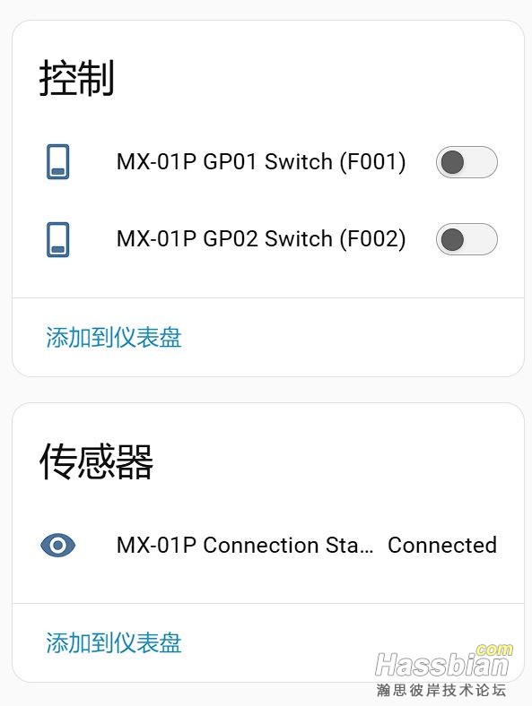

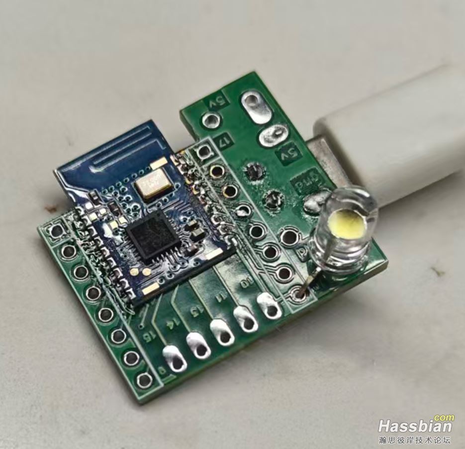

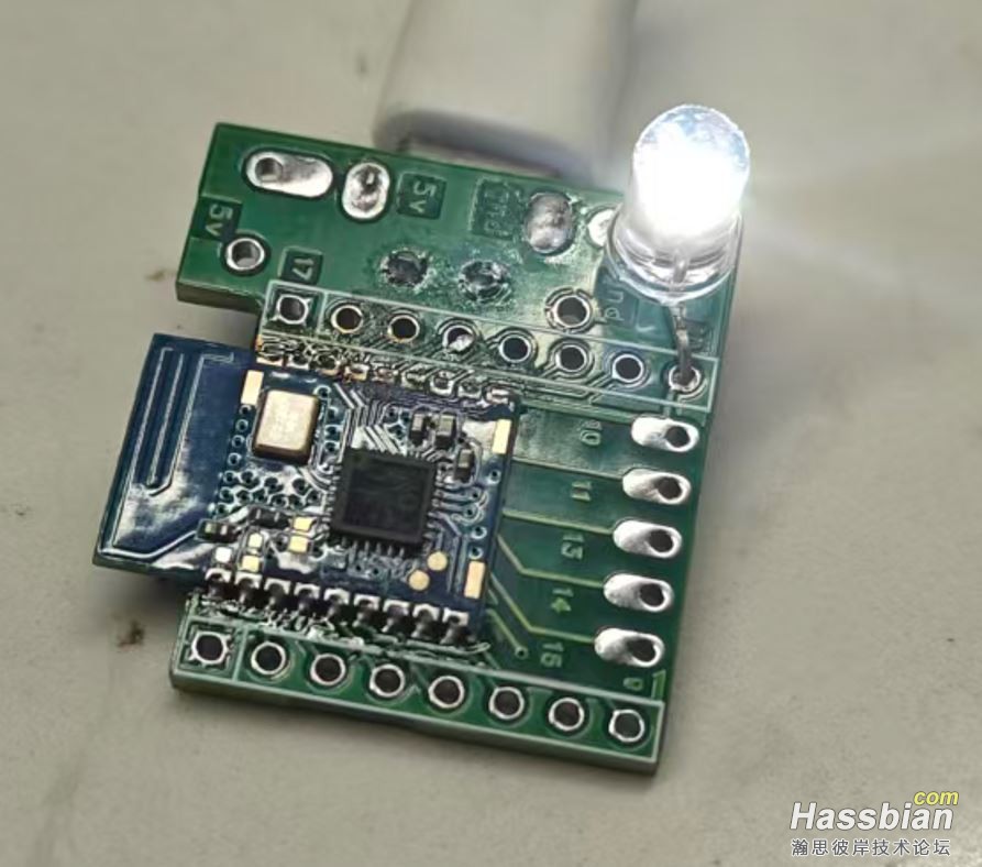

最近发现个好东东,mx-01p蓝牙透传模块带两个io控制脚,可以跟店家要手机app,直接手机控制模块,
接个光耦继电器可以当个蓝牙开关用了,
可以接入HA自动化挺好的,直接省下个mcu代替esp了,分享给大伙折腾
还没想好用到什么场景,大伙集思广益。
# ===== BLE 客户端 - 连接 MX-01P =====
ble_client:
  - mac_address: "D5:68:82:20:71:A0"   # 请确认是你的模块 MAC
    auto_connect: true   # 显式开启自动重连
# ===== 两个模板开关 =====
switch:
  - platform: template
    name: "MX-01P GP01 Switch (F001)"
    optimistic: true
    turn_on_action:
      - logger.log: "GP01 (F001) turn ON"
      - ble_client.ble_write:
          service_uuid: "F000"
          characteristic_uuid: "F001"
          value: [0x01]
    turn_off_action:
      - logger.log: "GP01 (F001) turn OFF"
          value: [0x00]
    name: "MX-01P GP02 Switch (F002)"
    optimistic: true
    turn_on_action:
      - logger.log: "GP02 (F002) turn ON"
          characteristic_uuid: "F002"
          value: [0x01]
    turn_off_action:
      - logger.log: "GP02 (F002) turn OFF"
          value: [0x00]
