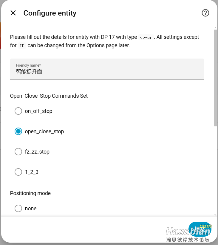

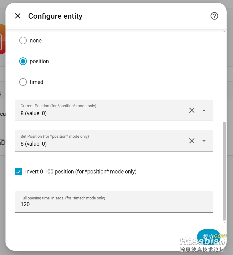

图中向下键,按过以后,在涂鸦AAP上显示的是向上。向上箭头始终是灰色,只有在涂鸦APP上将窗户下降以后,向上箭头才会呈现可用状态。
以下是设备规格属性
{  "result": {    "category": "mc",    "functions": [      {        "code": "curtain_control",        "dp_id": 17,        "type": "Enum",        "values": "{\"range\":[\"up\",\"down\",\"stop\"]}"      },      {        "code": "work_mode",        "dp_id": 24,        "type": "Enum",        "values": "{\"range\":[\"open\",\"close\"]}"      },      {        "code": "screen_control",        "dp_id": 27,        "type": "Enum",        "values": "{\"range\":[\"open\",\"stop\",\"close\"]}"      },      {        "code": "switch_sensor",        "dp_id": 35,        "type": "Boolean",        "values": "{}"      },      {        "code": "led",        "dp_id": 101,        "type": "Boolean",        "values": "{}"      }    ],    "lang_config": {},    "status": [      {        "code": "status",        "dp_id": 1,        "type": "Enum",        "values": "{\"range\":[\"opened\",\"closed\"]}"      },      {        "code": "percent_state",        "dp_id": 8,        "type": "Integer",        "values": "{\"unit\":\"%\",\"min\":0,\"max\":100,\"scale\":0,\"step\":1}"      },      {        "code": "curtain_control",        "dp_id": 17,        "type": "Enum",        "values": "{\"range\":[\"up\",\"down\",\"stop\"]}"      },      {        "code": "work_mode",        "dp_id": 24,        "type": "Enum",        "values": "{\"range\":[\"open\",\"close\"]}"      },      {        "code": "screen_control",        "dp_id": 27,        "type": "Enum",        "values": "{\"range\":[\"open\",\"stop\",\"close\"]}"      },      {        "code": "switch_sensor",        "dp_id": 35,        "type": "Boolean",        "values": "{}"      },      {        "code": "led",        "dp_id": 101,        "type": "Boolean",        "values": "{}"      }    ]  },  "success": true,  "t": 1782529471589,  "tid": "eb039d8b71d411f1b91582da8a77992d"}
以下是设备指令集
  {  "result": {    "category": "mc",    "functions": [      {        "code": "curtain_control",        "desc": "",        "name": "窗户控制",        "type": "Enum",        "values": "{\"range\":[\"up\",\"down\",\"stop\"]}"      },      {        "code": "work_mode",        "desc": "",        "name": "联动模式",        "type": "Enum",        "values": "{\"range\":[\"open\",\"close\"]}"      },      {        "code": "screen_control",        "desc": "",        "name": "纱窗控制",        "type": "Enum",        "values": "{\"range\":[\"open\",\"stop\",\"close\"]}"      },      {        "code": "switch_sensor",        "desc": "",        "name": "风光雨传感器开关",        "type": "Boolean",        "values": "{}"      },      {        "code": "led",        "desc": "",        "name": "照明",        "type": "Boolean",        "values": "{}"      }    ]  },  "success": true,  "t": 1782528756666,  "tid": "40d1df4d71d311f1b1173269c86968c5"}
以下是Localtuya添加选项
我的添加填写应该是没有错的吧?有大佬能指导这个问题怎么解决?

已解决。通过Xtend Tuya,配置好以后只有传感器状态,其他按键进入取消禁用,完美解决。
