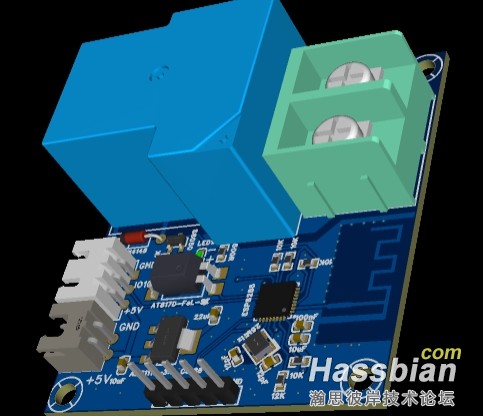

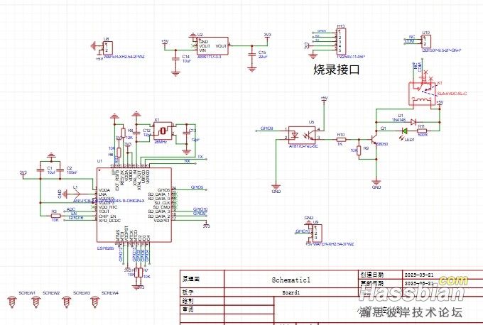

电路图如下:

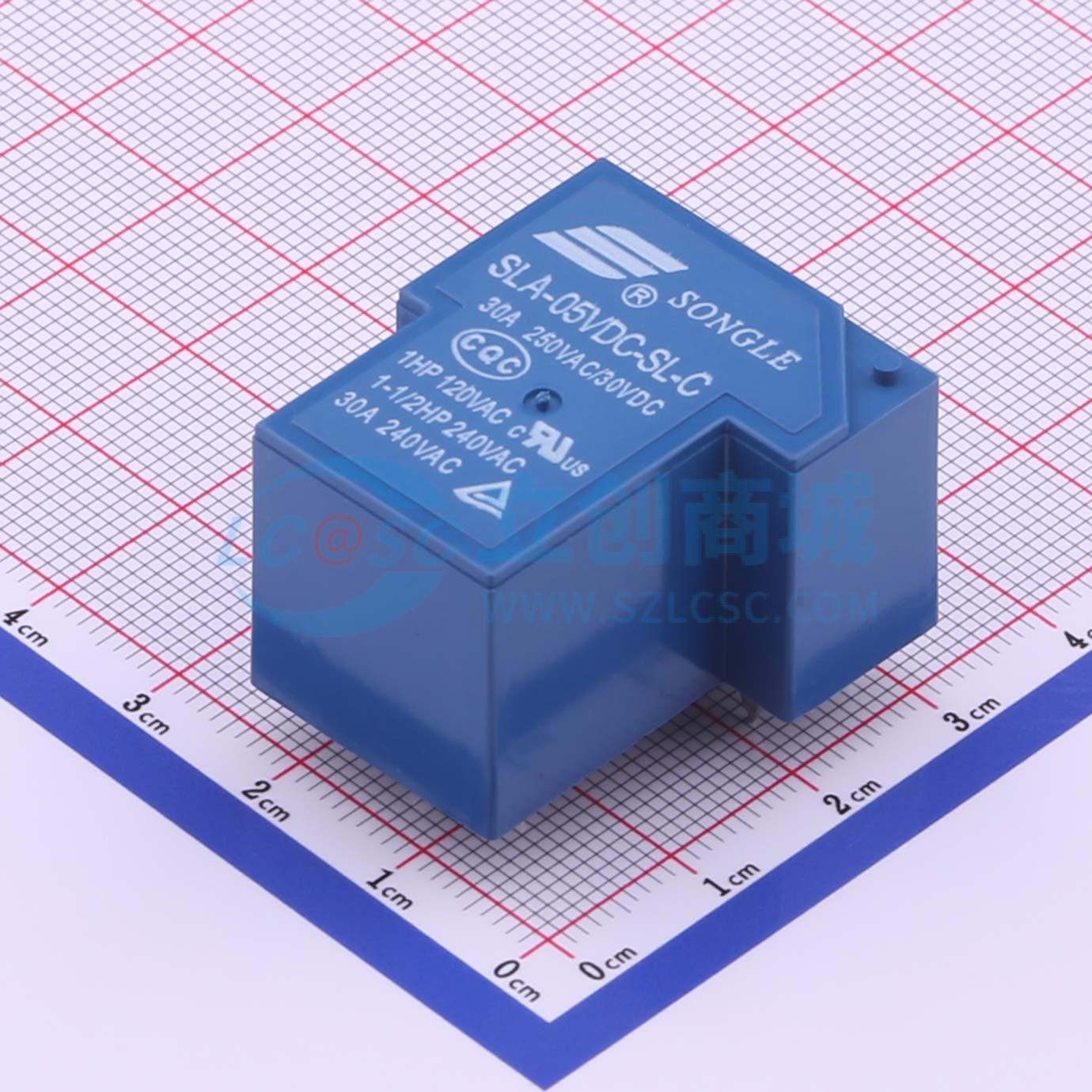

需要注意的是这里的继电器要使用大功率继电器,我用的是图片中的这样的

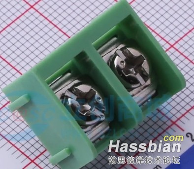

相应的接线端子也要用大功率的栅栏式接线端子

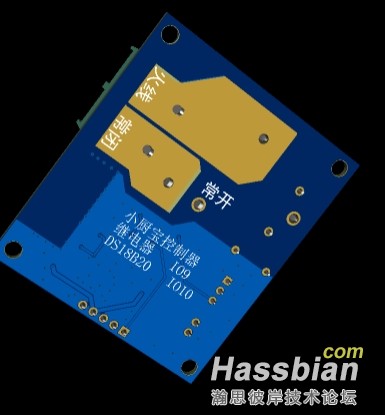

注意:因为小厨宝功率很大,电流也很大,在pcb背面220v线路部分在pcb背面增加一定的阻焊层,回头好手动焊接上铜线
屏幕截图_31-5-2025_155028_pro.lceda.cn.jpeg 屏幕截图_31-5-2025_155147_pro.lceda.cn.jpeg
esphome代码很简单,就一个:switch、和一个ds18b20的one_wire组件:
esphome:
friendly_name: xiaochubao
esp8266:
board: espmxdevkit
# Enable logging
logger:
# Enable Home Assistant API
api:
ota:
- platform: esphome
password: "c9a0393028288bea43aee2bf7a096da3"
wifi:
ssid: "XXXXXXXXXXXXX"
password: "XXXXXXXXXXXXX"
ap:
ssid: "Xiaochubao Fallback Hotspot"
password: "SoP17QWSd7v3"
captive_portal:
switch:
- platform: gpio
pin: 9
inverted: true
restore_mode: RESTORE_DEFAULT_ON
one_wire:
- platform: gpio
pin: 10
# # Individual sensors
sensor:
- platform: dallas_temp
# address: 0x6d0b239c87941b28
update_interval: 1s
# # on_value_range:
# # - above: 50
# # then:
# # - switch.turn_off: jiare
