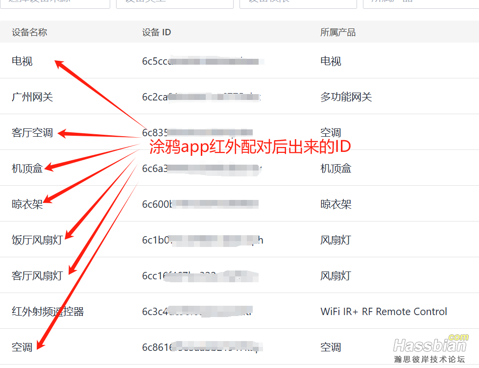

发表于 2025-6-27 16:30:23 | 显示全部楼层
传统老空调没什么互联网功能,都是涂鸦红外配对出来的虚拟机子,这2个东西去哪里看?目前loT已经过期了,ha上的涂鸦设备是智障,不是智能设备了。
我HA configuration.yaml
climate:
  - platform: tuya_generic_thermostat
    target_sensor: sensor.temperature_humidity_sensor_XXXXX_temperature     -------->温度传感器,这东西哪里可以看?
    unique_id: "主卧空调xxx,一定要唯一"    --------->????哪里可看
    access_id: "tty7xxxxxxxnuw"    ----->涂鸦开发者网站可看
    access_secret: "a60xxxxxxxxxxxxxed"----->涂鸦开发者网站可看
    remote_id: "6cxxxxxxxxvif0"   --------->红外遥控器ID,开发者网站可看
    ac_id: "6c3xxxxxxxcttx5"   ----->????哪里可看
    min_temp: 16
    max_temp: 30
    ac_mode: true
    target_temp: 24.7
    sleep_temp: 26.7
    activity_temp: 22.7
    comfort_temp: 24.7
    cold_tolerance: 0.3
    hot_tolerance: 0.3
    min_cycle_duration:
      minutes: 3
    initial_hvac_mode: "off"
    precision: 0.1
