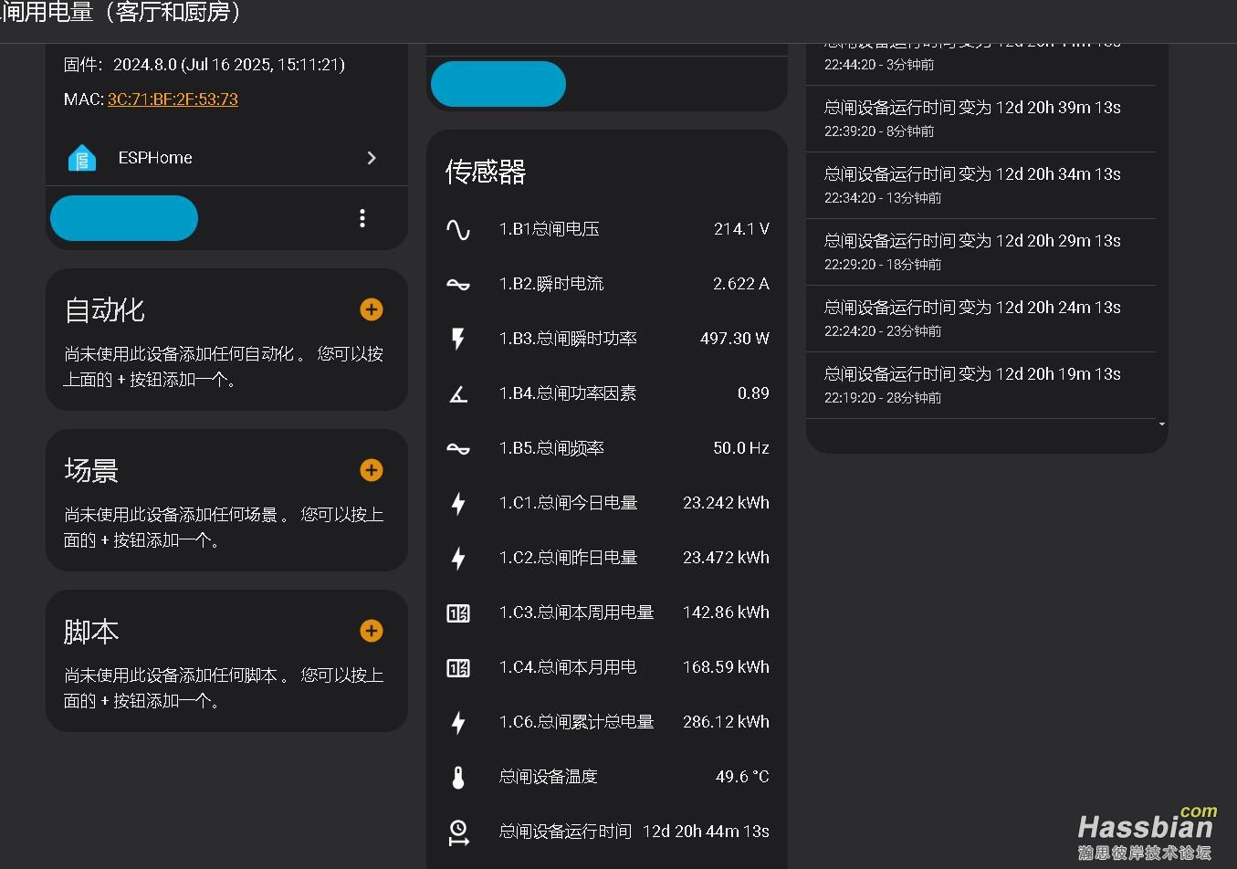

 楼主| 发表于 2025-8-9 21:36:09 | 显示全部楼层
新手一枚 发表于 2025-8-9 15:30
大神帮帮忙,我把你的代码代入进去,就出错
出错的相关日志有没有?
这个帖子时间比较久了,有些格式官方可能有变动,很多地方可能需要按新的格式要求进行修改。后来官方的能源面板就相当好用了,基本上不再需要这些实体就可以查看相关统计。
下面是我自己在用的代码 dianbiao.yaml,放在config/package目录下,偶尔可以看看进行一下对比。你可以参考着修改一下:

发表于 2025-8-9 22:49:13 | 显示全部楼层
dscao 发表于 2025-8-9 21:36
出错的相关日志有没有?
这个帖子时间比较久了,有些格式官方可能有变动,很多地方可能需要按新的格式要求 ...
  "version": 1,
  "minor_version": 1,
  "key": "esphome.01K1608NMED6174DZYY5T5A4NF",
  "data": {
    "device_info": {
      "uses_password": false,
      "name": "espmeter-2f5373",
      "friendly_name": "Esp_meter 2f5373",
      "mac_address": "3C:71:BF:2F:53:73",
      "compilation_time": "Jul 16 2025, 15:11:21",
      "model": "esp01_1m",
      "manufacturer": "Espressif",
      "has_deep_sleep": false,
      "esphome_version": "2024.8.0",
      "project_name": "",
      "project_version": "",
      "webserver_port": 80,
      "legacy_voice_assistant_version": 0,
      "voice_assistant_feature_flags": 0,
      "legacy_bluetooth_proxy_version": 0,
      "bluetooth_proxy_feature_flags": 0,
      "suggested_area": "",
      "bluetooth_mac_address": "",
      "api_encryption_supported": false,
      "devices": [],
      "areas": [],
      "area": {
        "area_id": 0,
        "name": ""
    "services": [],
    "api_version": {
      "major": 1,
      "minor": 10
    "sensor": [
        "object_id": "temperature",
        "key": 899752953,
        "name": "temperature",
        "disabled_by_default": false,
        "icon": "",
        "entity_category": 0,
        "device_id": 0,
        "device_class": "temperature",
        "unit_of_measurement": "°C",
        "accuracy_decimals": 1,
        "force_update": false,
        "state_class": 1,
        "legacy_last_reset_type": 0
        "object_id": "voltage",
        "key": 2195749573,
        "name": "Voltage",
        "icon": "",
        "device_id": 0,
        "device_class": "voltage",
        "unit_of_measurement": "V",
        "state_class": 1,
        "object_id": "current",
        "key": 2037989808,
        "name": "Current",
        "icon": "",
        "device_id": 0,
        "device_class": "current",
        "unit_of_measurement": "A",
        "accuracy_decimals": 3,
        "state_class": 1,
        "object_id": "power",
        "key": 2391494160,
        "name": "Power",
        "icon": "",
        "device_id": 0,
        "device_class": "power",
        "unit_of_measurement": "W",
        "accuracy_decimals": 2,
        "state_class": 1,
        "object_id": "energy",

 楼主| 发表于 2025-8-9 23:08:55 | 显示全部楼层
esphome中的实体已经有了,这里只需要一个电量值的传感器实体,其它的都是模板实体和自动化调用系统功能的。只需要将我的代码中“sensor.jia_dian_zong_dian_liang”替换为你的“sensor.energy”,应该就可以了。
