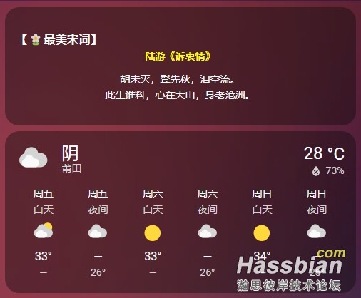

首页卡片截图如下,内容会定时滚动:
蘑菇卡片代码如下:
type: custom:html-template-card
content: >
  {% set entity = 'sensor.gun_dong_nei_rong' %}<div style="color: white;"><p
  align="left"><h3 style="color: white; margin-bottom: 0px;">【{{
  state_attr(entity, 'title') }}】</h3><p align="{{ state_attr(entity,
  'subalign') }}" style="color: yellow; margin: 0px 0;"><b>{{ state_attr(entity,
  'subtitle') }}</b></p></div> <p align="{{ state_attr(entity, 'align') }}"
  style="color: white; font-size: 1.0em; margin-top: 10px;">{{
  state_attr(entity, 'content1') }}
