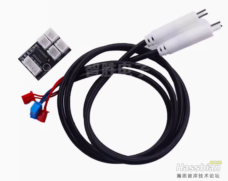

本來是用版上這位大哥的代碼
https://bbs.hassbian.com/thread-23740-1-1.html
後來esphome改版後一直無法更新
跟ChatGPT奮戰10幾次失敗
每次都是剛有苗頭就到達使用上限
然後就開始亂回答越用越糟
好在這次終於在到達使用上限前完成
分享給需要的版友使用
檔案解壓縮後放到 /config/esphome/
uart:
  - id: uart_bus1
    tx_pin: 1
    rx_pin: 3
    baud_rate: 9600
# 外部元件
external_components:
  - source:
      type: local
      path: ./external_components
    components: [tds_uart]
# 使用從外部元件加載的感測器
sensor:
  - platform: tds_uart
    uart_id: uart_bus1
    tds1:
      icon: mdi:water-pump
      unit_of_measurement: ppm
      accuracy_decimals: 0
    temperature1:
      icon: mdi:thermometer-water
      unit_of_measurement: °C
      accuracy_decimals: 1
    tds2:
      icon: mdi:air-filter
    temperature2:
      unit_of_measurement: °C"
# 感測器更新時間
time:
  - platform: homeassistant
    on_time:
      - seconds: /10
        then:
          - uart.write: [0x55, 0x07, 0x05, 0x01, 0x00, 0x00, 0x00, 0x62]
          - delay: 500ms
          - uart.write: [0x55, 0x07, 0x05, 0x02, 0x00, 0x00, 0x00, 0x63]
external_components.rar (1.68 KB, 下载次数: 4)
