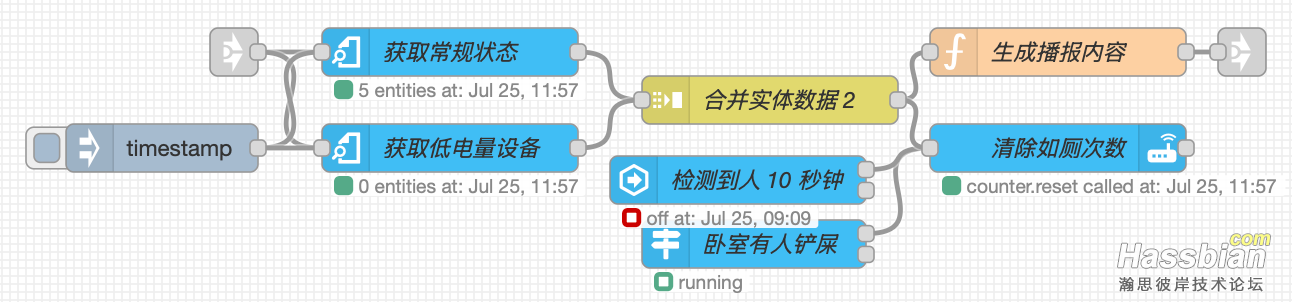

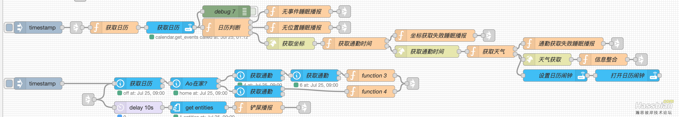

我目前在用的个人觉得比较实用的有:
1. https://github.com/dscao/travel_time 每天闹钟响的时候播报通勤时间
2. 用CalDAV集成手机日历,睡前播报第二天日历,如果日历有地址信息的话,播报通勤时间和目的地天气
3. Frigate监控猫厕所,记录猫上厕所次数,提醒铲屎
4. 回家小爱主动问询、空气质量、低电量传感器播报
5. 人在家且未睡觉时,下雨及自然灾害语音播报

发表于 2025-7-25 14:32:06 | 显示全部楼层
490

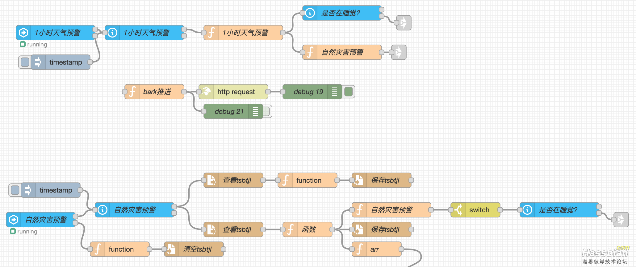

发表于 2025-7-25 14:34:59 | 显示全部楼层
aabbcc7788 发表于 2025-7-24 16:20
老铁,可以分享一下成果吗
天气用到的template
- sensor:
    - name: 一小时天气预警
      state: '{% if ("雨" in states.weather.tian_qi.attributes.hourly_forecast[0].text) %}{{states.weather.tian_qi.attributes.hourly_forecast[0].datetime}}降雨概率为:{{states.weather.tian_qi.attributes.hourly_forecast[0].precipitation}},可能{{states.weather.tian_qi.attributes.hourly_forecast[0].text}},请多加注意!{% else %}未来一小时无不良天气{% endif %}'
    - name: 自然灾害预警最新一条
      #state: '{% if ("当前无灾害预警" in states.weather.tian_qi.attributes.warning[0].text) %}当前无自然灾害预警信息{% else %}{{ states.weather.tian_qi.attributes.warning[0].pubTime}}{% endif %}'
      state: >-
        {% if states.weather.tian_qi.attributes.warning is defined and states.weather.tian_qi.attributes.warning | length > 0 %}
          {% set warning = states.weather.tian_qi.attributes.warning[0] %}
          {{ warning.pubTime}}
        {% else %}
          当前无自然灾害预警信息 {# 如果没有预警,显示这个友好的提示,而不是报错 #}
        {% endif %}
      attributes:
        title: "{% if ('当前无灾害预警' not in states.weather.tian_qi.attributes.warning[0].text) %} {{ states.weather.tian_qi.attributes.warning[0].title}} {% else %}null{% endif %}"
        text: "{% if ('当前无灾害预警' not in states.weather.tian_qi.attributes.warning[0].text) %}{{ states.weather.tian_qi.attributes.warning[0].text }} {% else %}null{% endif %}"
        pubTime: "{% if ('当前无灾害预警' not in states.weather.tian_qi.attributes.warning[0].text) %}{{ states.weather.tian_qi.attributes.warning[0].pubTime}} {% else %}null{% endif %}"
        startTime: "{% if ('当前无灾害预警' not in states.weather.tian_qi.attributes.warning[0].text) %}{{ states.weather.tian_qi.attributes.warning[0].startTime}} {% else %}null{% endif %}"
        endTime: "{% if ('当前无灾害预警' not in states.weather.tian_qi.attributes.warning[0].text) %}{{ states.weather.tian_qi.attributes.warning[0].endTime}} {% else %}null{% endif %}"
        sender: "{% if ('当前无灾害预警' not in states.weather.tian_qi.attributes.warning[0].text) %}{{ states.weather.tian_qi.attributes.warning[0].sender}} {% else %}null{% endif %}"
        severity: "{% if ('当前无灾害预警' not in states.weather.tian_qi.attributes.warning[0].text) %}{{ states.weather.tian_qi.attributes.warning[0].severity}} {% else %}null{% endif %}"
        severityColor: "{% if ('当前无灾害预警' not in states.weather.tian_qi.attributes.warning[0].text) %}{{ states.weather.tian_qi.attributes.warning[0].severityColor}} {% else %}null{% endif %}"
        level: "{% if ('当前无灾害预警' not in states.weather.tian_qi.attributes.warning[0].text) %}{{ states.weather.tian_qi.attributes.warning[0].level}} {% else %}null{% endif %}"
        typeName: "{% if ('当前无灾害预警' not in states.weather.tian_qi.attributes.warning[0].text) %}{{ states.weather.tian_qi.attributes.warning[0].typeName}} {% else %}null{% endif %}"
        all: "{% if ('当前无灾害预警' not in states.weather.tian_qi.attributes.warning[0].text) %}{{ states.weather.tian_qi.attributes.warning}} {% else %}null{% endif %}"
